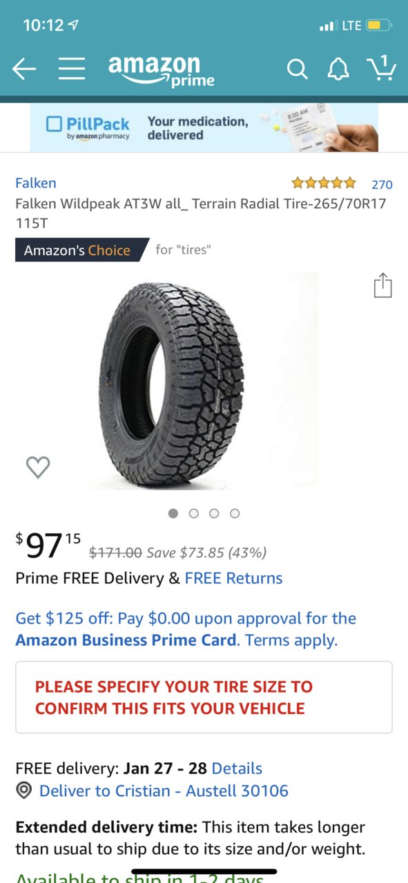

    Looking to get new tires for my truck and I stumbled on a deal. I hope it’s a steal lmk what y’all think.

    Seems legit, pull the trigger

    I’m not familiar with tires so what does a speed rating of “T” mean?

    I literally just bought from that Amazon deal about 2-3 weeks ago, but at the time it was only discounted $52 bucks on each tire! I wish I could have gotten it at this price lol. They've been fantastic so far!
    They are slightly louder than the stock tires and I have only lost about 1.5 mpg since installing them.

    would be nice to have in E rating but the wildpeaks are a popping ass tire. They are legit if u like them and want them
    Mine have done great and showing no wear at 13k miles so far. But I'm in E load rating (no idea if that affects anything)

    A "T" speed rating recommends not going over 118 MPH on these tires. This shouldn't be a problem, you wouldn't have gotten a Tacoma if you were trying to go fast :bikewheelie:

    Yesterday they were 113 and I woke up today and they were 97. So I decided to pull the trigger

    Wow... 97... great deal on an Off Road tire..
    at least half price of the KO2 BfGoodrich :thumbsup:

    Just like lift kits that are half the price (or less) than other lifts, there's generally a good reason they are that much cheaper.
    One reason they are cheap is that's a C rated tire, vs. the E rated BFGs. Falken is also generally considered a "budget" tire brand, vs. the "performance" BFGs.
    If you're going for an off-road specific tire, skip the thin wall C rated road tires, and get yourself some E's. Thicker side walls are more durable, handle low pressure better, and are less prone to fold over on side hills.
