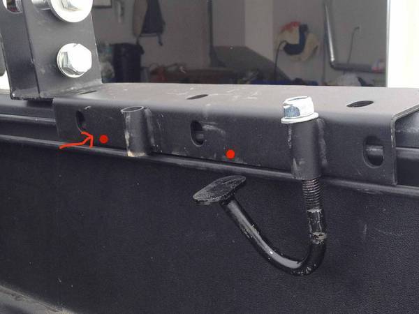

    I can't confirm how well it fastens to the bed at the moment :eek:, I had it set on the truck to check fitment but took it off to give me time to figure out how to mount it securely to the bed. In the picture you can see how they intend for you to mount, but with our bed rails it is kind of sketchy so I am trying to find the best way. I'm sure with enough thinking and trial and error I will find something that works better and will update this post once I do. At worst case I will drill holes on the bed rail but I am determined to find a way that I don't have to do that.

    And this is their intended method to fasten it, The J-hook goes under the rail and tightens down, would work better in other applications but I am not confident with it on our bed rails. One idea I had was to bend it in more, cut the flat part off the J-hook and then dril a hole up through the bed rail for the Hook to sit in. *Forgot to mention, there is 2 j-hooks for each bracket, you can see the sleeve for the second one in the picture, I took this bracket off the rack so I could test mounting methods without putting the rack on the truck every time.
    If anyone has other suggestions for mounting I'd love to hear them!

    Drill some holes through the feet , centred on the bedrail and use some T nuts in the slots to fasten them .

    like this? and the t-nut goes inside the track?
    if this is the case, will there be enough steel still there if i drill lower than where the holes are?

    Yes , like that .
    The T-nut goes in the track , from your pics you may need to weld a plate on the face to increase the amount of metal on the foot to accept the bolt .
