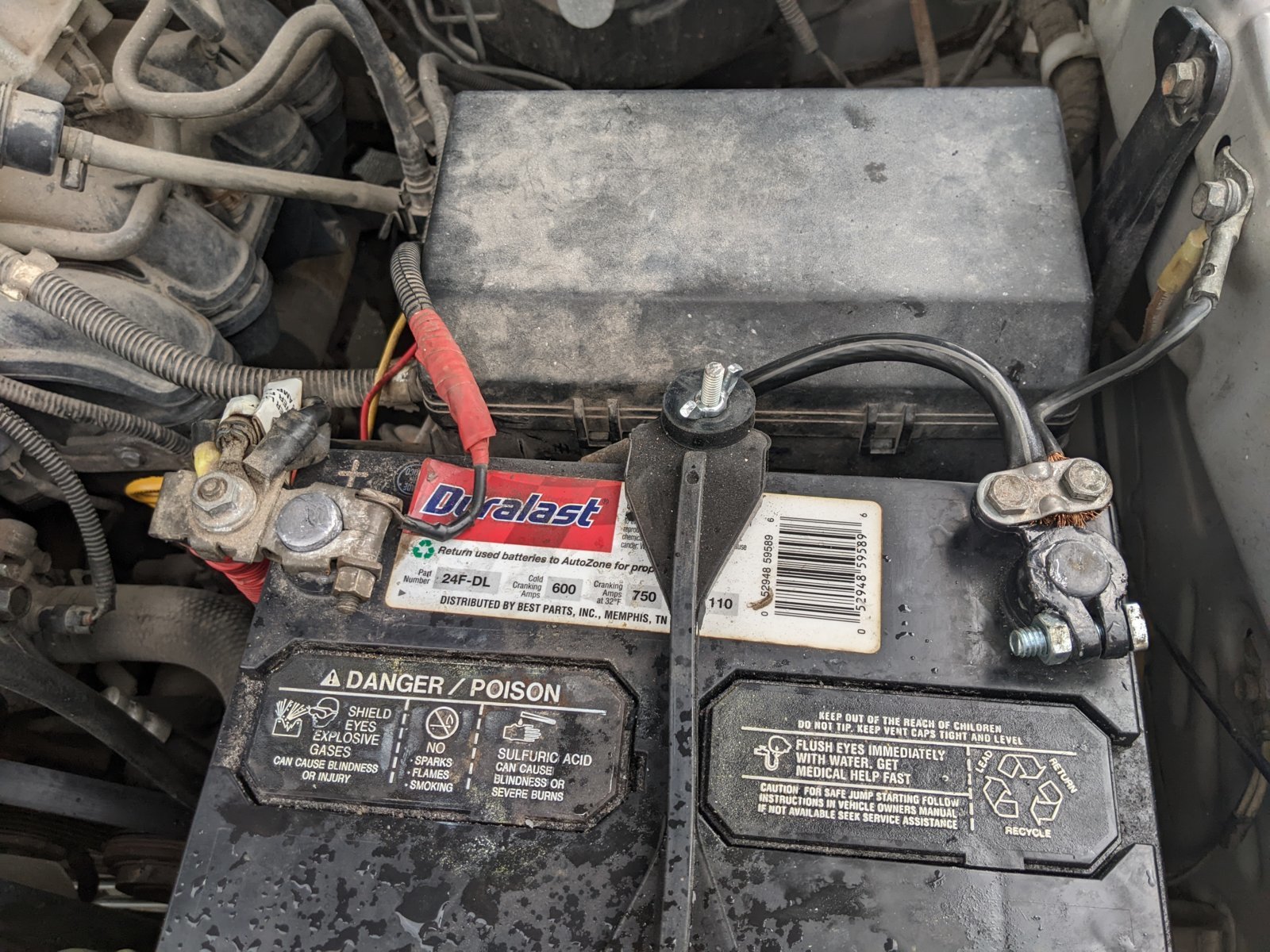

    A bad alternator won't cause a no crank.
    It's a main power or ground losing connection, we need a test light or meter to see where we're losing power.
    Do you have a picture of your battery cables?

    President McKinley w/KLM 203P and threw the roof antenna, ICON RXT leaf spring packs (position 2), Bilsteen 5100s, ARE Camper Shell, Pop & Lock tail gate, Dash Cam
    Cables are snug and clean

    I bet it's this mess right here, those things can look good but they are terrible about losing connection.

    I see extra wires and a "less than desirable" Negative terminal for the battery.
    What extras do you have installed on the truck?

    How old is that battery? Looks grungy.

    The extras you see are for a trailer harness, an HF radio, and for an HF HPA. All three have independent fuses less than six inches from the battery terminal.
    When this started happening I immediately removed all three inline fuses to try and rule those out. The issue still persists.
