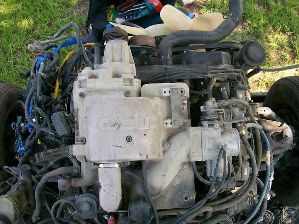

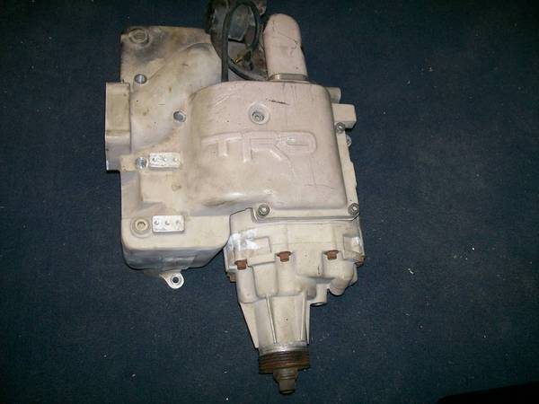

    Got a new "toy" project I will be adding to the '98. Over the next few weeks I'll be adding a 1st gen TRD supercharger. Picked up a '97 3.4L motor (out of a 5 lug truck), complete still sitting in the frame rails, all accesories, wiring, ecu ect. along with a 5sp tranny, and the supercharger for a screaming deal. I plan on documenting the tear down and rebuild of the SC and install of how it all goes.
    Got my parts from www.rollingperformance.com for the S/C rebuild and belt and check valve from Toyota.
    Here are some pics to start off with:

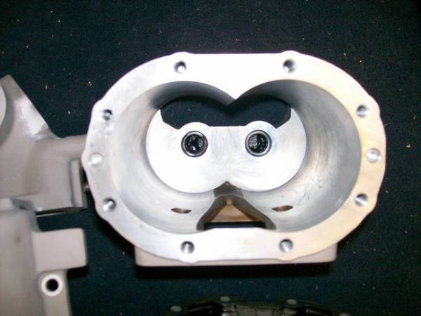

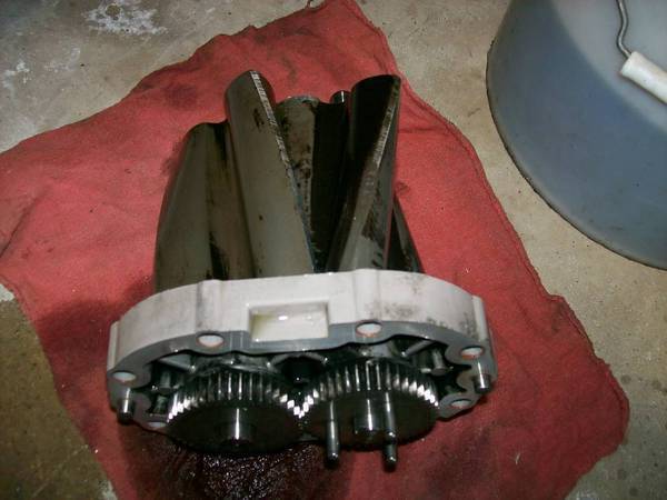

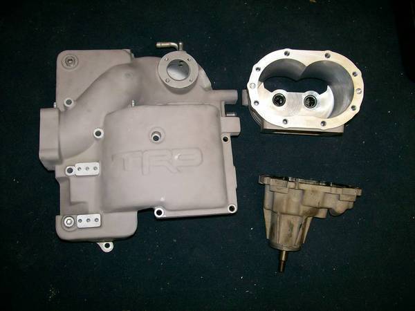

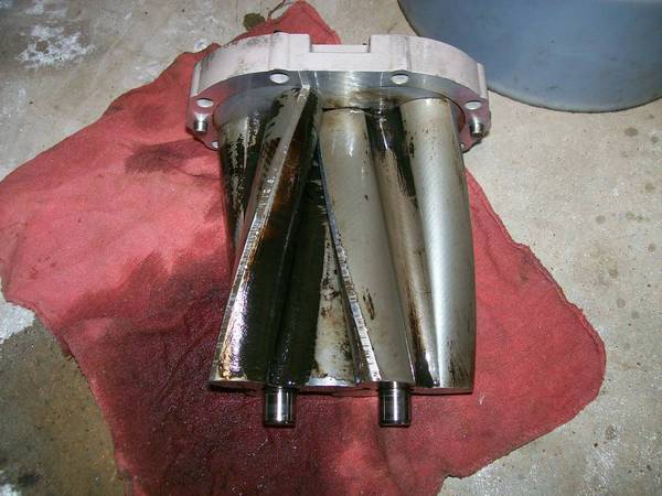

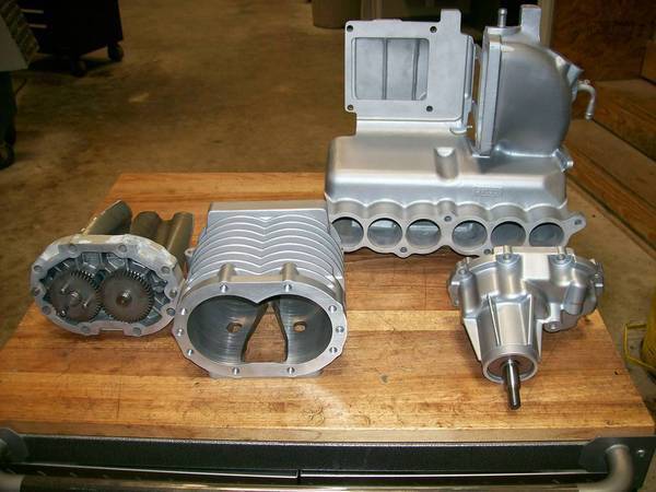

    Started taking the SC apart.
    Front nose nut came off easy, pulled the pully off, unbolted the nose and it came off easily. Oil inside was nasty smelling, but no metal or wear inside.
    Rotor casing was a little pain to get apart but got it.
    Rotors/casing had a little scaring, smoothed the casing with a little sand paper and gonna leave the rotors alone other than clean those up.
    Bead blasted the intake housing inside and out, blasted the outside of the rotor housing, and cleaned other items.
    Not sure about the taking apart the two main shafts the rotors and gears are on, need to do a little more research on those. I might just leave those alone.

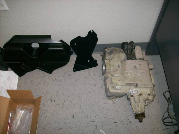

    Next is to re-paint everything. I'm waitng on the bearing/seal kit buit that gives me time to get everything else ready.
    Here are a few disassembled pics:

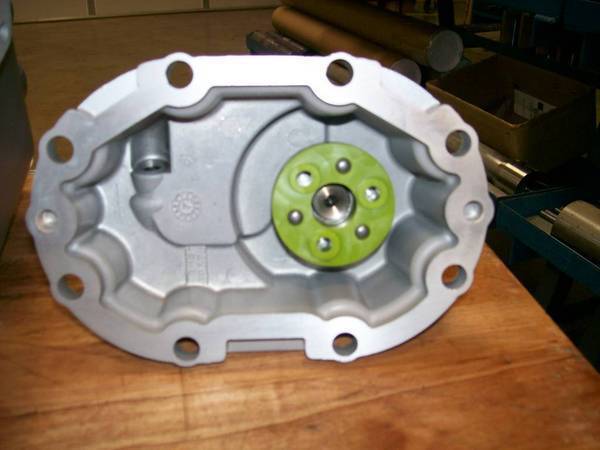

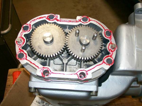

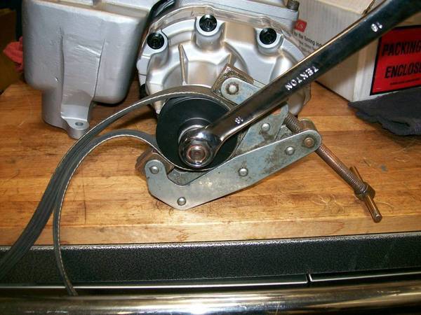

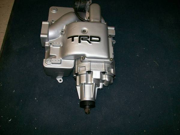

    Got the bearings in and install went smooth. Again, a press makes rebuilding much easier.
    here are the components ready for assembly:
    new coupler installed, the old one had a lot of slop compared to the new one and really tightened things up.
    Sealed everything up with gasket maker:
    An easy way to loosen/tighten the pully nut:
    And the finished assembly painted and ready to install. I'll probably put it on Saturday and post on how that goes:
