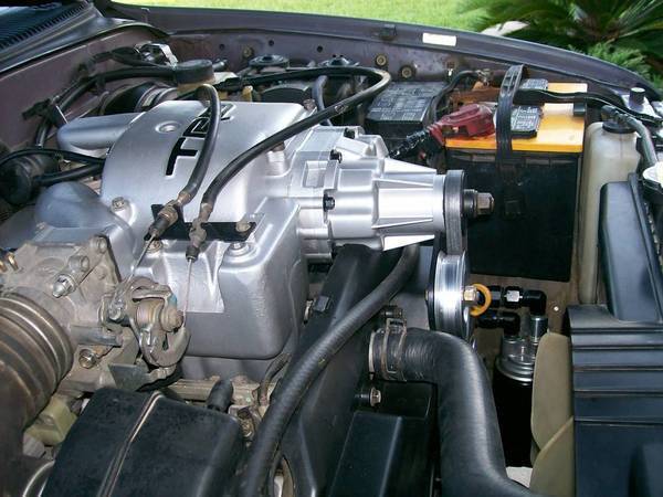

    Supercharger update: I installed the supercharger Saturday, had a few issues, hooked everything up and it fired up and ran first try, no problems until I noticed the belt had jumped a rib off on the S/C pully. After studying the situation I am making custom pulleys for the idlers to hopefully correct the belt from moving. I have read that the Gen 1 SC had issues with the pulleys/belt and hence the change to the dynamic tensioner. I would go that route but I want to see if I can make what I have work, besides that, the dynamic tensioner is around $200.

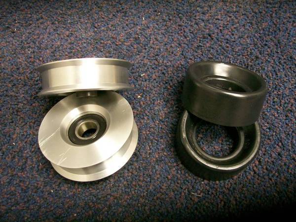

    Yea, wish I knew a machinist that could make them!

    Got the pulleys made, gonna try them out this evening. Hopefully tomorrow I can give details on how the S/C helped..
    Old vs new:

    LOL, I ended up using the old rock and stick combo rather than the drill/file combo!:D I'm old school you know.

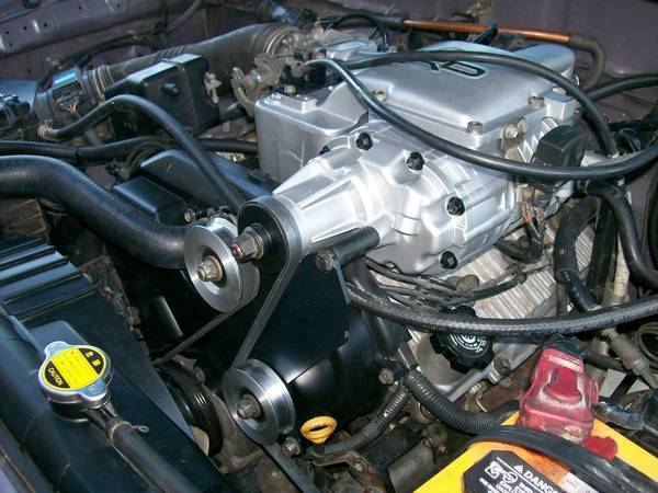

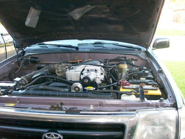

    The pulleys worked out!
    Got everything finished up last night and so far the S/C has been very impressive. Definately uped the power from stock, off idle acceleration is excellent, mid throttle is not as noticable but has more power than stock, and high RPM it once again is impressive. I have only driven around 10 miles so far, need a little more seat time to find the sweet spot for its power. Has a cool wine under power, slight rattle at idle, but all was expected reading other posts about the S/C.
    For anyone looking into putting a S/C on, rather the gen 1 or later S/C, install is really easy. Making sure the vacuum hoses are correct and getting the check valve installed correctly in the IAC line are the only areas that a mistake could occure IMO.
    Part #s for the checkvalve and belt from Toyota:
    Checkvalve -- PTR2635042
    S/C Belt -- PTR3035040
    Pics of the final install with the new pulleys on: and yes the paint looks purple :)
