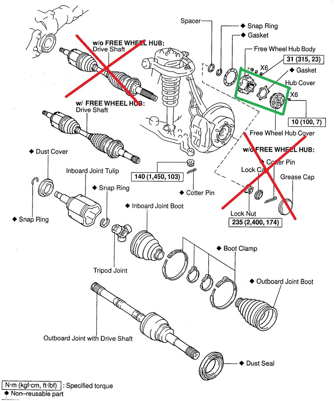

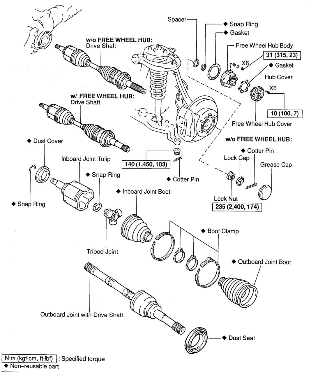

    Here's a nice schematic -

    Again, axles for ADD and manual hub are different and not interchangeable however, the boot kit to rebuild them is the same.

    Spindle and Knuckle are colloquially used. The knuckle is what your wheel mounts to.
