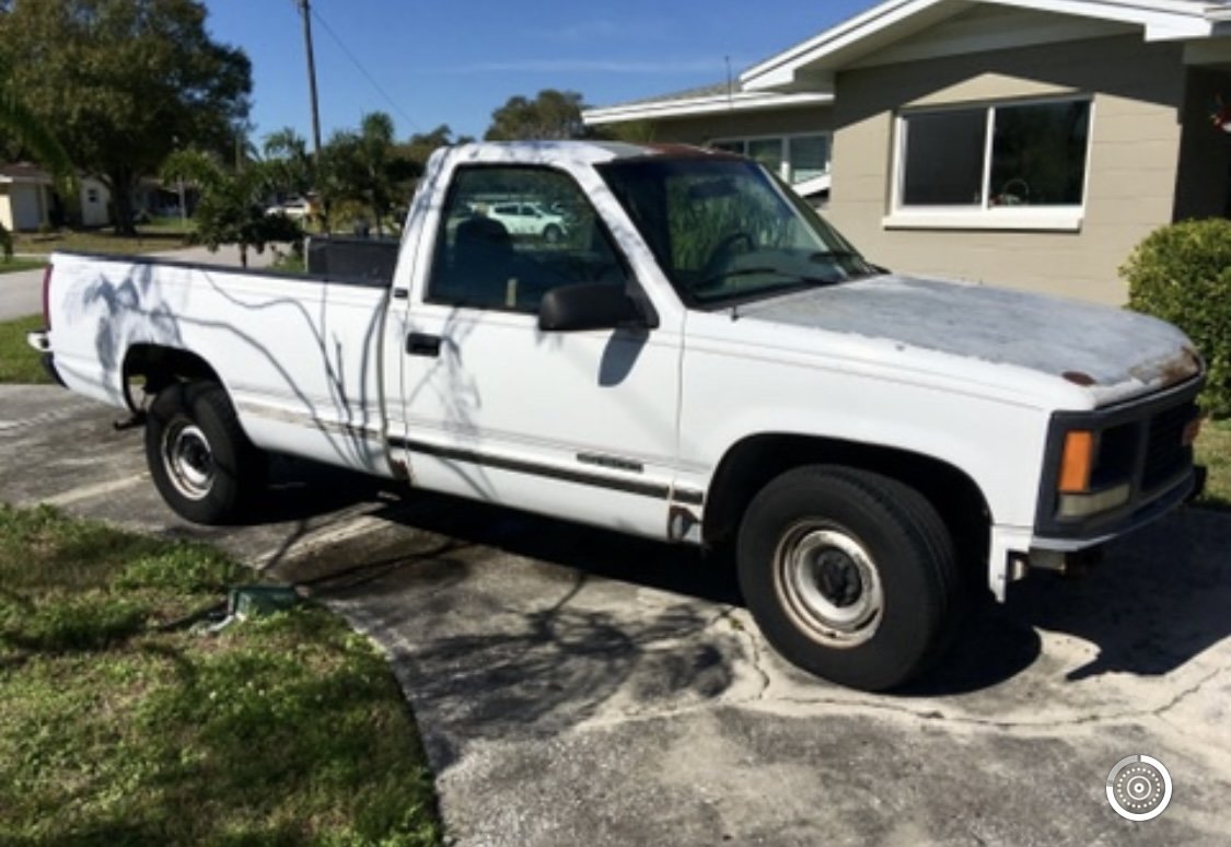

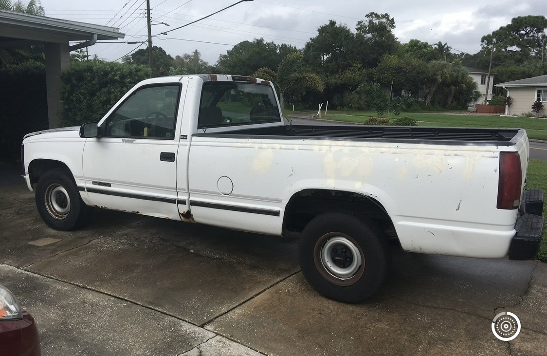

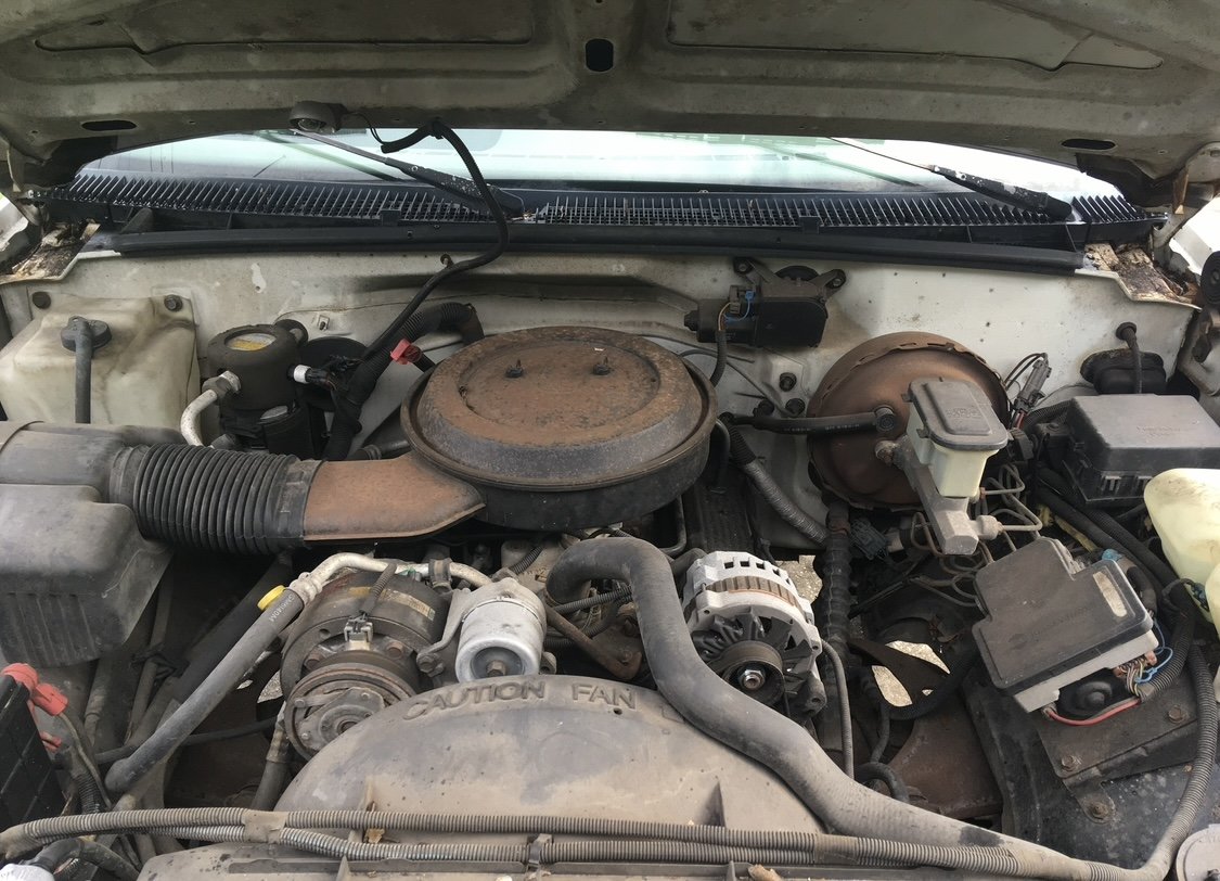

    I bought an old work truck off a church that was just going to scrap it for $200C746042E-D1AC-4CEE-A075-176E077B050D.jpg D2A72E28-C356-41F3-B718-ACCA300D4EF0.jpg 5F177AC0-5316-4A74-846D-383122F22BFF.jpg B718BBAE-B329-4978-A408-2C86CFBBC41C.jpg . It was a rusted out piece of junk but it ran like a raped ape! It was a mid 90s GMC SIERRA with a v8. A real hunk of junk. You could see the road underneath your feet. No AC, headlights didn’t work seats were F’d up. But it also drove like a Lincoln on a cloud. Used it here and there for about a year and sold it for $1500 without putting a dime into it

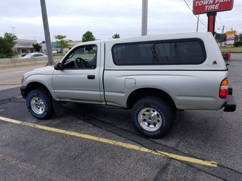

    My current Taco is rusty and was when I bought it. I promised myself and my wife that will absolutely never do that again. So much time and money just to have something still rusty and not how I want it. I will never try to save a few bucks with a less than ideal vehicle
