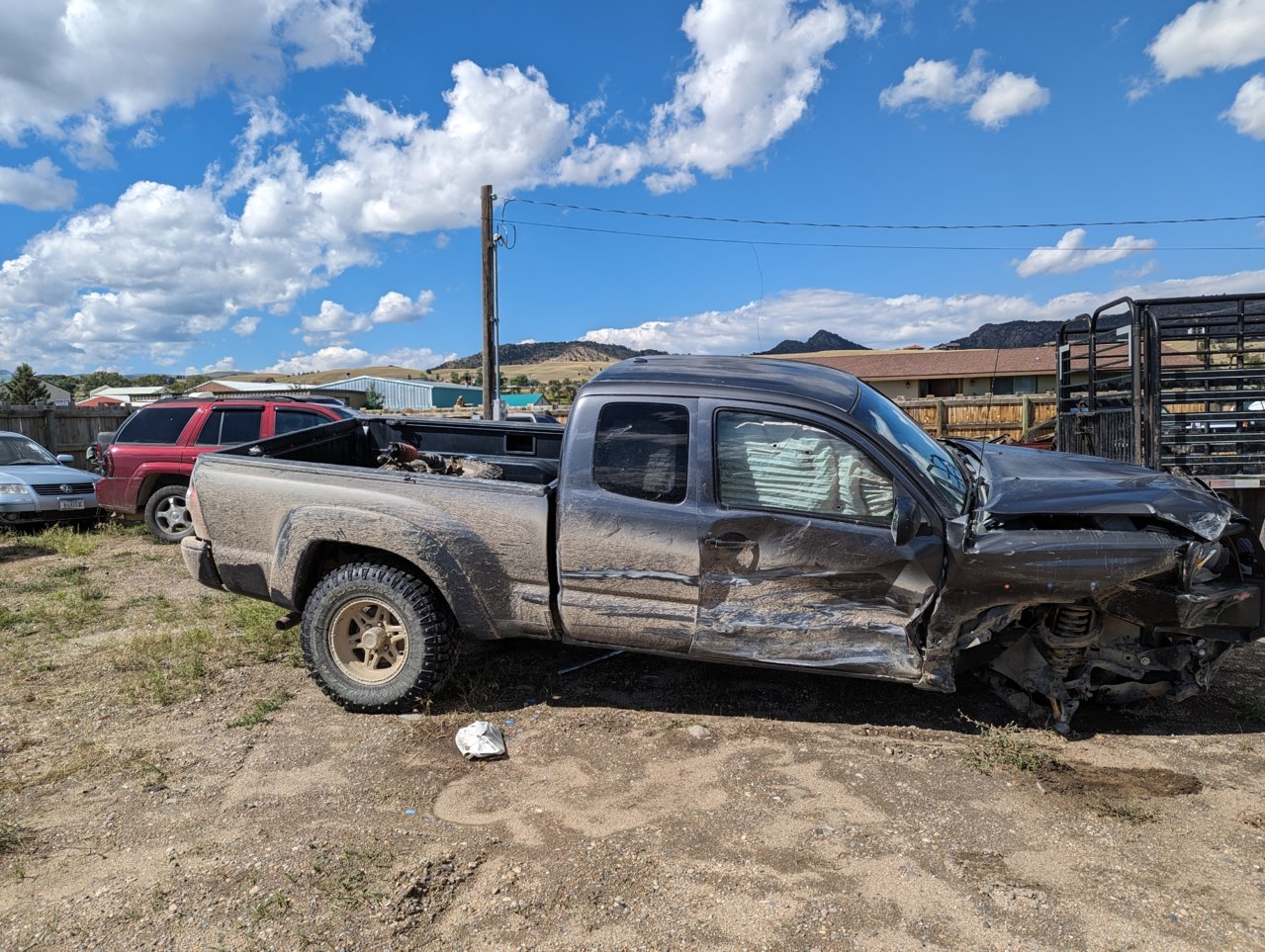

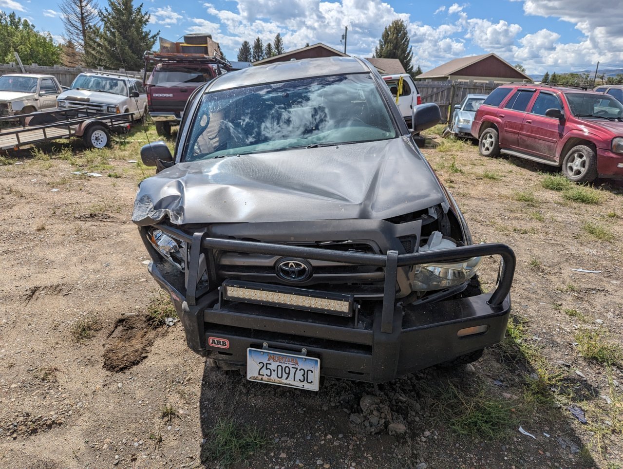

  12. Oct 2, 2023 at 3:27 PM
    #32
    Rabby
    Rabby [OP] Well-Known Member
    Jul 18, 2012
    #82937
    104
    2010 Tacoma 4x4
    OME Hvy Kit, ARB Bumper
    When that kid shwacked me with the back ass of his truck... Front crumple zone, check. Airbags deployed, check. Nothing wrong with sticking to something that probably saved my ass
