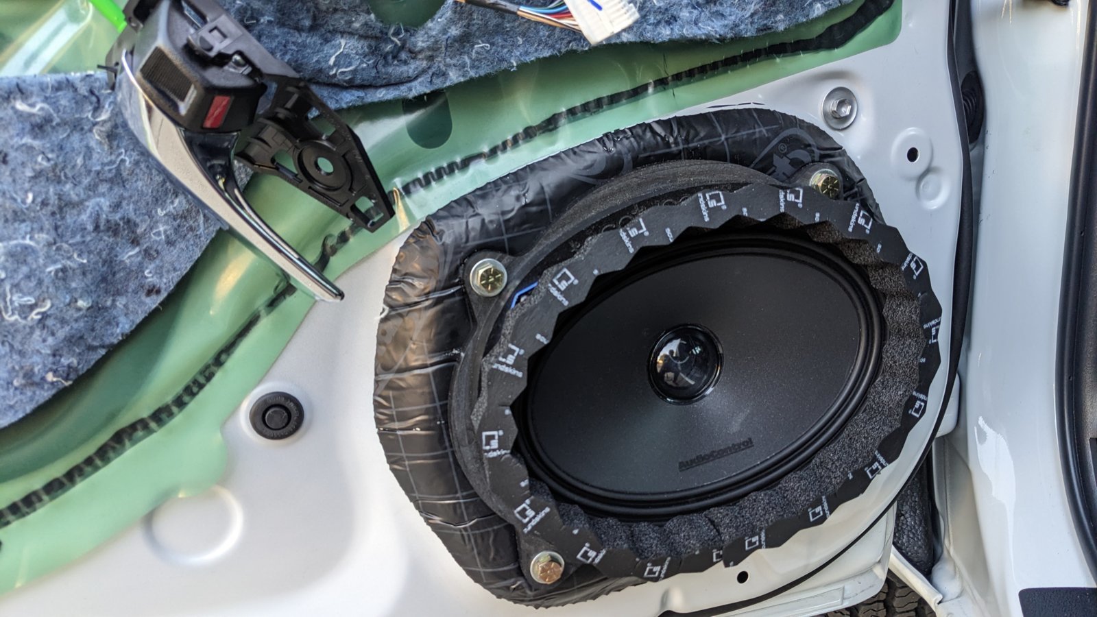

    If, by baffle, you mean the speaker-to-interior door panel baffle, then it will make a noticeable difference in cabin noise. I have Dynamat around the speaker opening but also 2 long strips on the outer door skin. One above and one below the side impact tube. This minimal amount of sound deadening helped a little but not much. I was going to Dynamat the whole interior skin but added these foam rings and they made a noticeable difference. I did it to direct the sound into the cab but a lot of noise comes in through the gap between the speaker and the inner panel grill. These baffles sealed it off. Now I’m no longer doing the whole door.

    What kind of foam baffle is that and where did you get it? My door panel rattles inside with the speaker bass and the extra soundproofing I tried doesn’t help.

    https://www.amazon.com/dp/B07W86QZWV?ref=ppx_yo2ov_dt_b_product_details
    It’s Soundskins. They’re a little pricey but easy to apply. They’re thick and soft enough not to buzz. You can also use foam gasket tape found at hardware stores.
    I also removed the green OEM plastic threaded inserts and used sturdy nuts and bolt to secure the speaker to the door. That might be what’s causing your rattling. The Dynamat around the speaker hole also helps create a nice seal against the speaker adapters.
