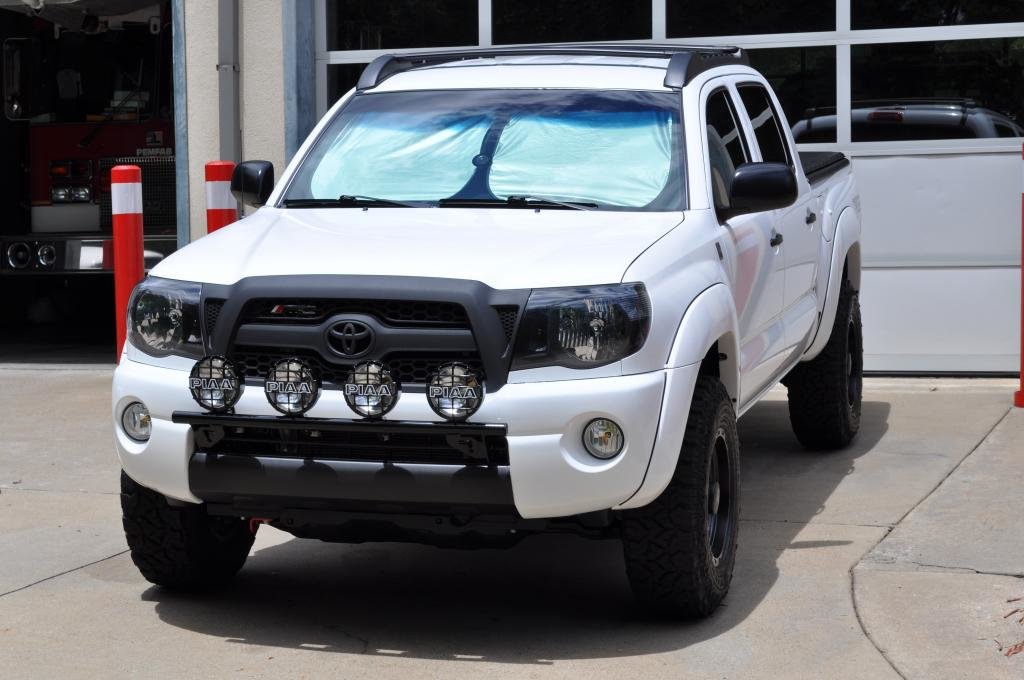

    Dude that came out nice! Looks especially good with your blacked out grill. Is that a TRD emblem you were able to get in there? Have wanted to do mine but am leery of the whole oven baking and making sure I don't mess up my lights.....

    Thanks. Yeah I got the TRD Emblem off Amazon.
    As far as the BHLM goes it is intimidating no doubt if you have never done it before. The first time I did it I was a nervous wreck. After you figure out the process it really isn't that hard. The hardest part is removing the lens from the housing (well that and the "idea" of actually putting them in the oven lol).
    Set it to 300*. I put my light on a large cookie sheet covered with a cotton towel then put it in the oven. Turn off the oven and let it sit in there for 10 mins. Pull it out when the timer goes off and use a flat blade screwdriver to start at the corner and pry off the lens. Once you get it part of the way up you just pull them apart. You should have about a min to do this which is plenty of time. Once that is done it is easy from there. Just make sure you seal it back up good and you should have no leaks.
    There are a couple of good write ups on here. I don't know about the 12-13 yr models but the 11 was easy.
