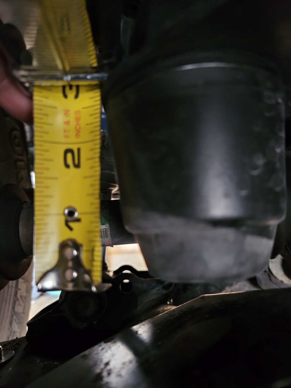

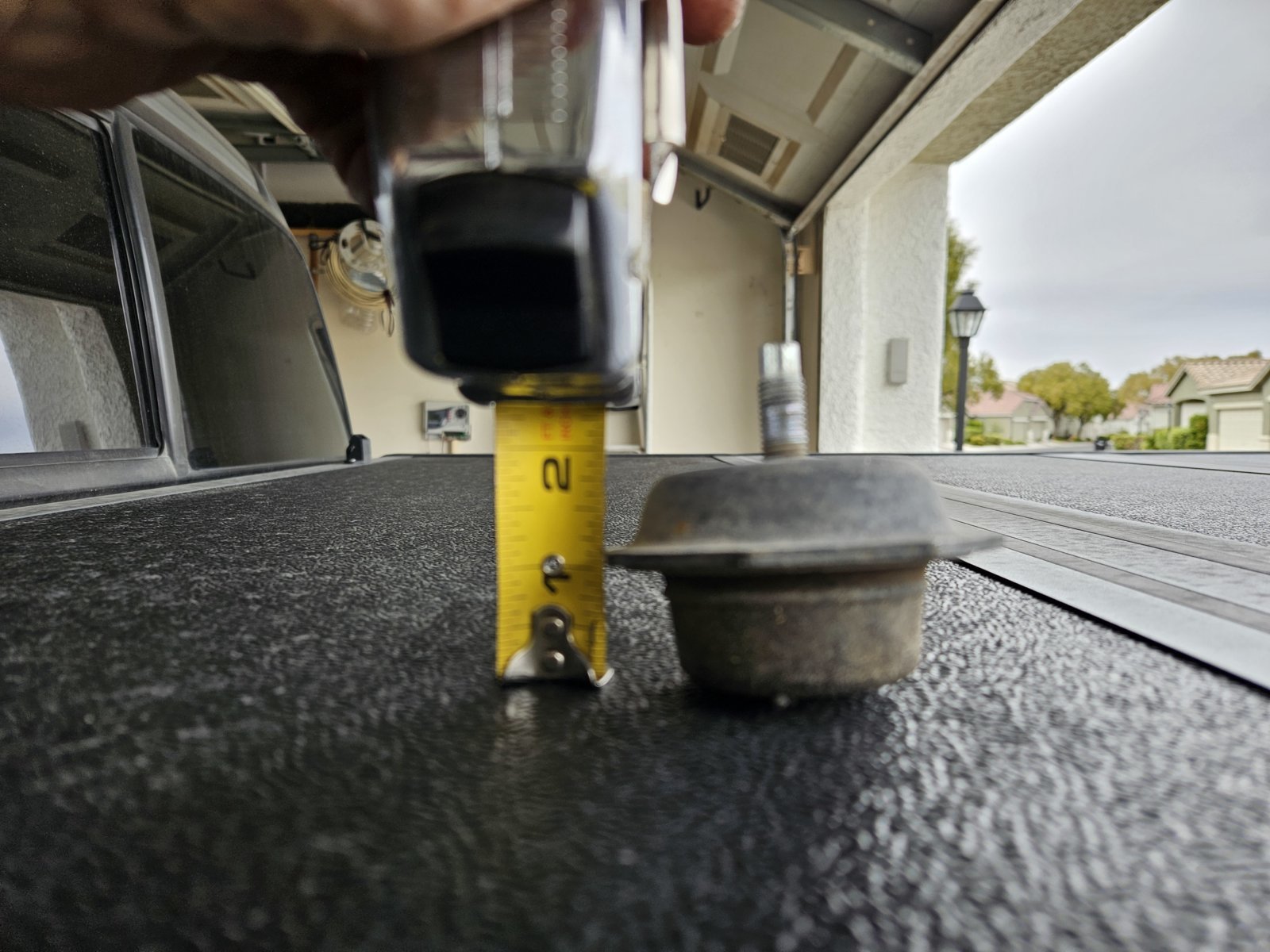

    I have Durobump fronts and mine compressed an inch yesterday. They are a hell of a cushion versus near dead stop stock bumps. 1.87" reported stock length and 2.5" Durobumps. 20240310_153746.jpg20240310_154009.jpg

    Cool. On lightweight rears, bump space is everything-there is no engine weight to compress the bump stop top.
