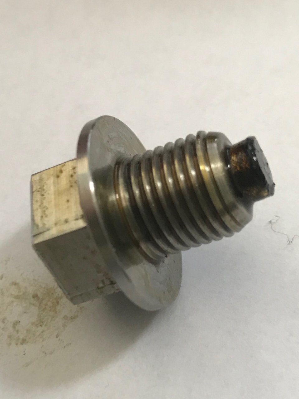

    i do mine warm (like about 5 minutes of idling). After i pull the drain plug I go away for sometimes about an hour.
    I like the 5L jugs of pennzoil platinum since its just the exact amount needed.Just pour it all in and its right on the full line.
    I do have a gold plug drain plug.. after 5000 miles there is a very thin film on the magnet..
    i just did a change this afternoon so snapped a pic
