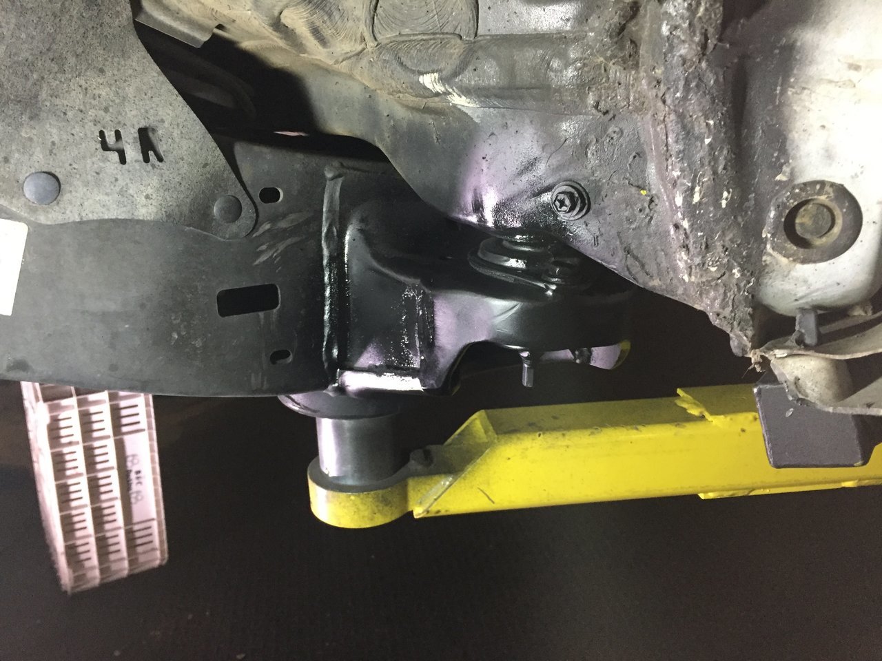

  19. Nov 22, 2017 at 9:05 AM
    #19
    TacoZim
    TacoZim Well-Known Member
    Feb 20, 2017
    #211176
    971
    Bay Area, CA
    2008 DCLB
    Seems like every other week I'm taking the dremel to cut some more. Shit is never ending. Here's a picture of my CMC OP. Needed to chop quite a bit.
    285/70/17
    4.3BS + 1.25" spacers
    3" lift
    2k4Taco[OP] likes this.
