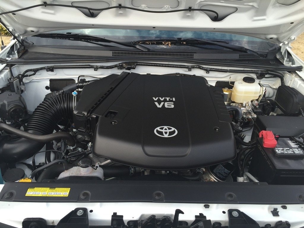

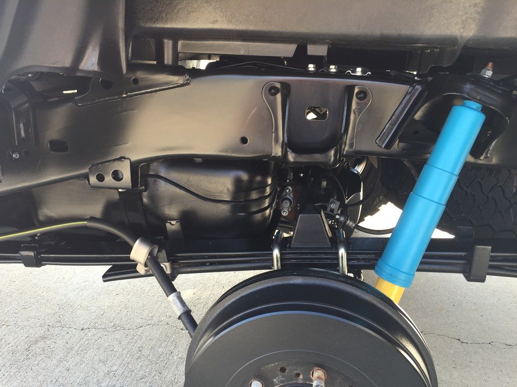

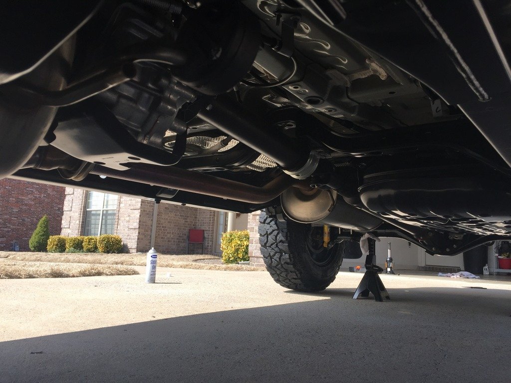

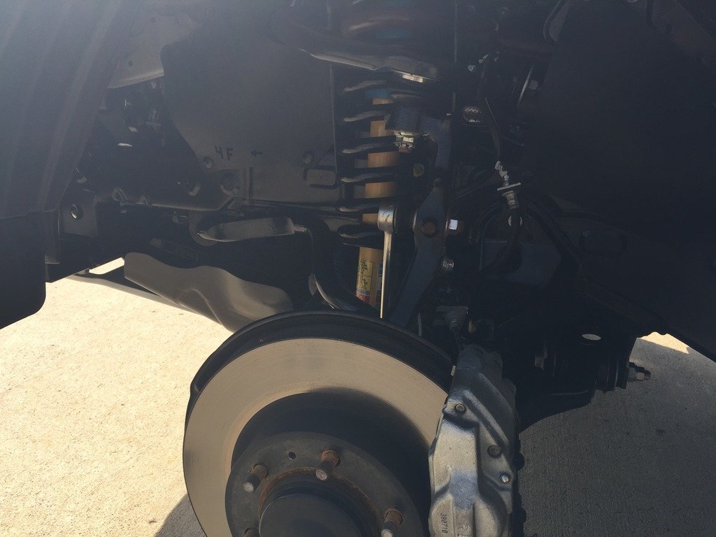

    Like others have said on here. If done properly (IE using the lube that comes with the kit) you will not scratch the paint. Wash the truck very well. Dry, spray lube (included in the kit), Knead the clay bar often, and use the clay all over the truck. IIRC there should be two bars in you're kit. I recommend doing all this in the shade as you don't want the lube to dry before you hit it with the clay bar. After the truck is done I usually use a damp microfiber cloth to remove most of the lube left over (not really necessary but I do it anyway). Then wax you're truck as usual. You will not believe the difference it makes in the paint. You will not be sorry you did it since it removes all the contaminates from the paint that you didn't even know were there.
    HIGHLY RECOMMENDED!
    To give you a idea of how OCD I am with my truck
    I take it off road all the time believe it or not.
