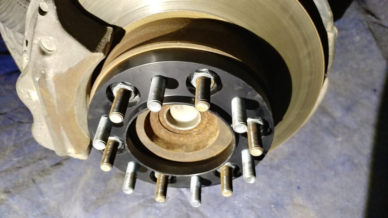

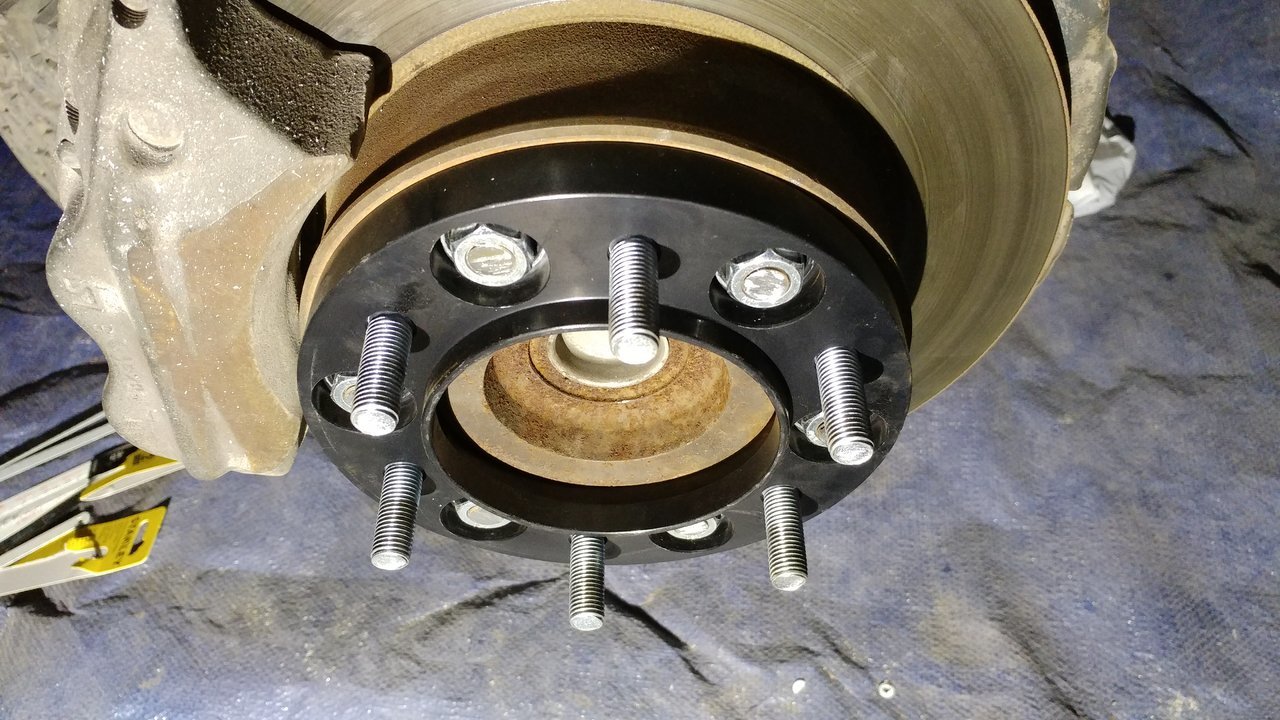

    Before and after. Hacksaw worked great and nice clean cuts. Filed down the ends a lil bit to debur and done.
    And I failed to look it up yet but anyone know what to torque the spacers to?

    Looks good - 90 ft-lbs (same as wheel lugs) with some blue loctite will do the trick.

    thanks mate. I did read about that and suppose I should use some loctite.
    Tundra kit arrives tomorrow. Then we'll see if they clear these used 16's I got. If not then they're getting sent back and will just stick with new oem stuff... At least my wheels should fit better either way since the 1/4" spacers are gone now. At least I'm hoping so and it eliminates my vibes. Eventually when I can afford it, I'll look into getting some shiny new hub centric wheels. Although I think these will fit pretty darn good. There's a slim gap between the hubs and wheels, but with the metal center caps, it's a tight fit against the bore. Not sure if that helps or not. But I guess we'll see tomorrow when I get the wheels back on and see if the vibes go away. Then to find tires for those 16's if they clear. yay.

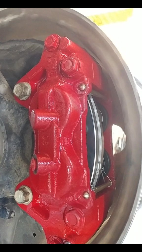

    Just a little bonus update. Tundras clear!! Barely. Ha. And room to spare with the backspacing with the 3/4" spacer. Without it, it grinds the caliper.
    Thanks for the help guys.
