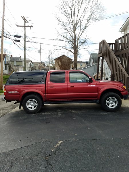

    So I recently purchased a cap for my 4 door, found it used for a good price, and I don't think it looks half bad being black with the impulse red color. I was thinking about plasti-dipping my rims black as well since they have quite a bit of corrosion on them. What do you guys think? I haven't been able to find good pictures of the stock rims dipped, so if any of you have pictures feel free to post them here and comment with opinions. 20170407_161714.jpg

    Why not paint them?

    I wasn't sure how they would look. Dunno if people paint the center caps as well

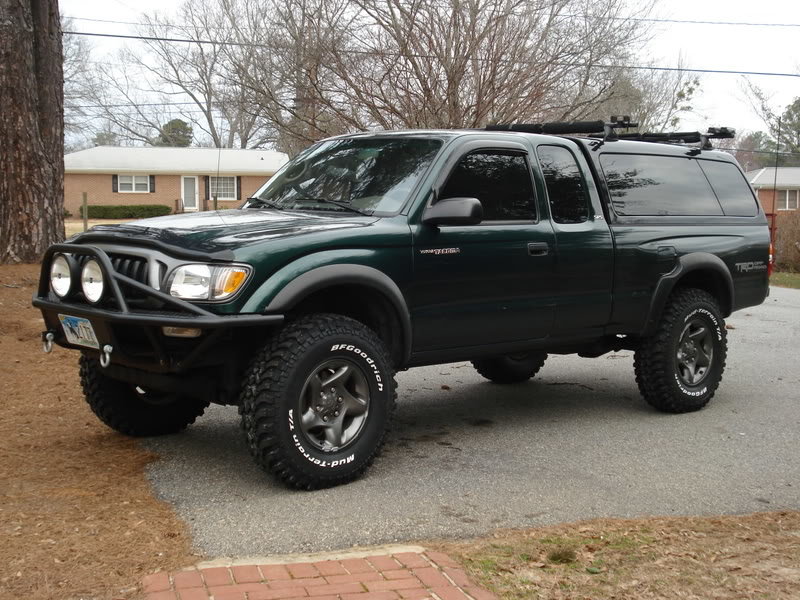

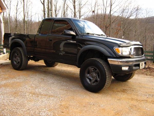

    Here are some examples off google images. :notsure:

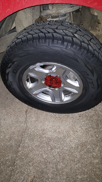

    I've used plasti-dip and it looks ok for about a month then it starts peeling and fading. I used the spray on and I'm no expert at painting so it could be how I applied it. I did try Hydro dipping and so far seems to be holding up for my center cap.

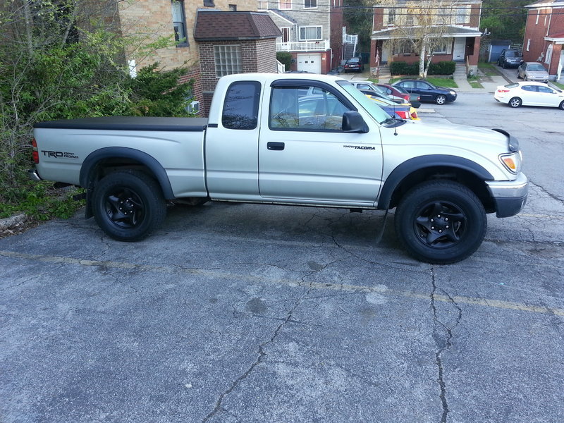

    this was after a couple months. I had about 4-5 total coats on them (1st light, 2-3 medium, and 1 medium/heavy). never had an issue even going through car washes with the wheel scrubbers.
    trick is to get it in the nooks and crannies and on the outside of the rim/bead area so it curls around and sticks. don't worry about over-spray on the tires, it literally works itself off and leaves a clean line

    You didn't apply it thick enough. And I don't mean "all in one coat" thick, more multiple passes.
    My truck has been dipped for 2 years now. Go look at my build thread.

    Those pics of the painted wheel trucks look great. I would just bite the bullet and powdercoat.

    the first pic is on TW under another post for painting rims. he sanded them down a bit them primer/paint. I like the charcoal look myself.

    Do you know who the member is? I agree, it looks pretty good.
