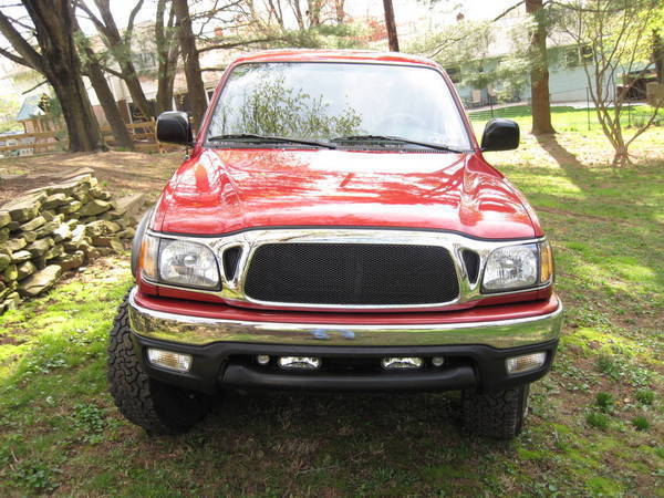

    I have a set of Hella fogs and drving lights, they fit damn near perfect. They weren't exactly cheap, but you can find deals on Ebay.

    Good combo, and good placement! :thumbsup:

    Thanks, they work really well. A bit of a struggle to get installed, but well worth it. The only real problem is that in PA, lights have to be a certain distance apart for inspection and mine are too close. So, I have to either remove them for inspection or use a friendly mechanic.

    I had to pull the lower valance off and mount to the bumper bar behind it. Took some time, but worked well. I used nutserts into the bar and just bolted them down. Go to A Toyota dealership and get fog light switches from a similar year Camry, they pop right into the holes on the console, looks factory.

    Explain please.

    The fine folks at the dealership refused to inspect my truck because the lights had to be 20 inches (I think) apart. They wouldn't even let me disconnect them, they had to be removed. Needless to say that was the last time they inspected my truck. My current mechanic is much more forgiving.
