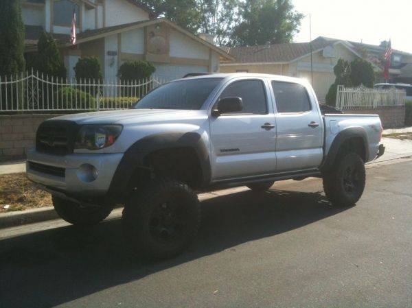

    So this doesnt happen:
    Seems that the 4x4 guys are jealous. This is the most sane way of lifting a truck. If it was possible for you 4x4 guys to use these I bet 75% if not more would. You get 4" of lift without even having to buy a brop-bracket lift or spend tons on coilovers and ucas. Why buy coilovers? uca's? You already have those too dont ya?

    Bro!!! Before I lowered the coilovers.

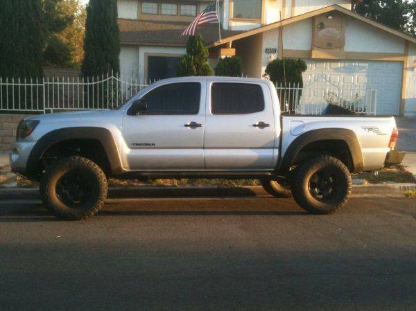

    After:
