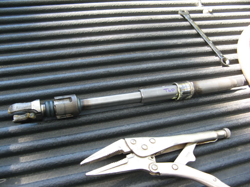

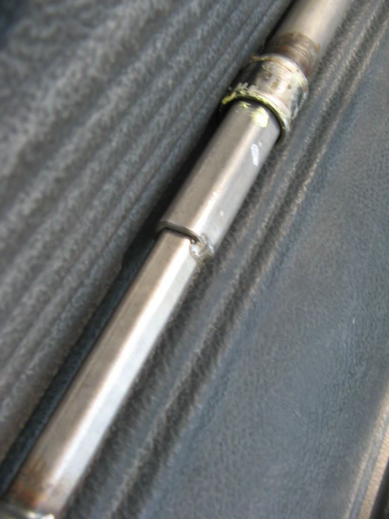

    if second gens are anything like first gens, the play is mostly in the slip joint located on the steering shaft. I tack welded mine which fixed most of the play.

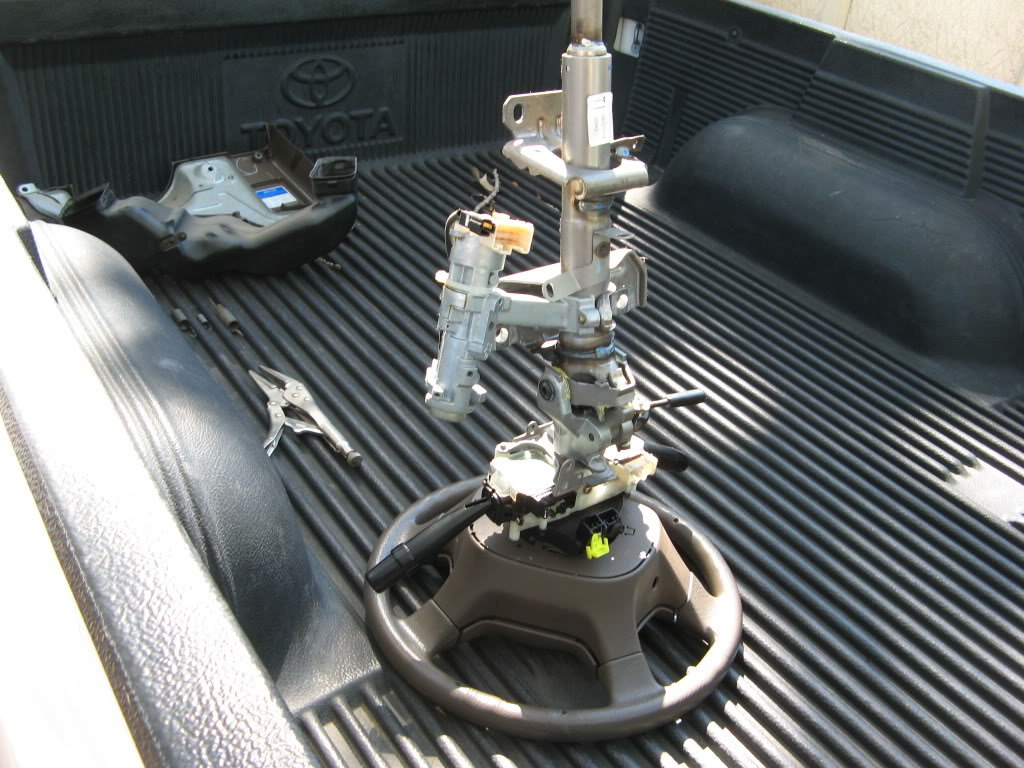

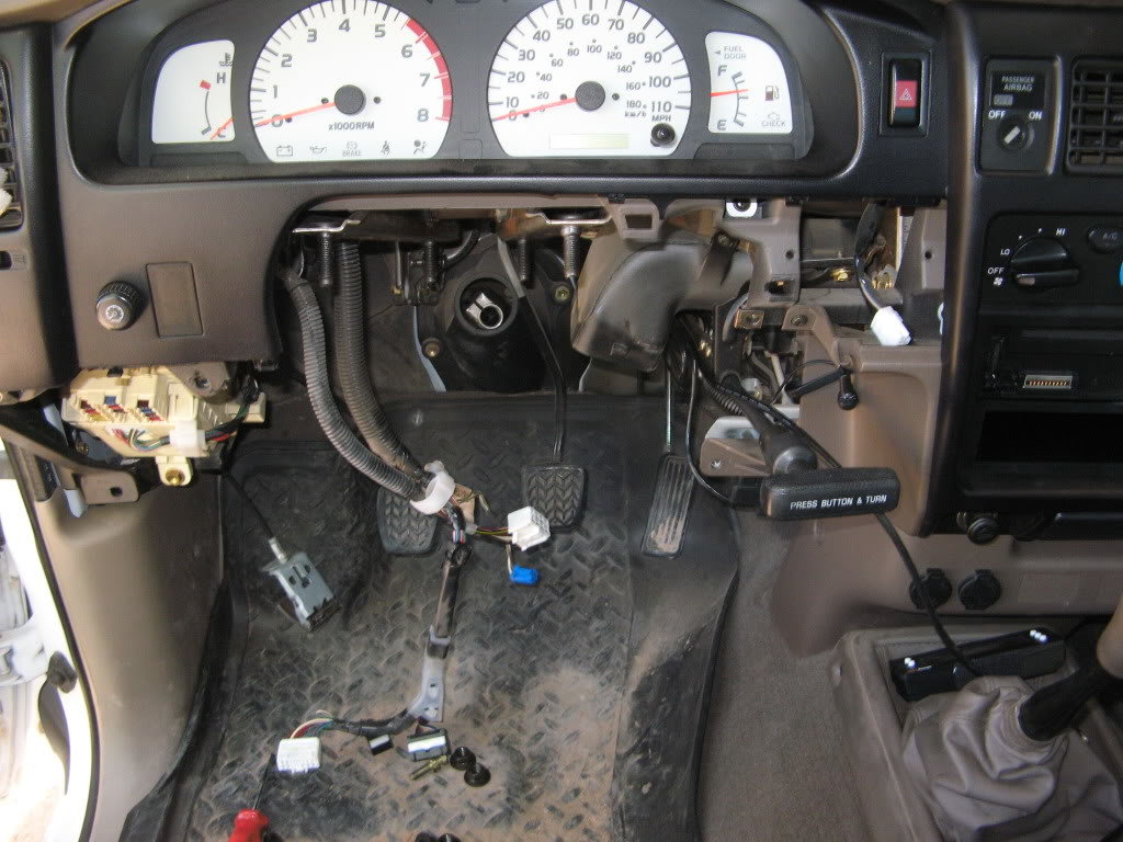

    mine is fucking pissing me off too
    mine is right here
