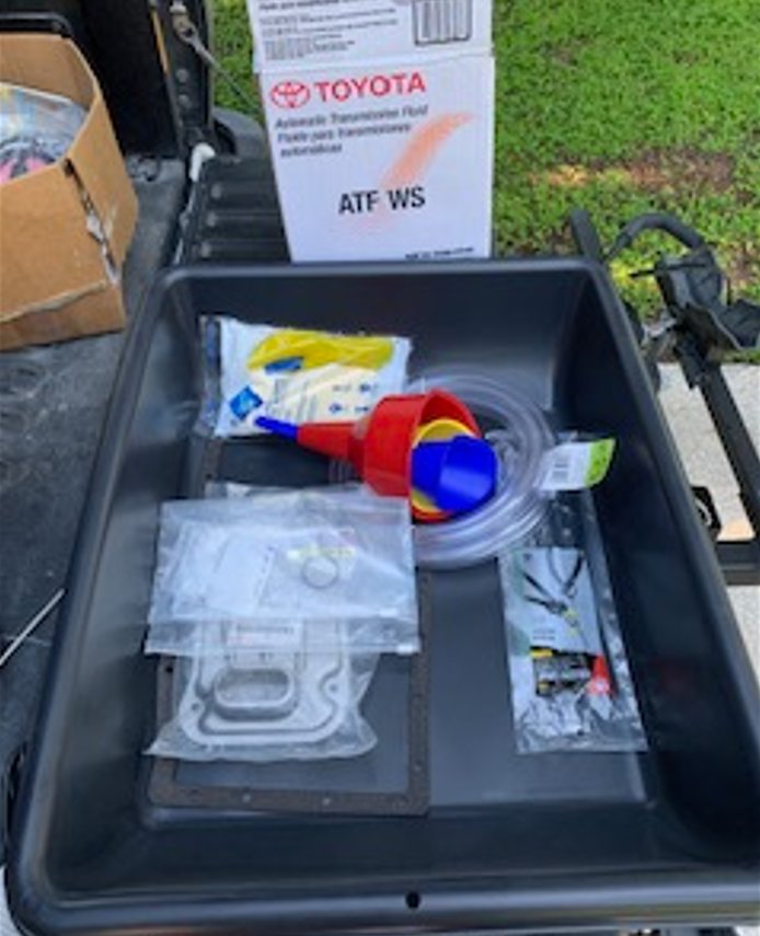

    I stayed with the factory WS since I wasn't having any issues with the tranny. :thumbsup: (my kit)

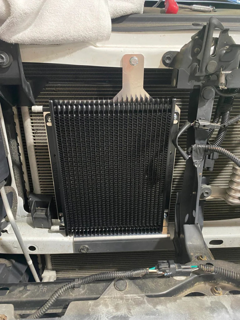

    Installed Hayden aftercooler radiator, midstream of transmission return line.

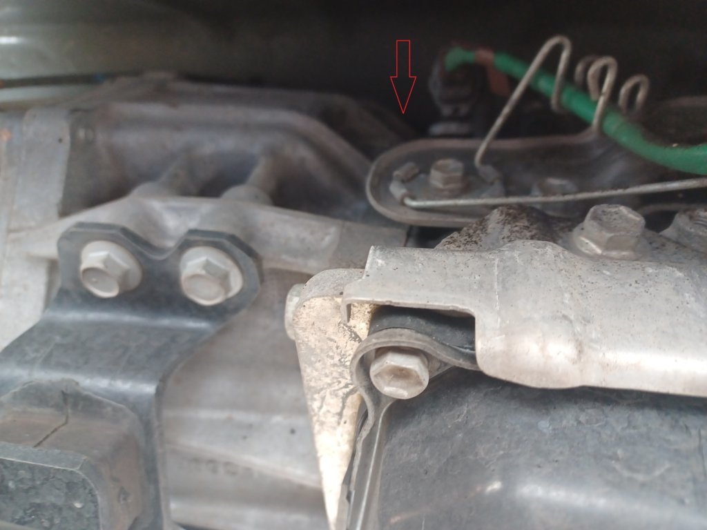

    I had trouble finding the 24mm fill port on 23 sr5. Here it is in photo indirectly on passenger side- arrow points to location not visible to camera looking upwards. Watch the sharp heat shield at cat.
    Also my transmission bottom plate is different from earlier years photos. One hex head drain one Allen head recessed bolt check. No photo.

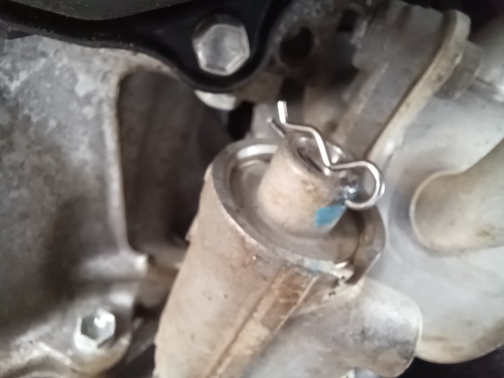

    Pinned the thermostat for summer towing and for drain and fill procedures. Push the head back with a punch and work the pin in with a pliers. I used 1.3mm x 28mm long clevis.

    Loving the Hayden aftercooler on transmission return line.
    Scangauge reads
    194F antifreeze on highway towing.
    169 to 184 transmission 2 temp and cooler on transmission 1 temp.
    4th gear S mode 3200 rpm at 75 mph
    Hill climbs 3rd gear 4500 rpm 65 to 70 mph.
    3200 lb tow, 900 lb truck load.
    Mid appalachia mountains.
