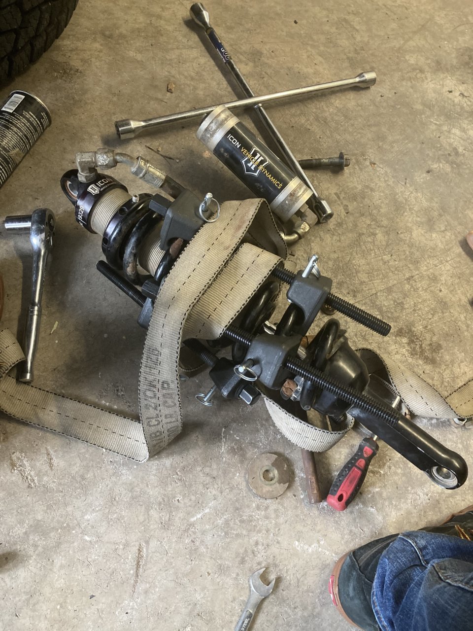

    I’m running ICON 2.5 Stage Shocks Extended Coilover with Remote Reservoirs. I went to go change my passenger side coil and I started to get too sketched out as I was using Oreilys spring compressor that wouldn’t even fit properly. I also think it would be very dangerous if that broken piece on the end suddenly pops off and slides over the bottom coil seat. Should I just take it to a shop and have them do it or should I send the whole shock/strut assembly to icon and have them do it and pay the hefty price? Thought are greatly appreciated.

    Yea...that definitely looks sketchy. I would think an auto shop with a wall mounted compressor would be able to handle that. Probably no need in spending the money to ship it to/from icon, plus whatever they charge.

    If you'd like I can work with you to have a service number created to have the spring changed out at our facility by our shock department. Pay shipping and we'll take care if the labor for you. Shot me an email if your interested.
