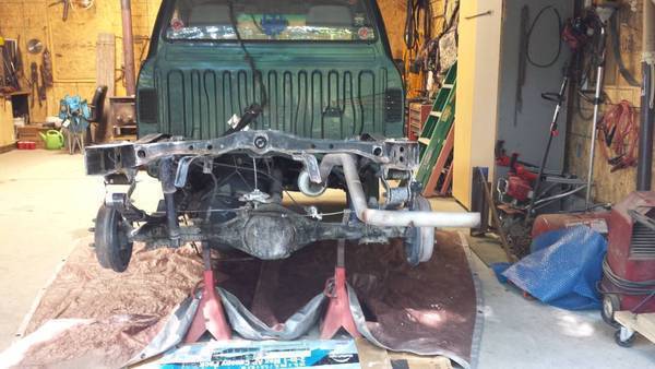

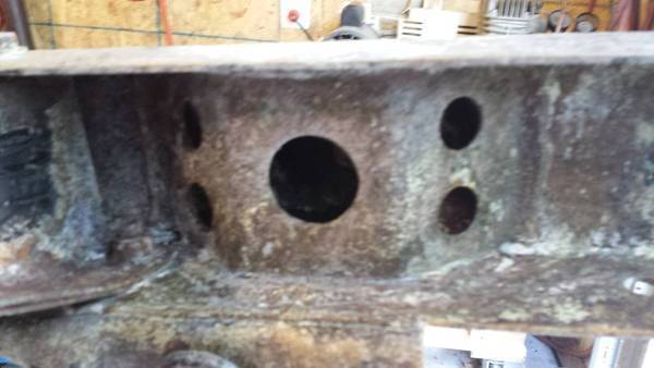

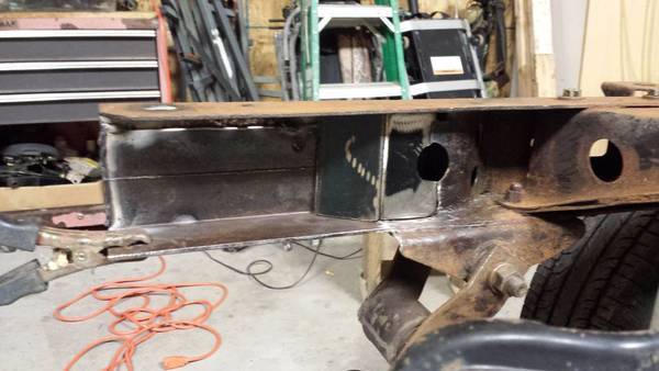

    Pics from yesterday, ready to finish welding
    [​IMG][/url [​IMG]
    3 piece gusset.

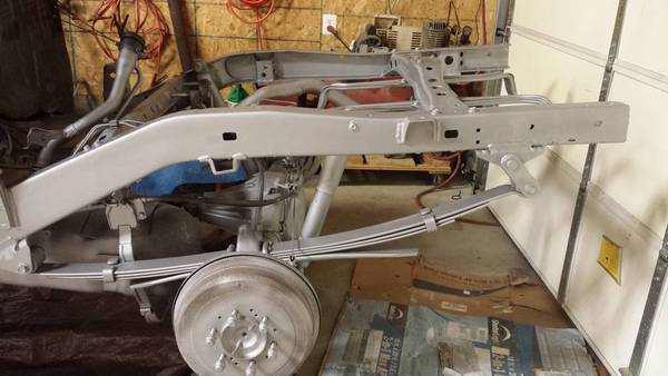

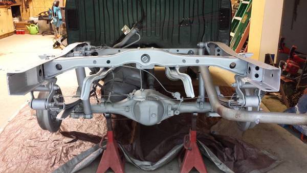

    So I finally got my frame sprayed today. I did 3 coats with an hvlp spray rig. Takes almost 6 hrs with wait between coats. I will top coat with black rustoleum hopefully tommorow. The beds been hanging in a tree for months. Also sprayed bottom of bed in spots. Looking forward to the end of this. Lots of work getting toyota spray off that was failing. Here's some pics.
    Metalblast is an etching cleaner that I used yesterday.

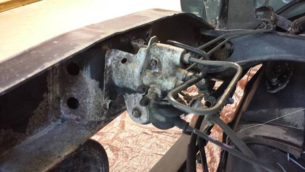

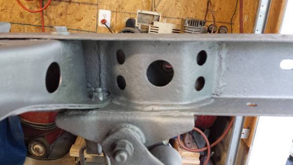

    [​IMG][/url [​IMG][/url [​IMG][/url [​IMG][/url [​IMG][/url [​IMG][/url [​IMG]
