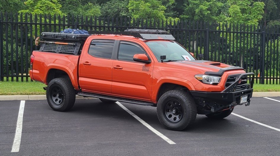

    2018 Sport MT. Bilstein 5100's x4, with the longer version for the rear. Heavy springs front and rear because I knew I'd be adding weight. About 3 inches in lift. I bought the package deal from Headstrong and added the longer brake lines in the rear. Added SPC UCA's. Just replaced the ball joints this past weekend with 76k miles on them, 126k on the truck. No issues with premature wear on anything. Also running your tire size, but I have done some cutting because I'm running a 17x9 wheel with KO2's. This set up kept the factory rake which I prefer. That way if I squat the truck with a heavy load, it still looks somewhat level.

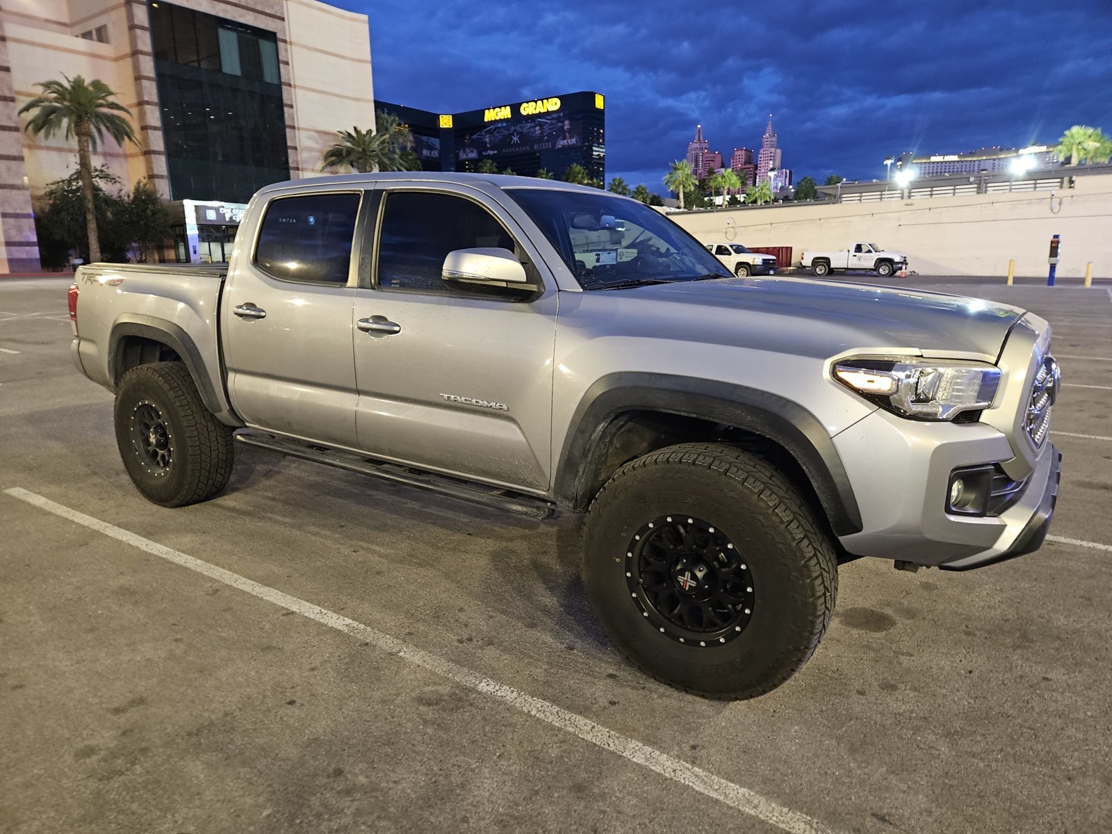

    Fwiw, I am minimally lifted, Bilstein 5100 in front and Toyota's 1/2" rear blocks in the rear. I can adjust my 5100s and use the 1/2" blocks or not, to get the rake I want considering the full skid set and rock sliders I have on it.
    I consider this pretty minimal. The additional armor weight and my wide 33s probably causes greater wear than the suspension changes.

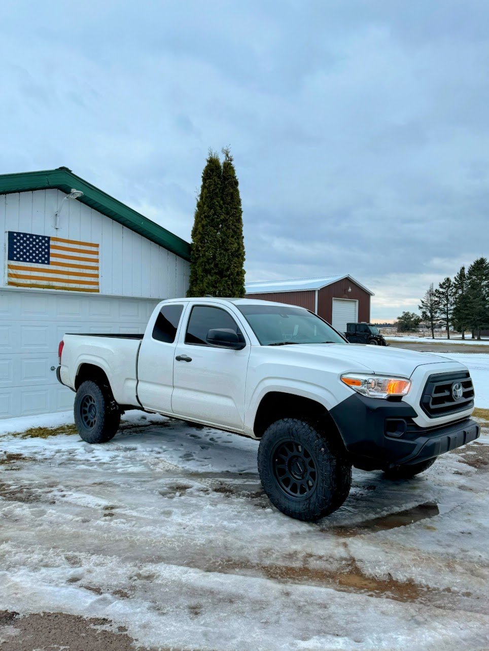

    2/1 lift on mine, don't regret it. Originally did 2" with 1.5" tapered block but had some vibrations when braking, moving to a 1" tapered block resolved it. Looks better too, less rake. Simple lift, giving me the look I wanted with 265/70 tires. PERFECT lift for this size tire.
