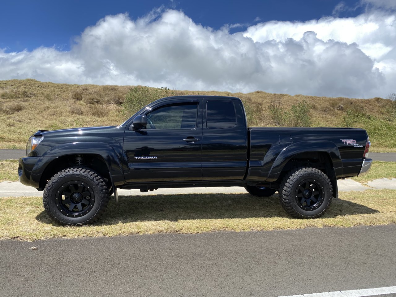

    That looks badass man!
    808hiker[QUOTED] likes this.

    Yes sir. After seeing 808hiker's picture with the 2.5/3 inch lift and same size wheels and tires, I really like the look of that, and for a little bit more money I can lift it in the rear too.
