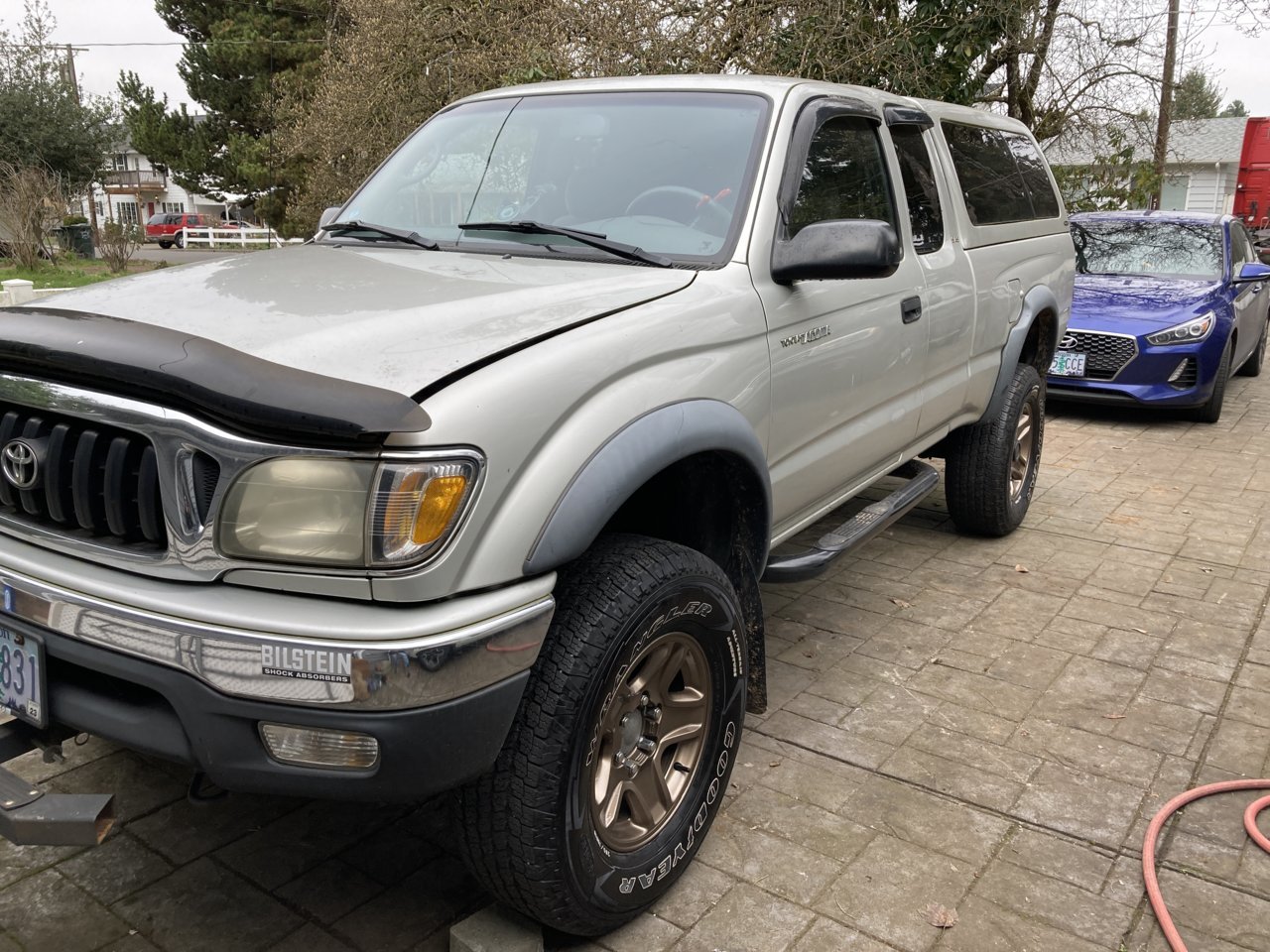

    Own a 2001 2.7L 4x4 with 183K. Very well maintained and owned since 2005. Thinking I need better traction when I go on trails or up hills etc.
    This is mostly a daily driver and truck I drive to tow or haul so its always on concrete.
    Not going to do an auto locker.
    But here are the parts quoted to me:
    Front 7.5" TrueTrac - $567
    Rear 8.4" TrueTrac - $588
    Shipping to 97078 - $55.94
    Total - $1,240.94
    Install if I remove the diffs is $125 per gear box. Then I reinstall myself.
    What do you guys think?
