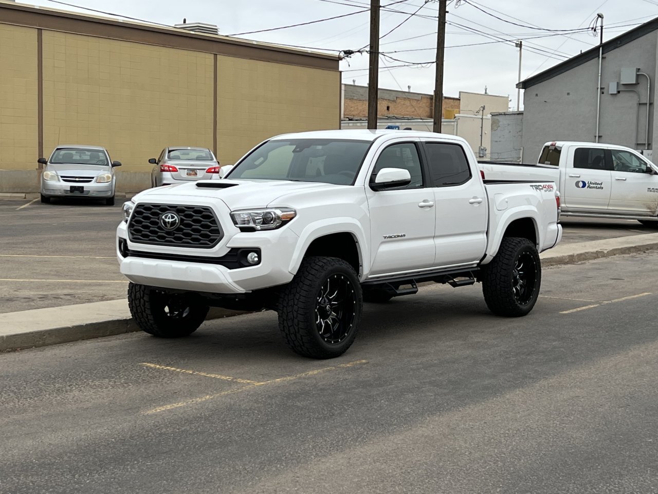

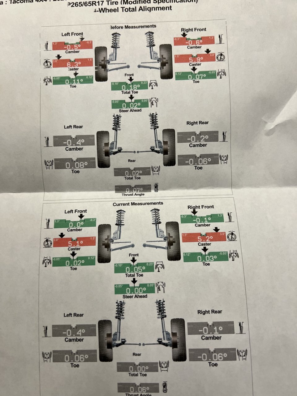

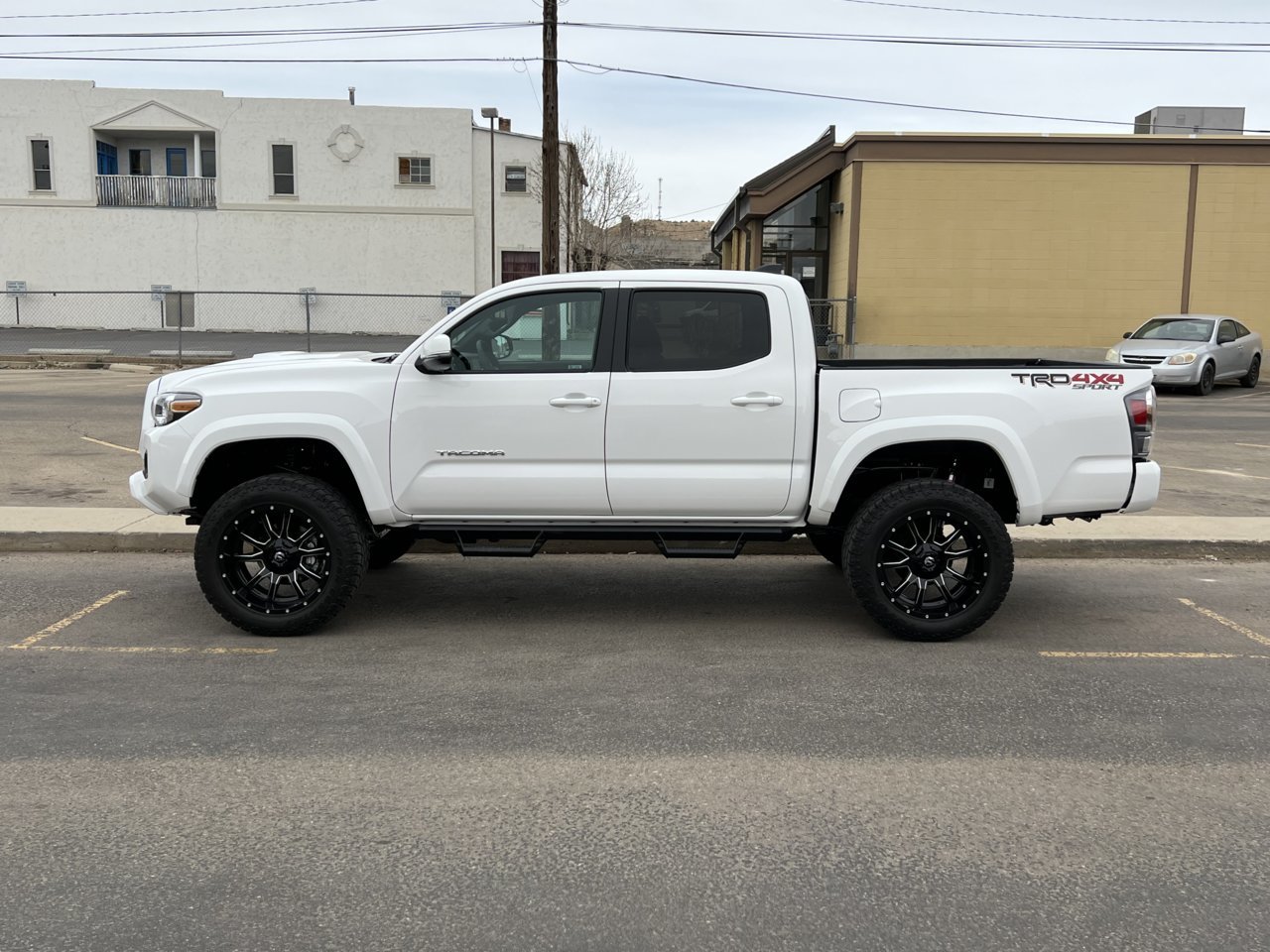

    96C74B54-9A43-4BE9-B14D-E05840BD7F62.jpg E35977B5-47C0-4FB0-BC5D-3DF70488D7DA.jpg 6C7B648C-7920-4B58-938D-92E5506A4084.jpg Hello all this is my first post and my first Tacoma I have been stocking you guys for the last few months while I have been waiting for my truck to arrive, I only drove it 20 miles and installed a 3/2 lift and Nitro Gear upper control arm and Eibach shocks. After installing the lift I did the good old eye ball and tape measure alignment so I could get it to the alignment shop and it drove pretty good, my question is after the alignment with these Nitro uca my caster ended up at 5* the truck drive really good but I am concerned that 5* might be to much and was thinking maybe I should get some Spc upper arm so I can lower the caster and still try to keep the tire moved as far forward as possible to reduce tire rub. After reading many post on here I know that most of you look down on mall crawlers but the truth is that’s exactly what this is I don’t do much off-roading in my old age. Here are my spec.
    2022 TRD Sport Readylift 3/2 lift, Nitro Gear and Axle upper control arms, Eibach shock, fuel 20x10 wheels with -18 offset, 285/55/20 Toyo AT 2 tires.

    your final numbers look good. if it drives right, doesn't bind or rub, noisy, etc, then you are good to go. i run 5deg caster, 0 camber and 0.03 toe in and i jump my truck! and it's all good here. my setup is different from yours but you should be totally fine there with no abnormal wear issues or anything. :thumbsup:

    3 to 5 degrees is ok after a lift.
