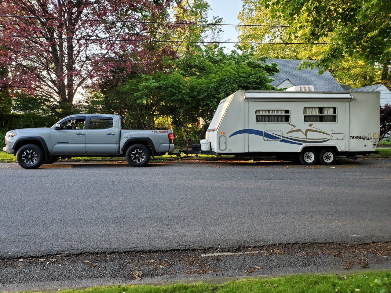

    20190520_192810.jpg So this is the first travel trailer I've ever owned and towed. Dry is close to 4k. First off how do you turn off the over drive? Truck pulled pretty well as to be expected I could feel it pulling weight. But I noticed it didn't seem firm. Like it felt as tho while driving the truck was rocking a tiny bit front to back :/ and once I got it parked I noticed it seemed a bit up in the air in the nose section. Does it look bad? I'm guessing airbags wouldn't hurt to install. Is there other options then air bags? Any advice to make things even smoother I'd appreciate. Oh also if you're on a hill and you're say at a light what's the best way to pull out without the camper pulling you backwards so much?

    Airbags are the best, especially if you tow/haul more than 4 times a year. It drives way better, you don't blind people and it doesn't look jenky.
    I have them on my ford and you can't tell when there's 1900lbs of soil in the rear.

    I’d get airbags for sure if it’s 4000lbs dry.
    To get out of overdrive, simply move the shifter from “D” to “4”. Assuming you are a second gen. automatic transmission.
    On a hill, just be quick with your foot ?
    Could double foot the brake / gas, but I’d make sure you have the motion down before you accidentally do something you don’t intend on doing.

    Sorry guys duh forgot to load the pic. So again how does this look to you guys? Put the pic in the original post

    It's down a lot, this takes more weight off the front axle (not as big of a deal as it used to be) but the idea is to keep as much weight forward as possible. With weight off the front axle this means the heavier front brakes are taking less load and are less effective. This also makes steering lighter. Again your headlights are also pointed way up and blind other drivers.
    Sumo and overload springs correct this, but at the cost of ride quality during daily driving. https://www.supersprings.com/shop/ssr-611-40/
    Air ride simply needs minor maintenance and a compressor inboard or outboard and manually set. https://www.headstrongoffroad.com/store/p225/FireStone_Ride-Rite_Air_Bags_for_2005-2018_Tacoma.html
    Another alternative that is tow load specific is weight distributing hitches. https://www.curtmfg.com/weight-distribution/hitches
    The style I would avoid is the Hellwig, https://www.sdtrucksprings.com/hellwig-helper-springs/toyota/tacoma they are noisy, bouncy unloaded and I see more complaints on them than the other styles.

    I’ve had great luck with weight distribution hitches, towing a similar sized toy hauler, but with a 1st gen tundra.
    They work really well.

    Honestly the WD hitch is set for the guys 08 Tacoma. I'm thinking since my truck is taller I need to readjust where he linked his chains. But would I move the chains down or up if my truck is higher? I was thinking of scraping the older Reese one and getting the camco recurve we hitch
