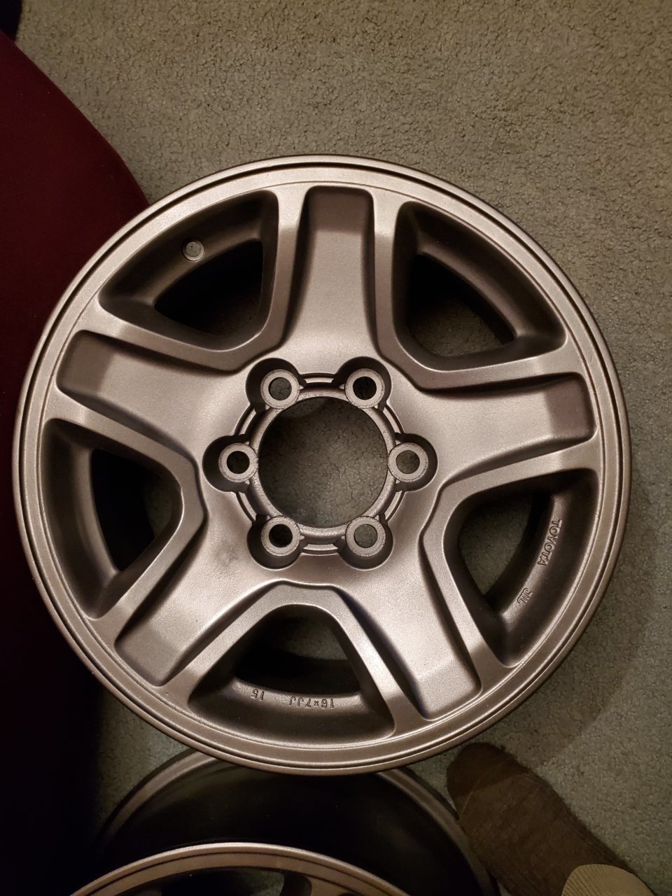

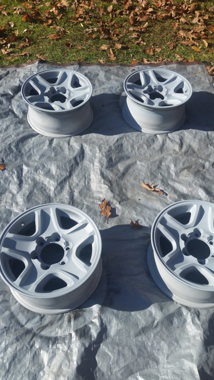

    Oh oh buying some TRD wheels of CL can be only 500 bucks sometimes. Non of the 2nd or 3rd gen appeal to me, a Tacoma has rounded lines and they have square ones, although that blue taco looks slick with them. I had to go the hard route but Im keeping it kinda old school and these rims are very similar to the stock metal ones, with out the rust lines.
    Well I'v just put down 2 coats of SEM self etching primer front, back and rim. The media blast did wondered, its just how much trouble do you want to go sanding out imperfections. Pictures to follow.

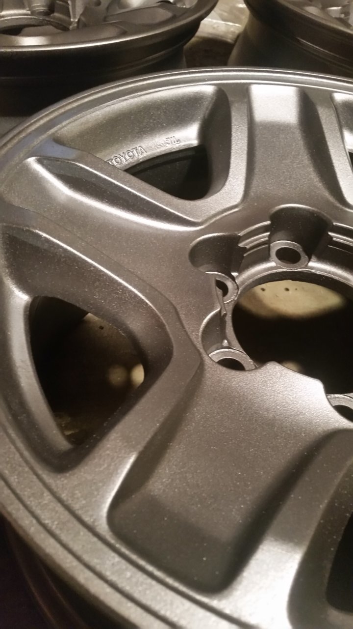

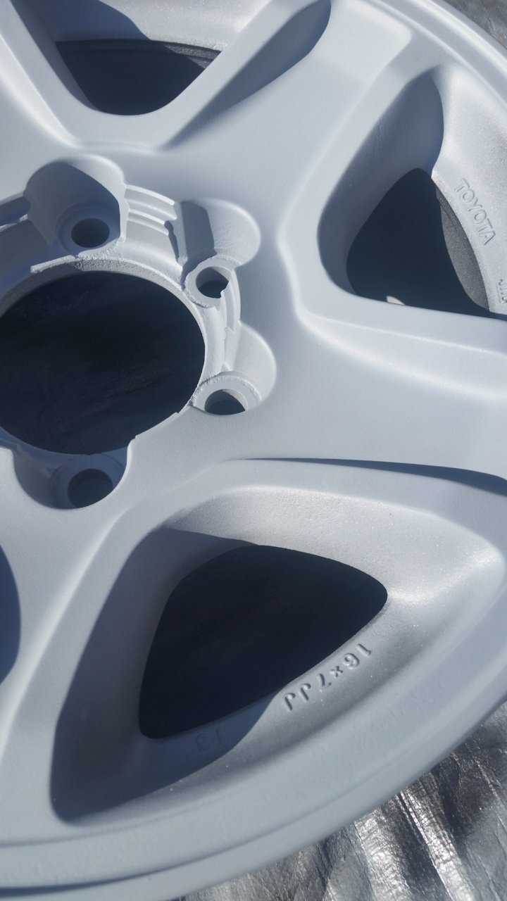

    So in the close up you can see the imperfections, its easy to sand out, I may go around again then give it a few coats of primer or not. I'm to cheep to paint the whole wheel but wondering if I should clear the whole back of it.

    If they media blasted the whole wheel, I'd do a clear coat on any exposed metal that you didn't paint. It'll keep the metal from oxidizing and looking yucky. If you live in the salt belt states, I'd definitely make sure everything has something on it.
    Don't paint the mating surface on the back of the wheel though, that's no bueno.

    Looking pretty good, man. I think you realize that prep is key. I'd definitely go back over any yuckies you find now, give the primer plenty of time to cure (24h if you can afford it) then a good wipedown. Go slow and light with plenty of layers of your chosen paint and then clearcoat. An area to take extra care with since you're doing this tires/TPMS off is the edges and inside of the outer lip.
    I think a clearcoat on the backside wouldn't hurt either, especially if you live in a salty area - just knock down any bad bubbling or imperfections.

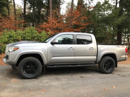

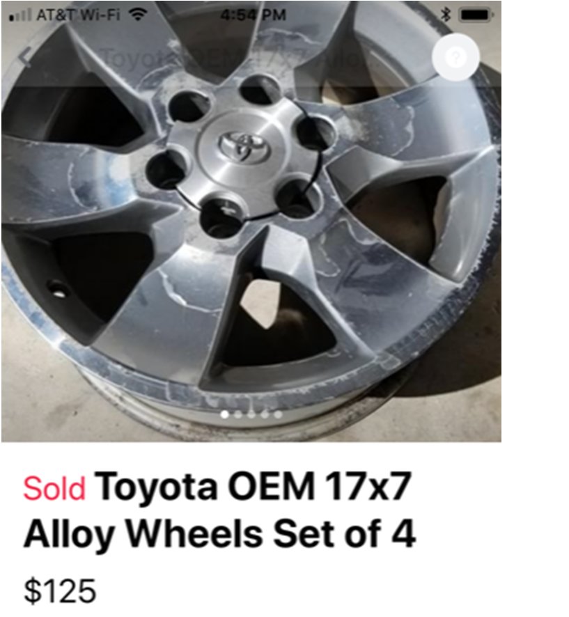

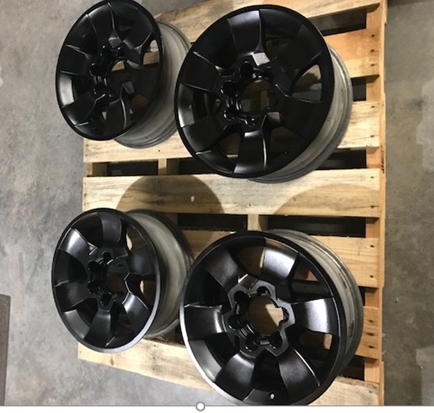

    I purchased a set of aluminum 4-Runner wheels and center caps off Craigslist for $125. Clear coat had failed.
    I used a Jasco gel stripper and let it sit for about 20-30 minutes and scrapped the clear coat off with a plastic putty knife. The clear coat came off like butter. After doing so twice almost all of the clear coat was gone. I had to sand a couple spots in the corners / creases, but it all came off with little effort. Also some scuffing or scratching of the coating helped the gel penetrate the areas where the coating seemed to be more intact. I would think that the stripper would work on other wheel coatings beside clear coat.
    I washed the rims well and cleaned them with rubbing alcohol.
    Rattle can painted just the fronts of the wheels and center caps.
    Rustoleum self etching primer
    Couple coats of VHT semi-gloss black wheel paint
    Couple of VHT clear coat.
    $175 total cost.
    Came out surprisingly good and has held up to one New England winter. Wheels / tires will be put on again in a few weeks for second winter.

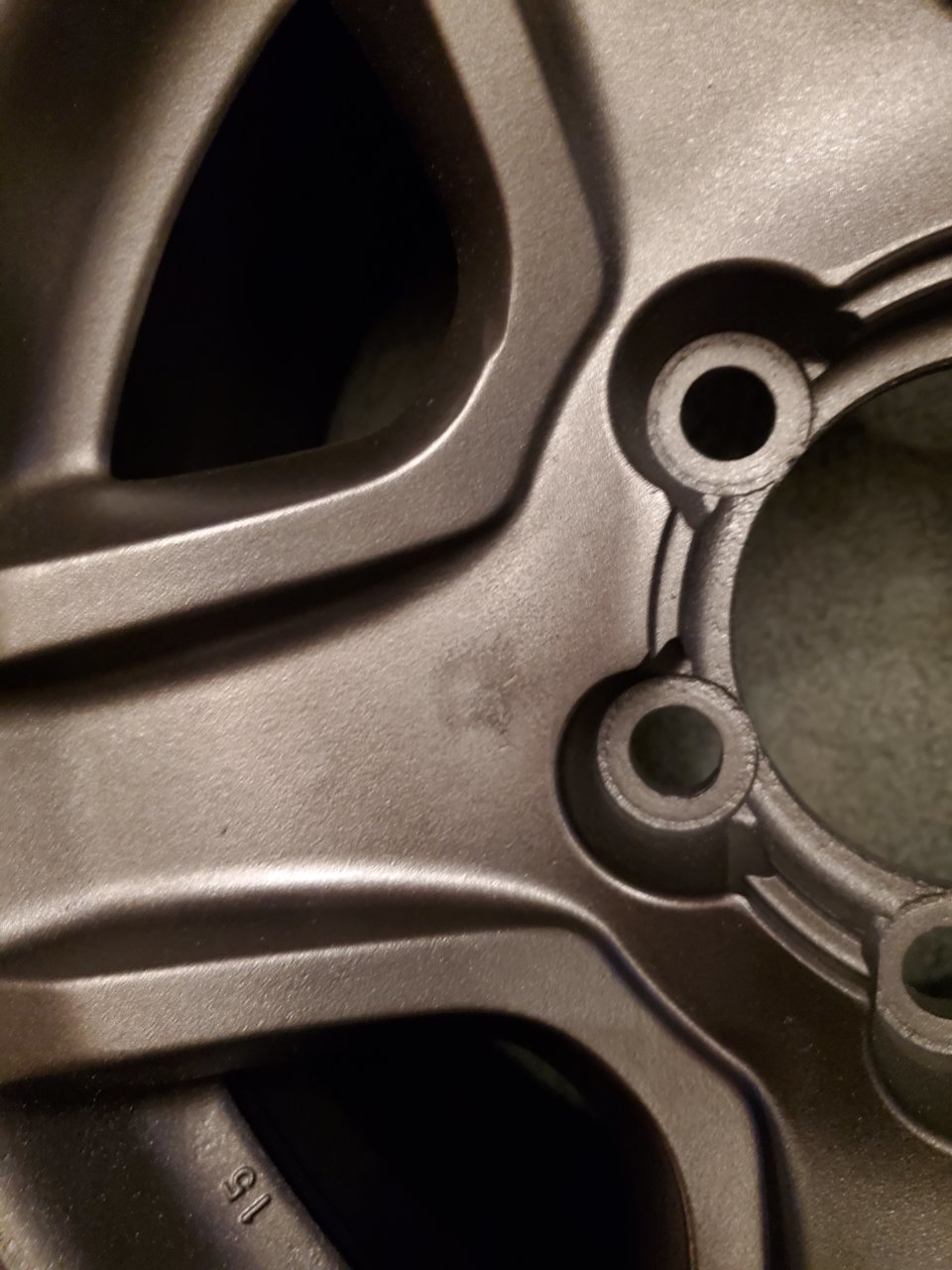

    Ok went back and sanded some rough spots then gave a good coat of primer. Ended up doing 4 coats today.
    Im looking for recommendations for clear coat, trying to avoid acrylic. Poly is expensive but I did see Min wax had a poly can for 8 bucks!
    Edit, the particle looking things are just light hitting the metallic flake they are pretty smooth but need a mat clear.

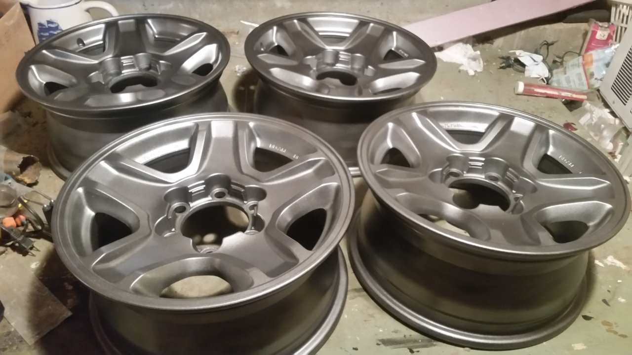

    So almost complete. The rest have 4 coats of clear matte. This one the clear dribbled from the can but I'v sanded it and waiting 7 days for it to cure, then one coat top, then 4 coats clear all within hour. The combination clear coat matte and graphite paint is amazing. You dont see the clear coat and it dulls the paint to make it look like metal. Plus any repair pretty easy with this metallic color. I'v also been painting over the clear coat with the VHT wheel paint too, they are all poly. I also was toying with the idea of baking this one in the oven at 200 for a half hour. My concern is vapor is trapped.
