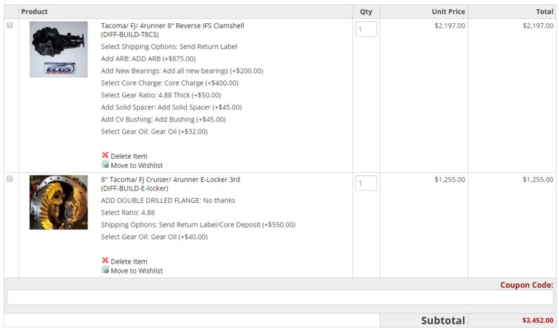

    Since I have a TRD OR no ARB's for the rear. I would have to change out the rear end to the 8.4" I definetly want the bigger compressor along with a tank to allow for use of air tools. Current quote for above mentioned items (-the rear locker) $4200.

    I already ran the quote through them. The front alone is almost $2200.

    2200? What....I literally just got a quote and after you return the cores it comes to 1300

    Maybe I should have clarified. Below is my shopping cart. I wasn't subtracting the core plus I have the locker in there.
