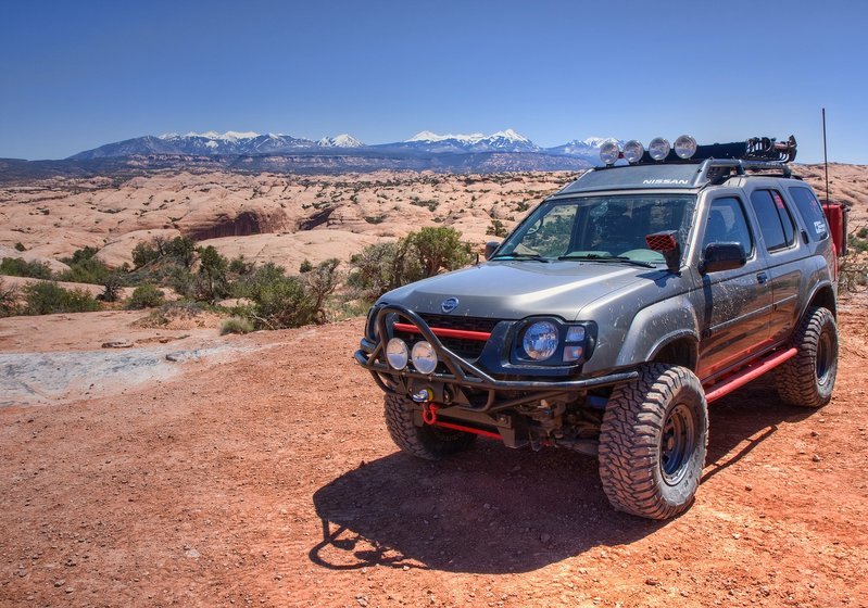

    On my Xterra, I built my own and just attached a Safari snorkel head. Much much cheaper. I used ABS and sealed everything with silicone, even though the pipe pieces were glued together. I used metal strapping to anchor points to hold it in place. Cut my fender with a dremel, smoothed it out and added some plastic trim around that. Pulled out all the stupid baffles. Sealed up the air box as best as possible. Works great.

    I don't know where the install photos are but you can see it in this photo.
