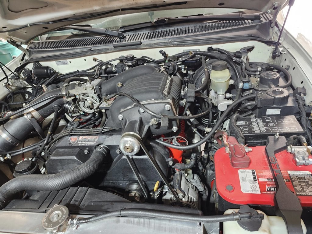

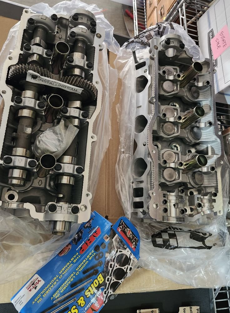

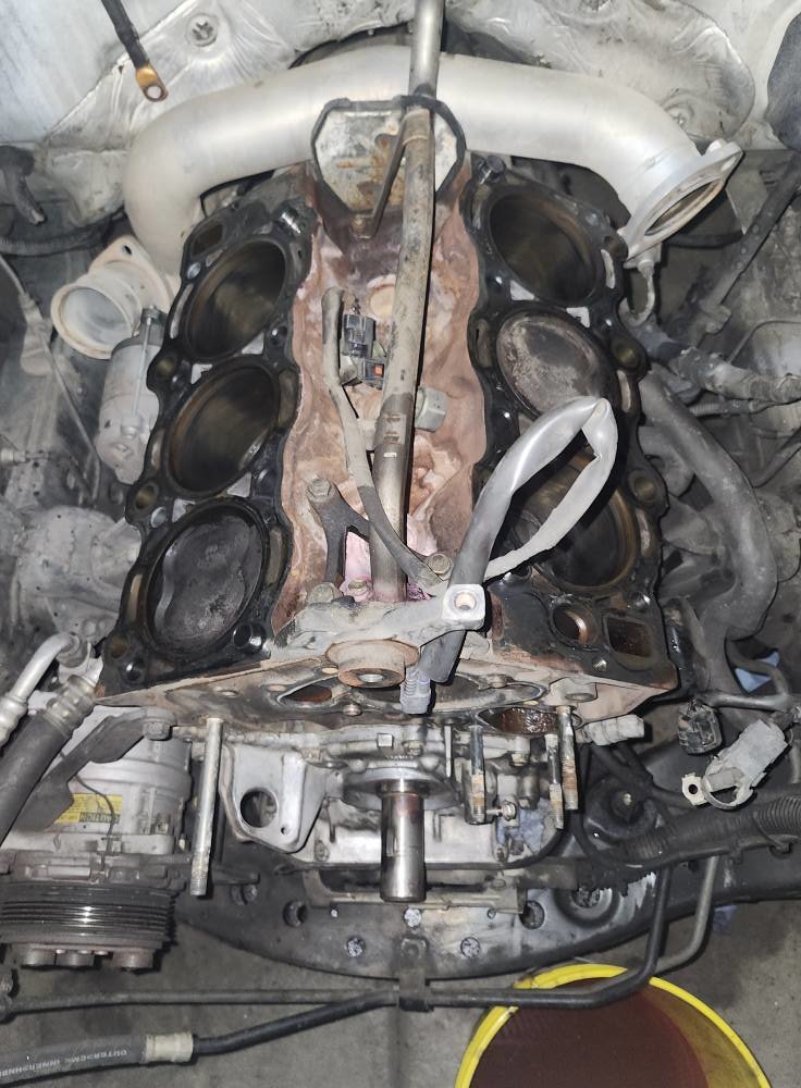

    I had a small leak coming out of the head and block that you could see some weeping.
    Got new heads installed,

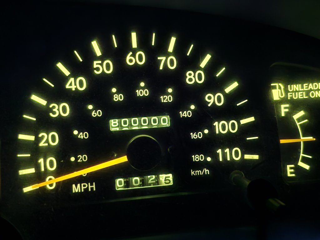

    rolled over 800k all supercharged miles.

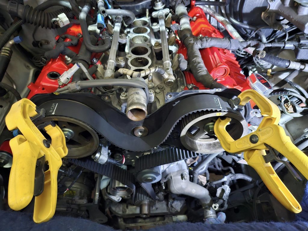

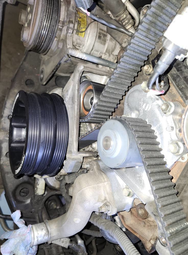

    Decided its time for new heads from Yota1, ARP bolts, timing parts, LCE light weight pulley and new injectors, motor mounts, etc.
    Heads were full of cracks, one burnt valve and low cylinder pressure at 150 for most and 110 for one.
    New heads all cylinders are at 175-180 psi lots new power.
    1st engine the head gaskets popped at 485k,
    Got a used motor that was in the truck running that had 90k.
    Now that motor has 500k and low cylinder pressure and a very small blown head gasket.
    For me both motors head gaskets popped at 500k range.
    Got new heads with ARP bolts that torque to 80lbs this time and all my cylinder pressure numbers are all 180 compared to 150 before with old heads,
    Was a long job a week on and off but not that bad.
    Lots of new power now!
    3.4 heads run 400-500k and then they are start having problems
    A week later shes back up and running going for 1,000,000 lol

    You went with the lightweight LCE crank pulley instead of the heavier OEM crank pulley?
    Or did you have the LCE on before this all new power?

    Yes, added it as a new part

    That looks nice!
    I am curious about how the harmonic balancer is with that or did they delete it...I was still reading up about it on the webpages because I could use a nice looking new one again someday...1st crank pulley balancer failed at about 192k

    It’s from LCE PERFORMANCE, I decided to replace the original one as the rubber was wearing out and there was a small wobble.

    if the input shaft bearing is making noise you should NOT be driving it. It’s just a matter of time and it will start to shead metal that will ruin a lot more.
    Yota1 definitely is a top tier company for any work.
    If you’re at 400k it’s a matter of time before you need the heads rebuilt or if nothing else do a compression test and if that’s good the valves will most likely need adjusting. Thats a huge pain FYI,

    your CSP lasted much longer than mine did, it was shot and separated before even hitting 200k :(
