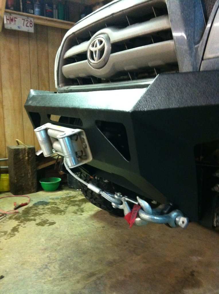

    I used cheap primer and dominion sure seal rocker guard, and let it dry thoroughly, I've hit and rubbed 8-10" along a few trees and took the bark off without loosing any paint. I laid out some plastic on my garage floor not to make a mess, sprayed the back, let it dry, flipped it and sprayed the front, let it dry, bolted it on and used it
