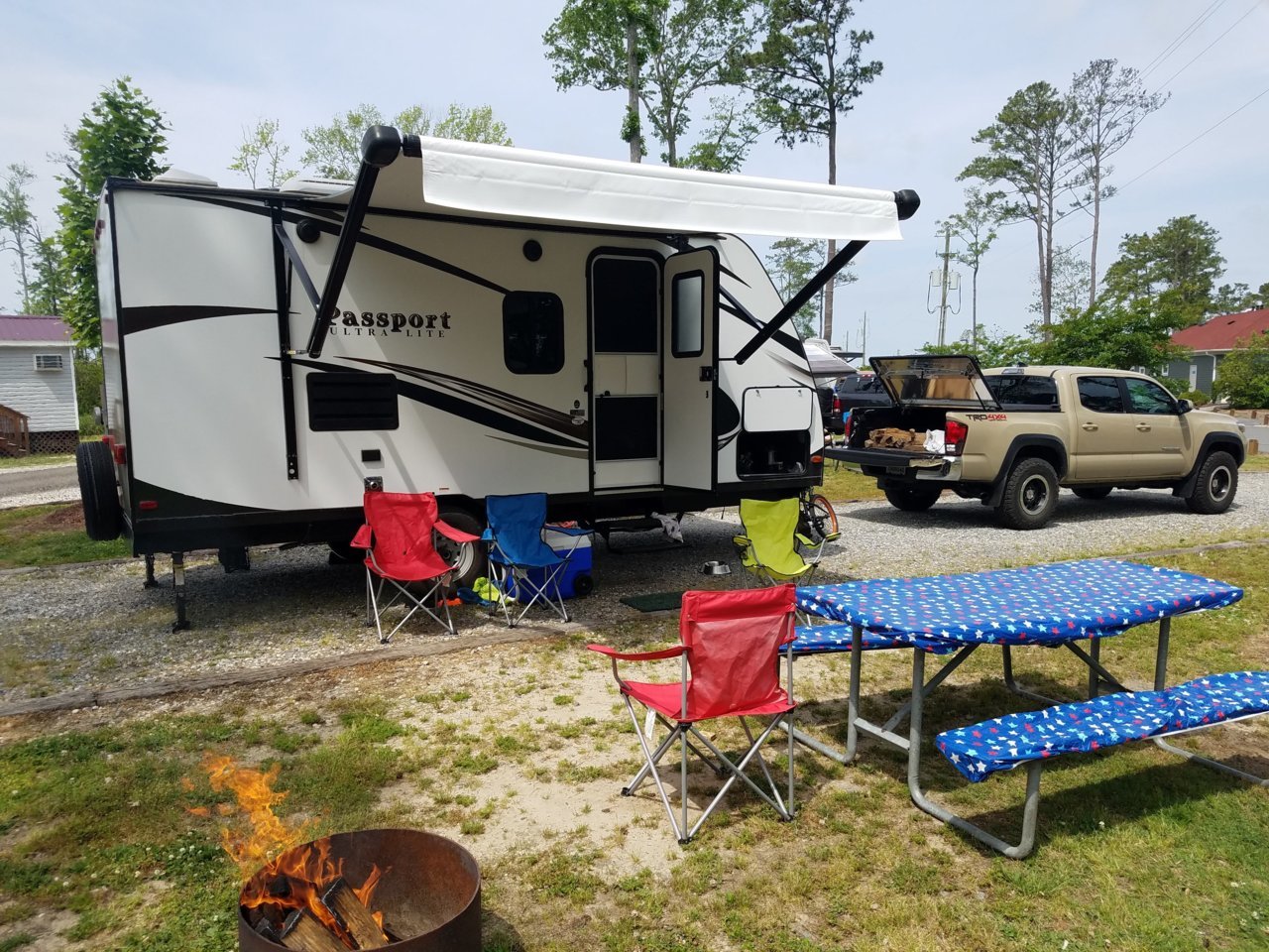

    I tow a Passport 175 Bunkhouse (queen bed, 2 bunks, bathroom, small kitchen/dining area) with my 2019. I use a weight distribution hitch with no problem. Way pithing the limit of the truck and honestly pretty comfortable for wife, two boys, german shepherd and me. It makes for some great family memories.

    I like the looks of your Passport.
    What tires are you using?
    And which model distribution hitch?

    Thanks. The model is Passport 175BH and the dry weight is around 3300#, so it keeps you well within the towing capacity, has an A/C and keeps me from sleeping on the ground. Most important, the wife is happy with it. There are several brands that sell the same layout.
    I am running the BF Goodrich KO2s (265/75R16). I will have to get back to you on the brand of the hitch. I can say this was the first weight bistro hitch i have used and was impressed how it keeps the rear of the truck from sagging.
