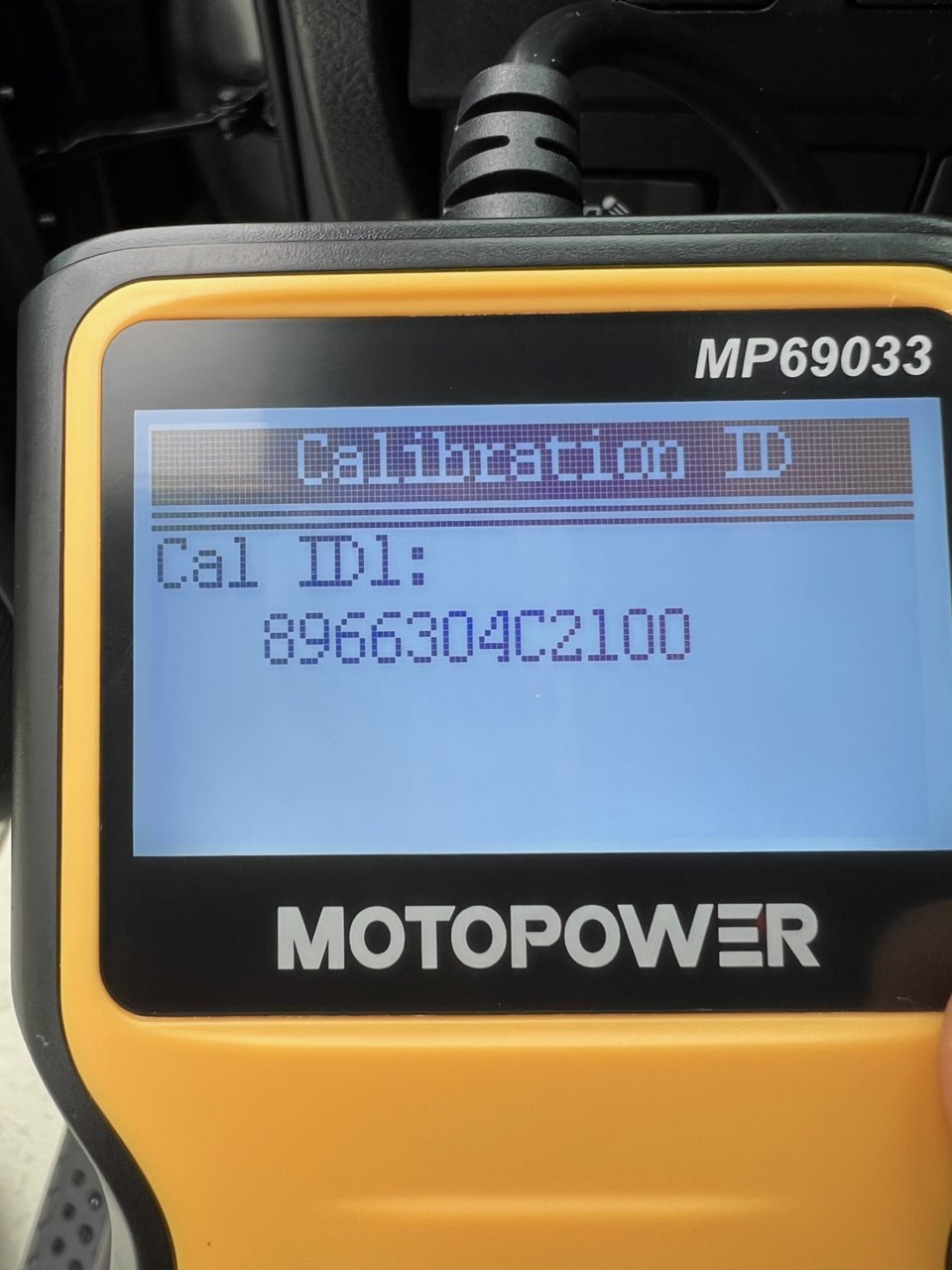

  3. Jul 28, 2022 at 12:46 PM
    #103
    FL_TRD Sport
    FL_TRD Sport Suffering from Severe Wallet Drain
    May 30, 2021
    #367208
    3,603
    Hector
    Port St. Lucie, FL
    2021 TRD Sport MGM DCLB (Sold)
    KDMax Pro 10.0, Form Lighting Tail Lights, and more
    Easy enough to check with an inexpensive OBDII scanner that will read the calibration ID. I got mine on Amazon for $17.80 on Prime Day. It's $25 now but still cheap. https://www.amazon.com/gp/product/B07Z3HB7DR?ie=UTF8
    You can then compare that to the TSB listing on @tonered's thread and see if the latest TSB is flashed.
    tonered, gen2eng, TOKsTaco and 3 others like this.

    FL_TRD Sport
    May 30, 2021
    #367208
    3,603
    Hector
    Port St. Lucie, FL

    FL_TRD Sport
    May 30, 2021
    #367208
    3,603
    Hector
    Port St. Lucie, FL
    There's no doubt the technology exists and is in use, but some manufacturers are much more aggressive about it than others. Toyota is nowhere near as aggressive about it as someone like BMW, who will hook up and flag a vehicle whose map falls outside certain parameters. It would be pointless, however, to go through the trouble of detecting that and not inform the service tech/dealer service department, who are the ones performing the warranty work.
    While I can't speak for other tunes, a KDMax tune does not alter the ECU ID, so hooking it up to TechStream or an OBDII reader to check the ECU/Calibration ID would show a stock ID. You'd have to start digging into Calibration Verification Numbers (CVN) to tell the difference. If there is a concern then simply flash back to stock before going in for warranty service. That would return the CVN back to stock, then you'd have to start getting deep into the ECU and looking at checksums, etc. No one at a Toyota dealer is going to do that unless you're talking a pretty significant warranty claim and was directed to do so by Mom Toyota before approving the work. Is tuning 100% risk free as far as warranty work is concerned? No, but the odds are pretty slim. There have been recounted experiences of people having significant warranty claims with a tune without issue, and also of people passing the CA smog check, but as with all mods, YMMV.
