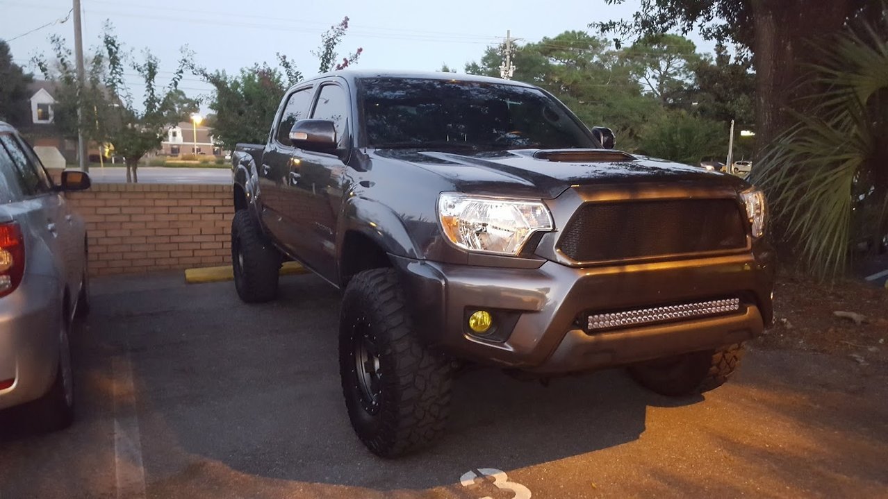

    Here's 5100s/885 and some 285 tires for your viewing pleasure.

    EatSleepTaco great looking truck. Did you have to do any trimming to stuff those 285's in the hole?

    Shit yeah I did. I did a CMC, hammered the pinch weld, cut plastic out of the way, and still rubbed.
    On my current truck, I'm running 255s, and prefer them so much more than the 285s. No trimming except a tiny bit of plastic with a razor, and that's it.
