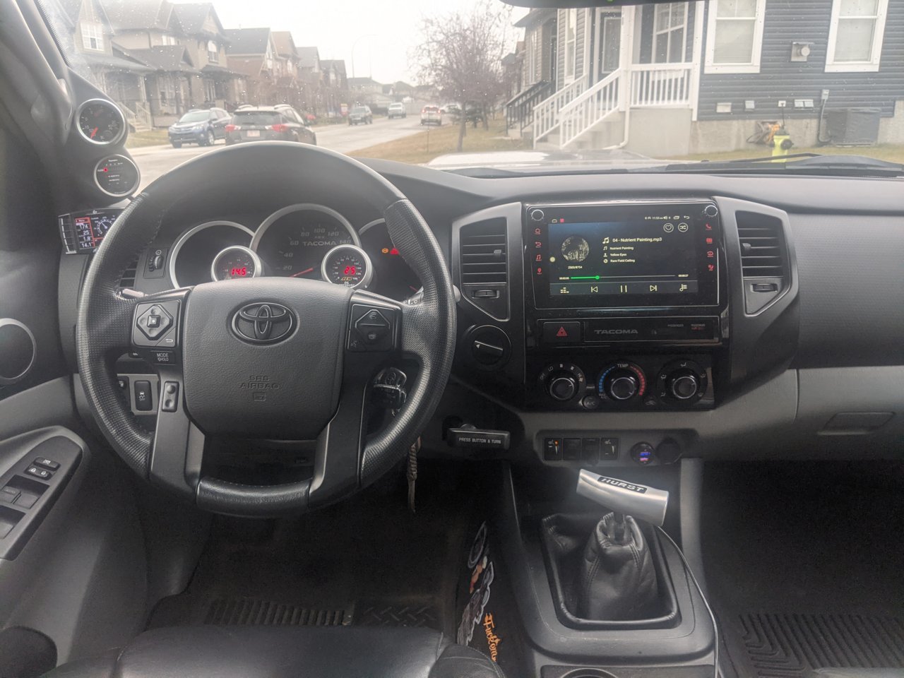

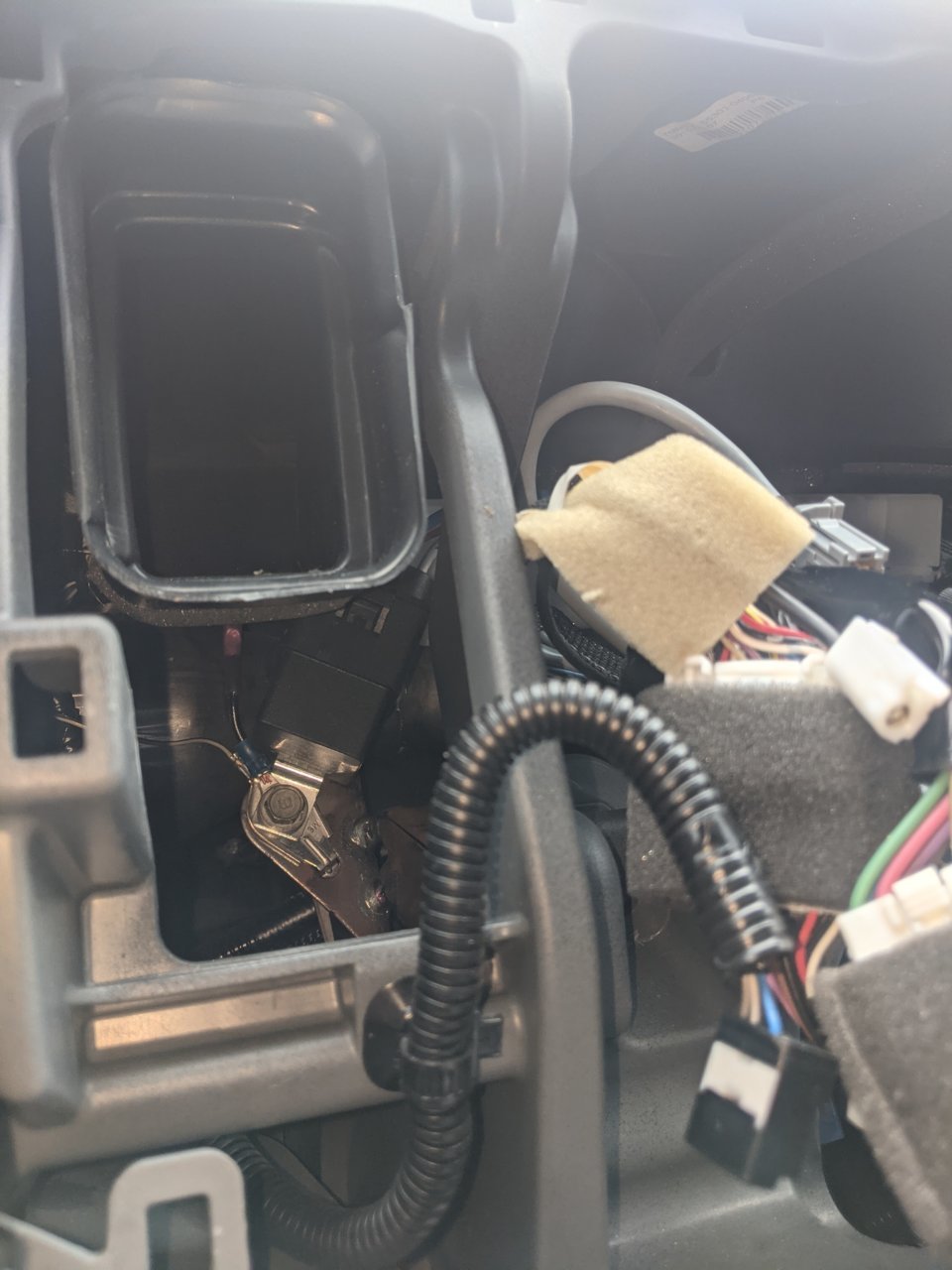

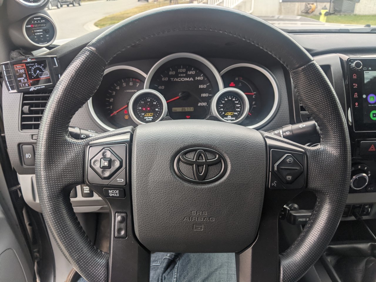

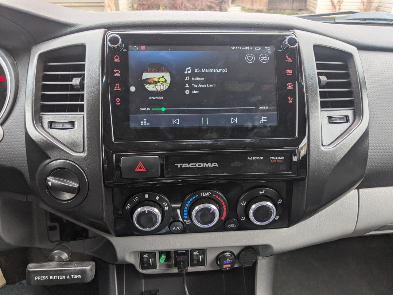

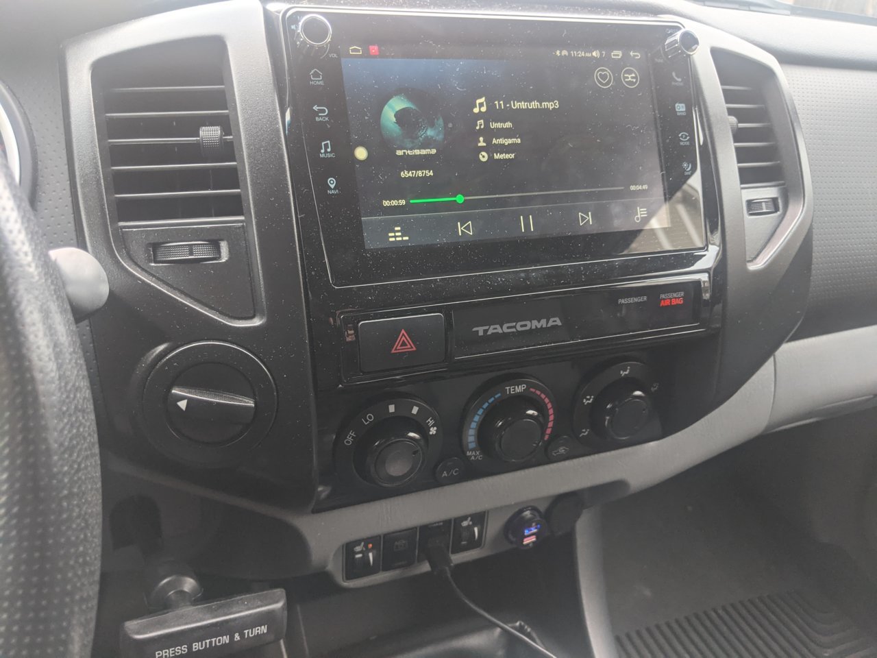

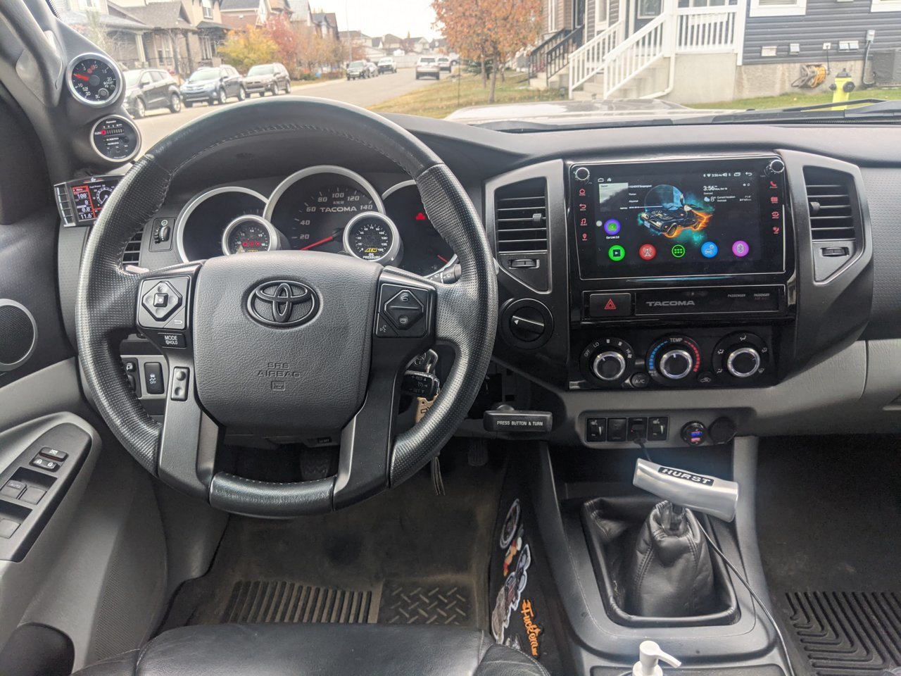

    Latest project was installing a joying android head unit. Sounds and looks better than stock and wireless android auto capable. Decided to paint the radio surround and steering wheel bits black because I've been meaning to do it for a while.
    Joying head unit
    Blacked out steering wheel
    Dash-o-rama

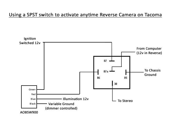

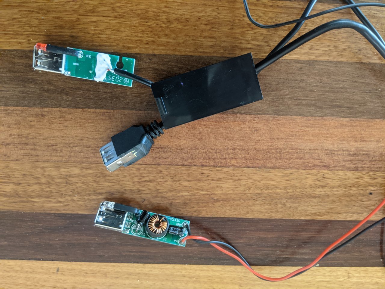

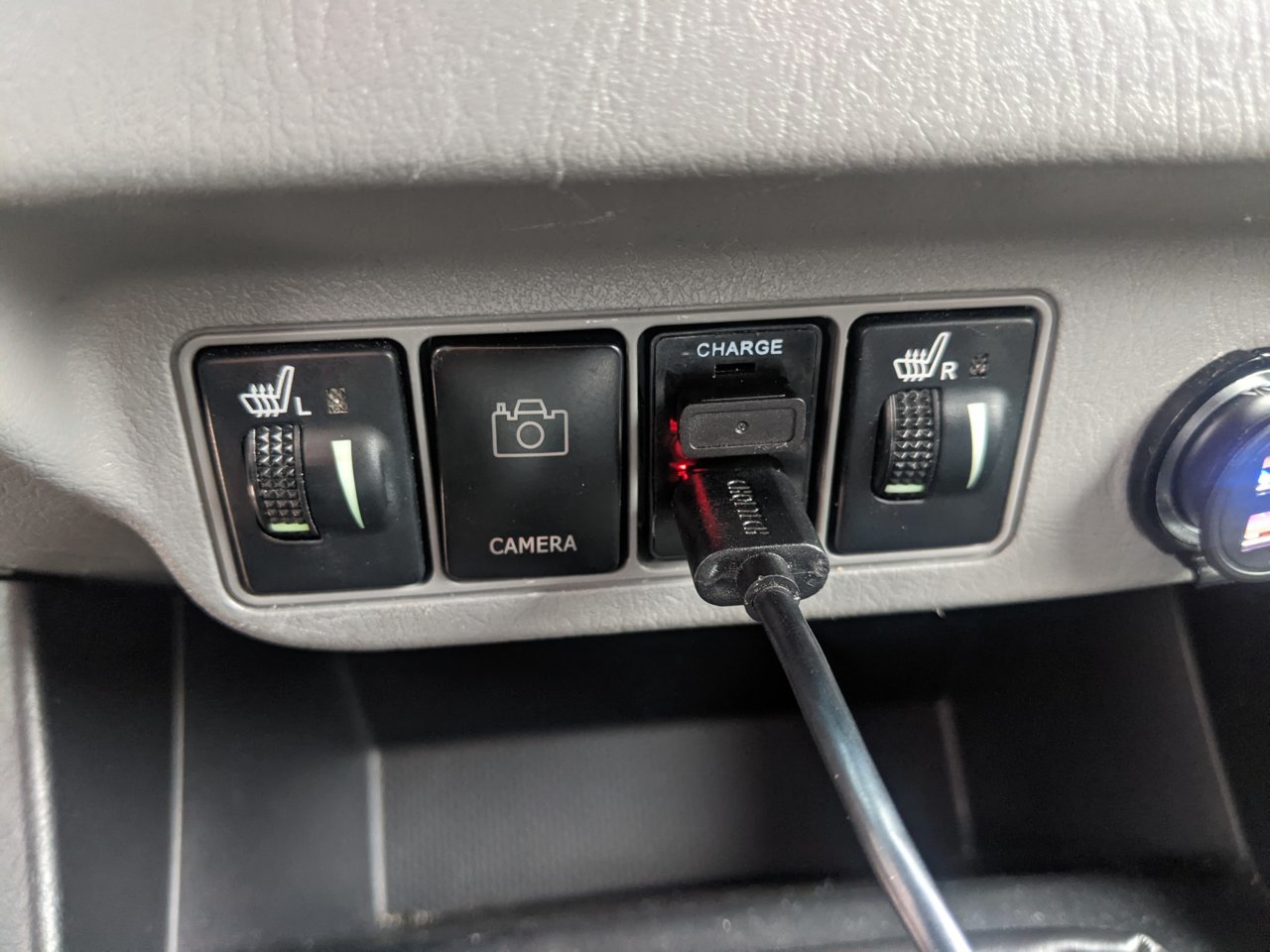

    Also wired up a backup camera anytime button using a relay to switch and modified a duel port usb (one port was power only) into dual ports that feed into the head unit. Also switched the blue LEDs in the camera button for orange LEDs.
    After some use I gotta say the anytime camera is simply amazing for parallel parking on an uphill where you use neutral and gravity to back up because it's easier than putting it in gear.
    https://www.ch4x4.com/product/toyota-small-usb-power-socket/
    Backup camera relay tucked in dash.
    USB port mods
    New USB ports and backup camera pushbutton. Broke off the usb led because I found it annoying.
    Wiring diagram I used for backup camera

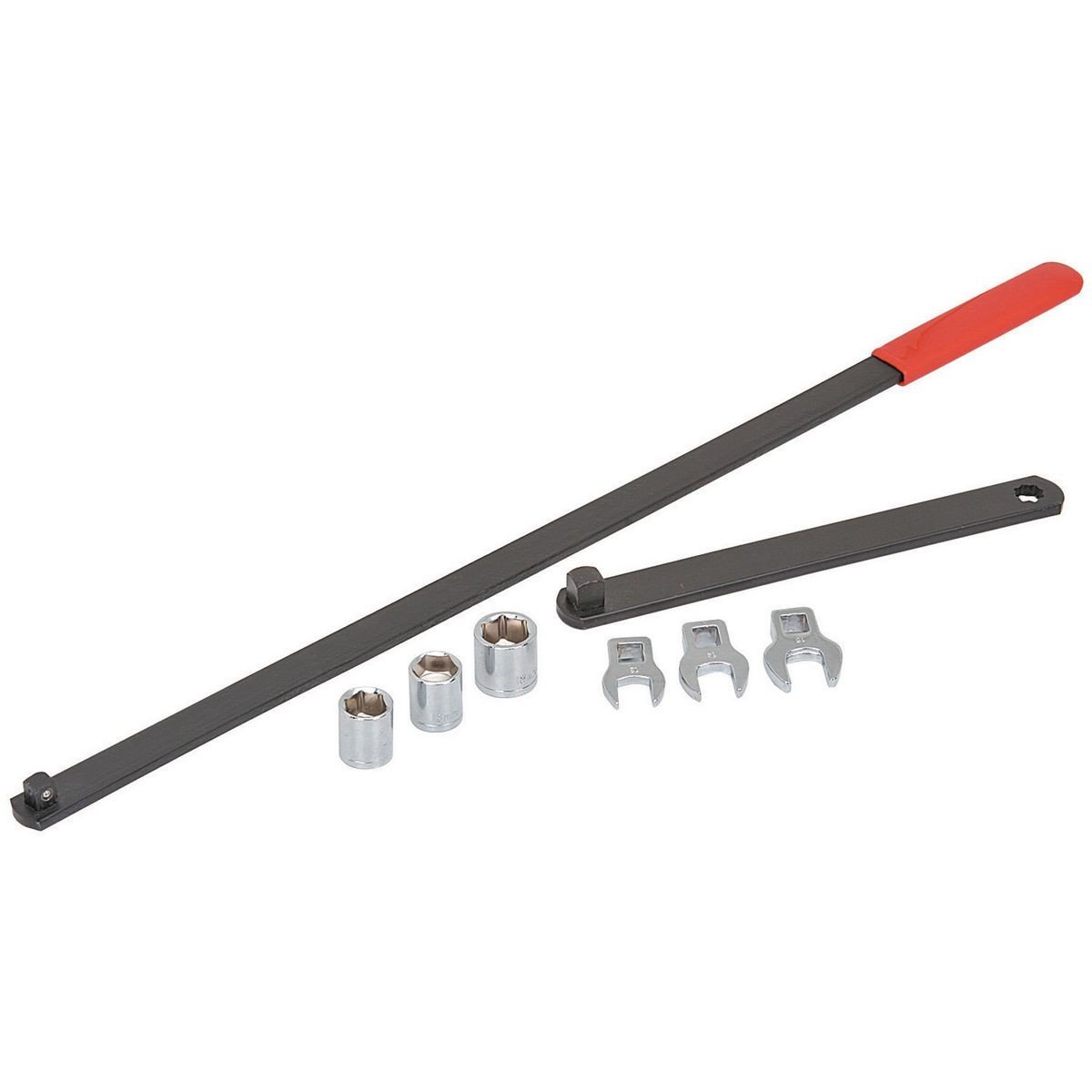

    Since I recommended it in the SC thread I thought I'd post some of my favorite tools.
    Cheap and inexpensive belt tensioner tool that permanently hides in the cubby under the rear seats. Apparently someone broke one of these three times but it's been good to me so far. Will replace with something better if it dies on me but it's been handy so far.

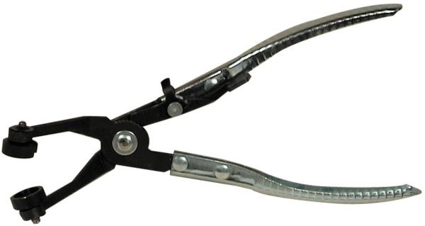

    Cheap ratcheting hose clamp pliers! When you need them these things are as fun as tits to play with.

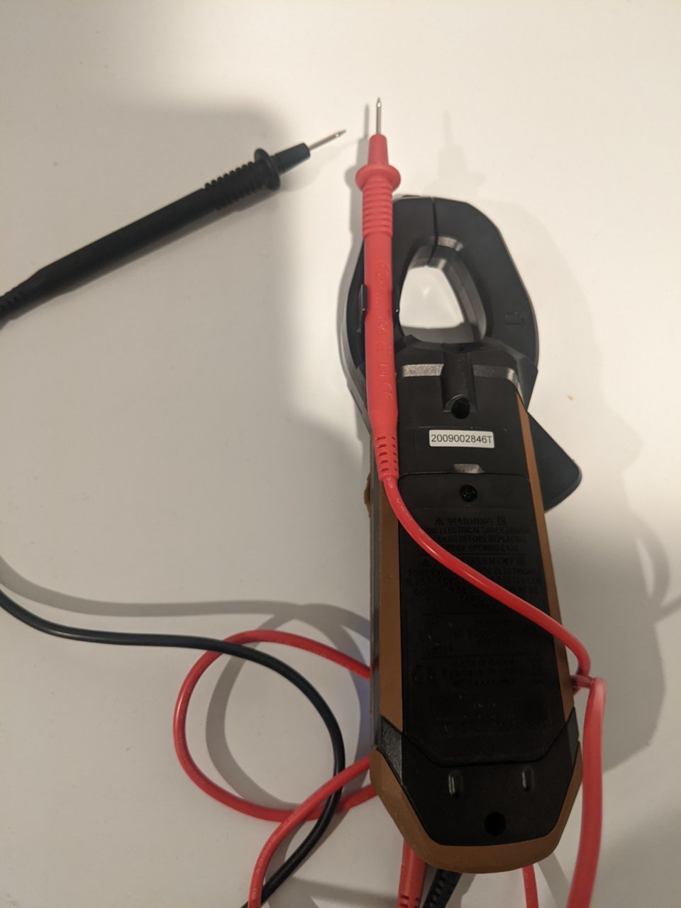

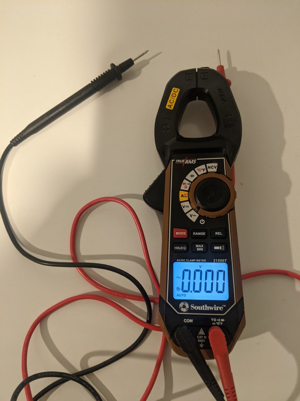

    Southwire 21550T clamp meter. Got this guy on sale from Amazon. Really good quality meter for the price and the clamp that holds one of the probes on the back is super handy for troubleshooting. Size is nice for working on the truck too.

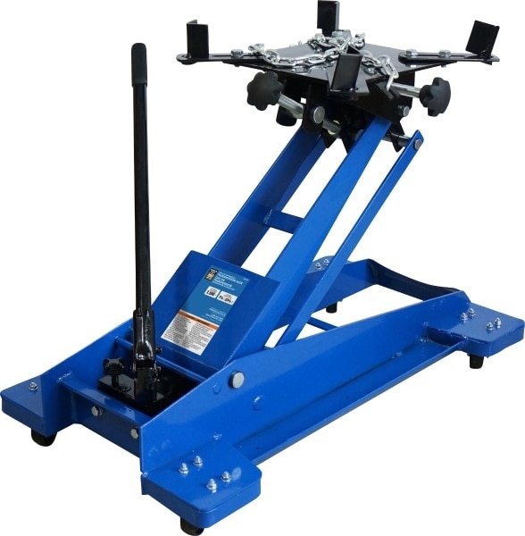

    My transmission jack! One of the tilt knobs is in the stupidest location but overall it's really nice to use and have. Dropped the trans twice and it helped with taking the third member out for installing the truetrac. I even use it to support the rear driveshaft when I have to remove/reinstall it.

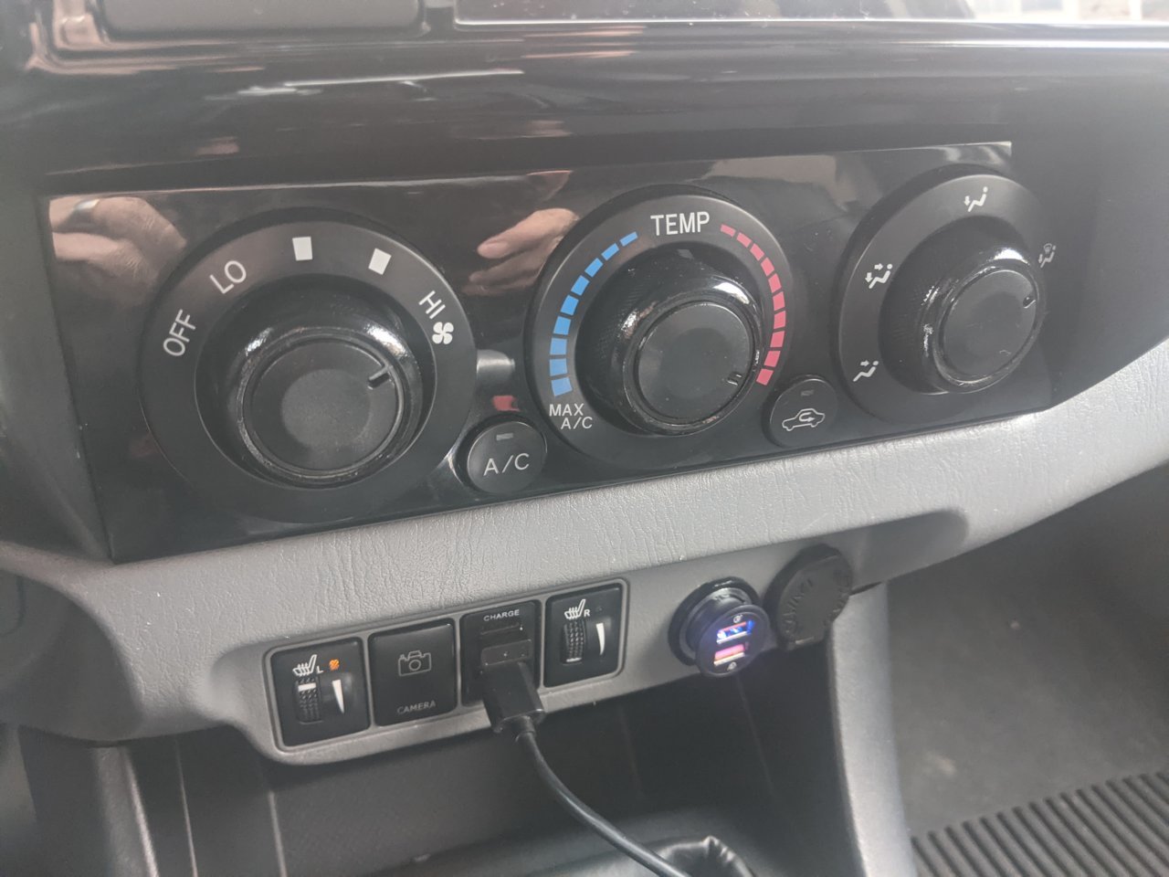

    Took the time to paint the outside (not the lit up circle outline or the middle) black after trying to remove the chrome with oven cleaner (didn't work because it's an actual thin strip of shiny metal).
    Waaaay happier with how it looks. I like these knobs better than the stock ones but never loved the chrome strip. Made the middle part of the dash look way cleaner. Just wish these could be bought in black and hoping the paint holds up.
