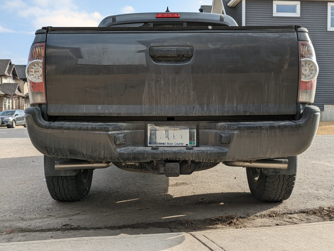

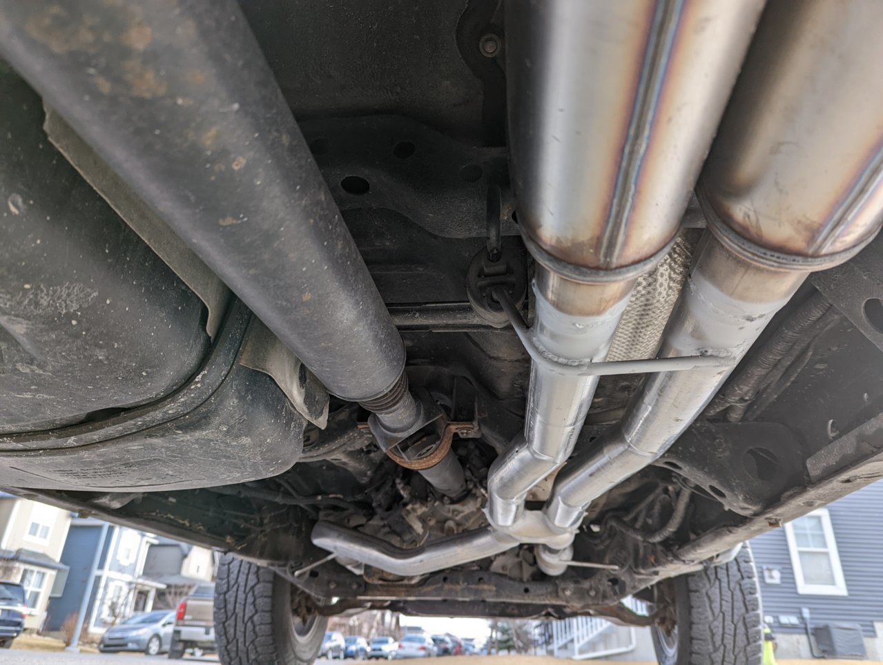

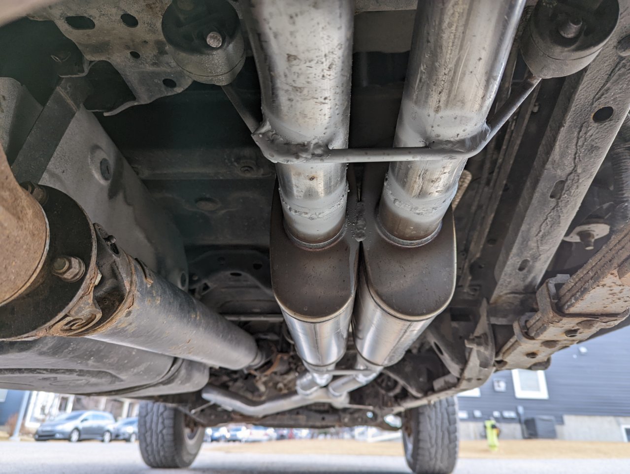

    Not the best pics cause I nearly broke my ankle last week and truck is dirty AF and I forgot to take pics when truck was on lift but...full dual exhaust with two resonators, no cats (cause I cheaped out and people steal shit anyways), two Magnaflow mufflers of some sort, a x-pipe, one pipe out passenger side one out driver side. 2 1/2" piping. Followed @12TRDTacoma 's lead on this one.
    Have to take logs and get retuned (have FIC injectors on the way as well) but haven't had time. Truck sounds way deeper and throttle response seems better. Noisier auto start so may piss off neighbors a bit in mornings but they all piss me off anyways. Overall noise level isn't too crazy and haven't noticed any drone. Pretty happy with it so far but some of the welds and fab work could have been better at the header end where the resonators are. Also may get some fancy tips but there was nothing available that wasn't completely obnoxious at the moment.

    Hell yeah, looks good Russ! We’re gonna need some sound clips..

    So far the sound is growing on me. Wifey hasn't noticed the completely different and slightly louder sound on startup hahaha. Throttle is more responsive, etc. Will do up a proper video at some point (need to find a good underpass and someone to film)

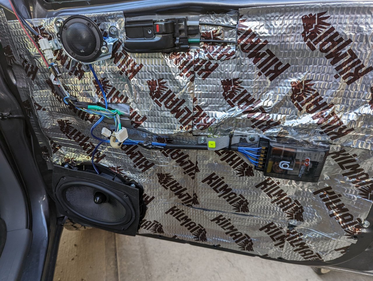

    Just installed some CDT Audio Unity 8.0 PLUS 2” wideband drivers, replacing the stock tweeters, CL-69 SUBCF 6x9's with baffles, and U-500 Crossovers for the wideband speakers. Driven by the Joying head unit.
    Very happy with the sound. The CL-69's provide a good thump and work more like a sub with this setup while the widebands take care of the mids and highs and are now positioned at a better listening level. Provides enough bass for my needs that I don't feel the need for an amp or dedicated subwoofer. Really happy with the sound quality.

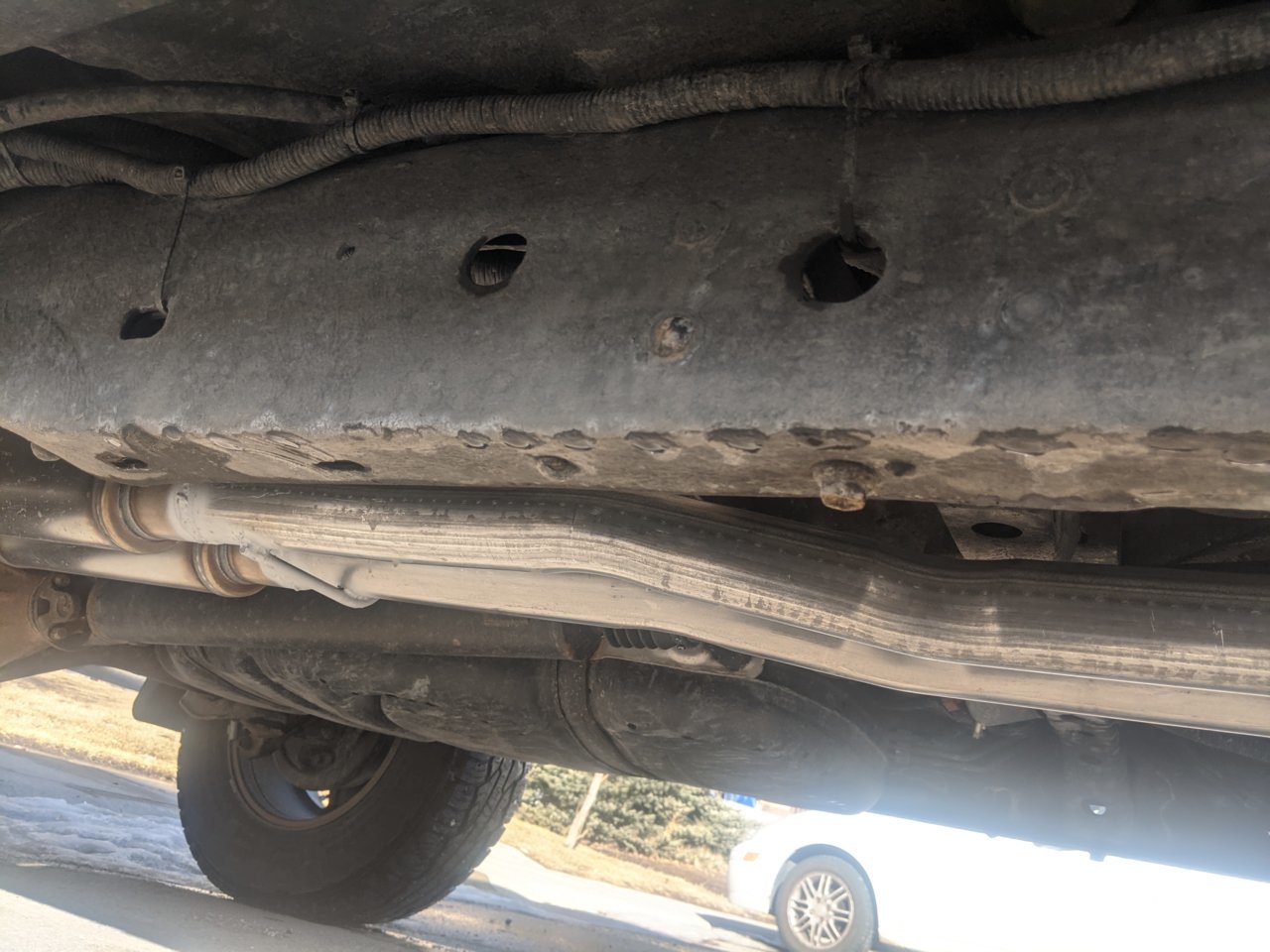

    I don't feel so bad about my welds now. Actually I do still, but eh. What can you do....
