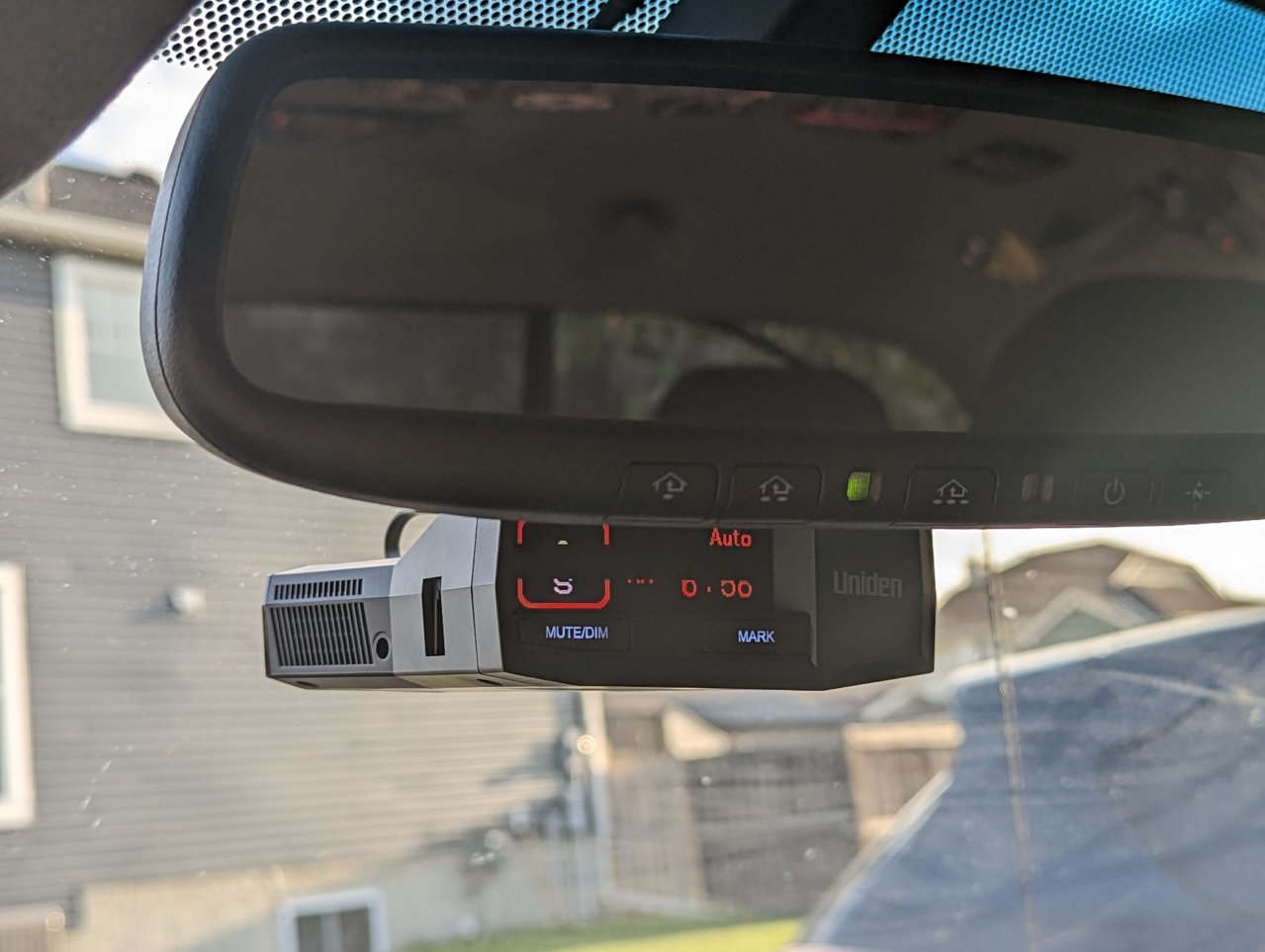

    Installed a Blendmount (radar Detector mount) with a mirror tap kit so the detector powers on with the truck. Kinda pricey for what it is but the mount is well made.
    The detector does pick up photo radar and traffic lights in the city and it's potentially saved me from at least three different tickets so far. I tell my wife it's paying for itself Hahaha.

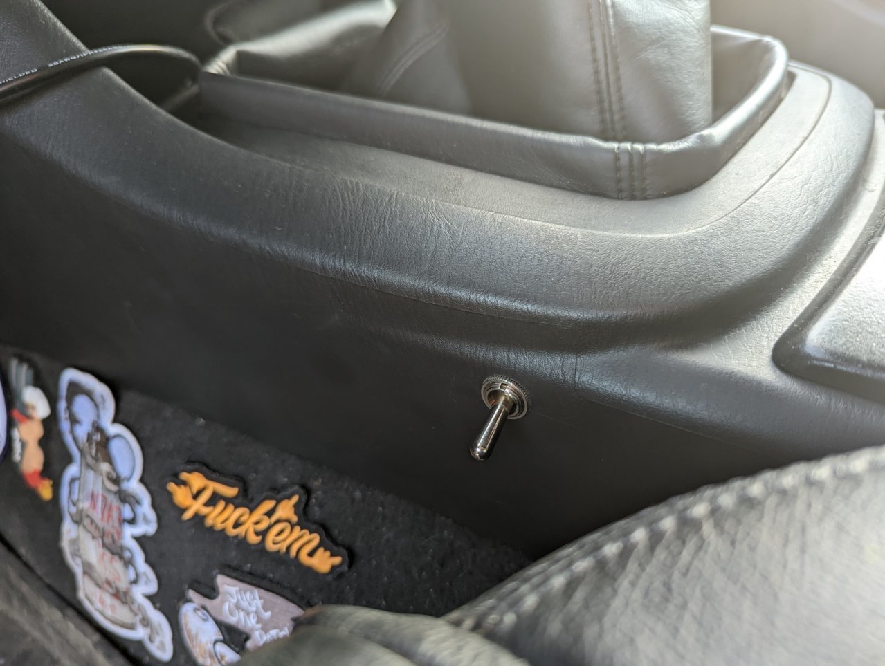

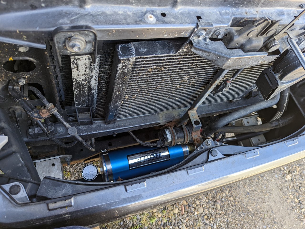

    Also installed a Canton Accusump, wired using an ignition controlled time delay relay to pre-lube the engine with oil during start up. Did this mainly so I can remote start in the winter and have the pump pre-lube the engine without having to physically be in the truck.
    Have a kill switch by the seat/shifter to easily disable it if I'm turning the truck on and off frequently.
    Had to drill and tap the Canton oil filter sandwich adaptor 1/8" NPT so I could mount my oil pressure sensor as well since I removed the old adaptor for this one that has a bigger 1/2" NPT tap for the accusump line.
    Canton Accusump mounted behind front bumper.

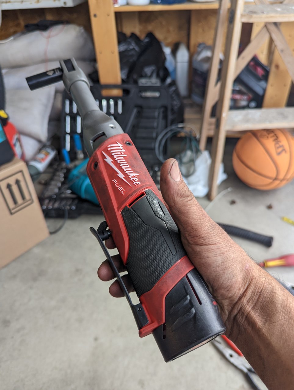

    Also, bought this a couple months back on a friend's recommendation, Milwaukee 1/4" extended reach electric ratchet and modified it to be 3/8" instead. It's got a slightly smaller head than the actual 3/8" model (slightly less torque too) and its been a great tool to use. Occasionally hard to fit in places but when it does it makes things so much faster. You tighten/loosen using your hands like a normal ratchet but the spinning nuts off part is so much faster and less tedious. Even the small battery seems to last a decent amount of time.
    My MVP tool

    I love it so far. It's always beeping everywhere I drive though, which could drive a guy nuts. And this detector filters out a ton of false signals too.
    It gives a bit of peace of mind when you decide to get playful.

    Do you find it also seems to detect radar systems that are on-board cop vehicles? My old radar detector seemed to detect such systems.
    TodayWasTHeDaY[OP] likes this.

    Twice it's saved me from cops that have been driving in the opposite lane and radaring traffic as they roll. It's given me advance notice on two cops sitting by the side of the road/hwy with the radar gun out as well. Gotten those warnings 8-10 km before seeing the cop. Ka band signals are the ones to really pay attention to. Lots of K band out there from other sources but can sometimes be cops.
    It detects laser signals too but apparently if you get lasered and detect it you've pretty much got a ticket. There's no advance warning. Don't know how much laser is around but my detector has picked up signals that I don't think were cops. Laser jammers are a thing for $$$.

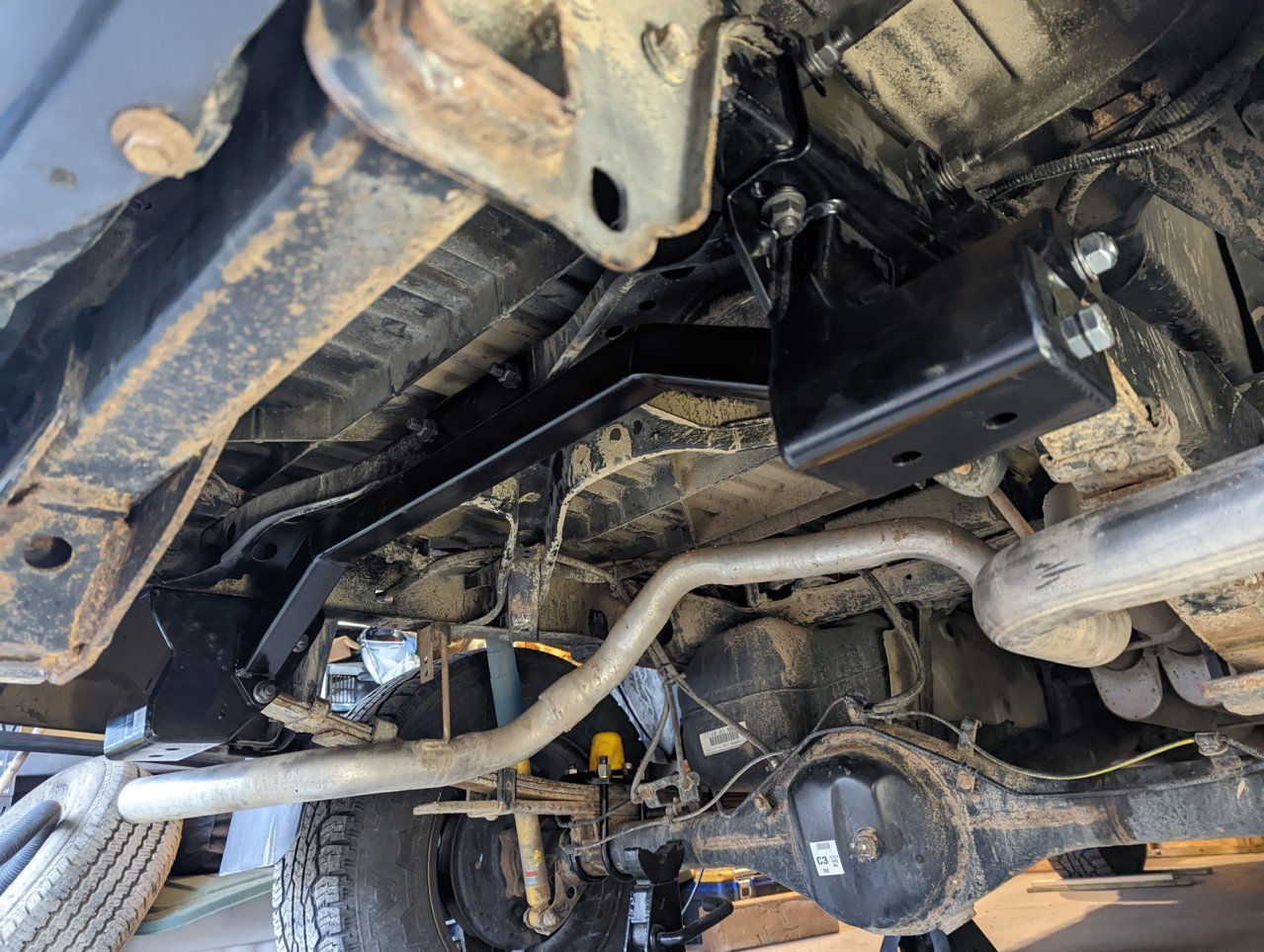

    Finally installed Archive Garage hammer hangers, cross brace and rear bump stops that have been sitting in my garage for two months. Only one drive so far and noticed a difference on the expansion joints of a curved bridge that normally kind of micro kicks the trucks ass end to the side. Things are beefy and nicely built. Removed the now unused spare tire hanger while I was there.
    Also the spare had some signs of heat damage with the way the dual exhaust was so tight in there so it's better it's gone now.

    I've had Caltracs on my radar for a year or two now but don't have seem to have wheel hop with my cheap leaf spring clamps. May have to do a good 2wd launch and see how she does.
    So far the back end does feel a little more planted and stable and I'll just throw the spare in the box if I go out of town.
