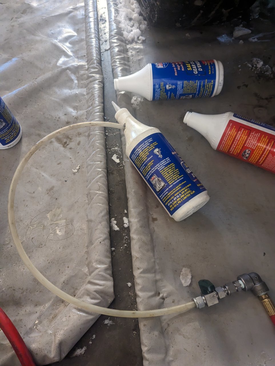

    So I've just gotten over a stubborn cold for the last two weeks and been freezing my ass off at work and life. Recently bought a new toolbox workbench to replace my wooden workbench and organize my tools properly for the first time in my life so spent a day a couple weeks ago disassembling all the old stuff. Pics to come eventually.
    Garage is still messy enough I couldn't fit my truck so I visited my brothers heated garage to finally change my diff fluids since they are broken in. Alas, heated garage meant snow and ice on the truck dripping everywhere lol.
    Used an air compressor and drilled a hole for pressurized tubing to the bottom of a bottle and used that to inject the diff fluid and it worked really well compared to the usual struggles. It made awesome queefing noises until I learned to tilt the bottle so the fluid is at the exit nozzle and it worked swell. Was tricky holding slippery tubing to the nozzle for the front diff so I'm going to rig up a compression fitting and flexible tubing to the nozzle next time so it's not a worry.
    Rear diff I just had the nozzle right into the diff without tubing since I don't have a spare tire under the truck and had lots of room to work.

    Glad to know that I'm not the only one that LOL when the gear oil bottle queefs and farts!

    Seems like a great method. I do like my electric pumps, but they always end up being a consumable ($25 every few oil changes).

    Cheap pumps that die or you need a rebuild kit often?
