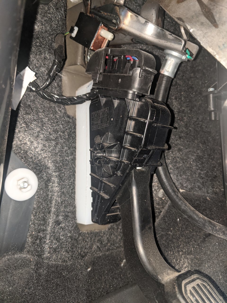

    The Gas Pedal Spacer
    I've been asked about this a few times so here's the details. In my opinion, one of the best mods ever for manual lovers. Makes it so the gas pedal is roughly even with the brake pedal. Heel-toe shifting becomes possible.
    There was a thread with a guy selling gas pedal spacers a couple years back but I contacted him and had no response via pm or in thread.
    Solution: Pulled my gas pedal out, traced the outline of the base and mounting holes onto paper and took that to a plastic shop. Plastic shop made me the spacer out of some sort of 3/4" block of tough, non flexy plastic. Found longer bolts at home depot. Bam. Done.
    Gas pedal spacer (white but normally unnoticeable)
