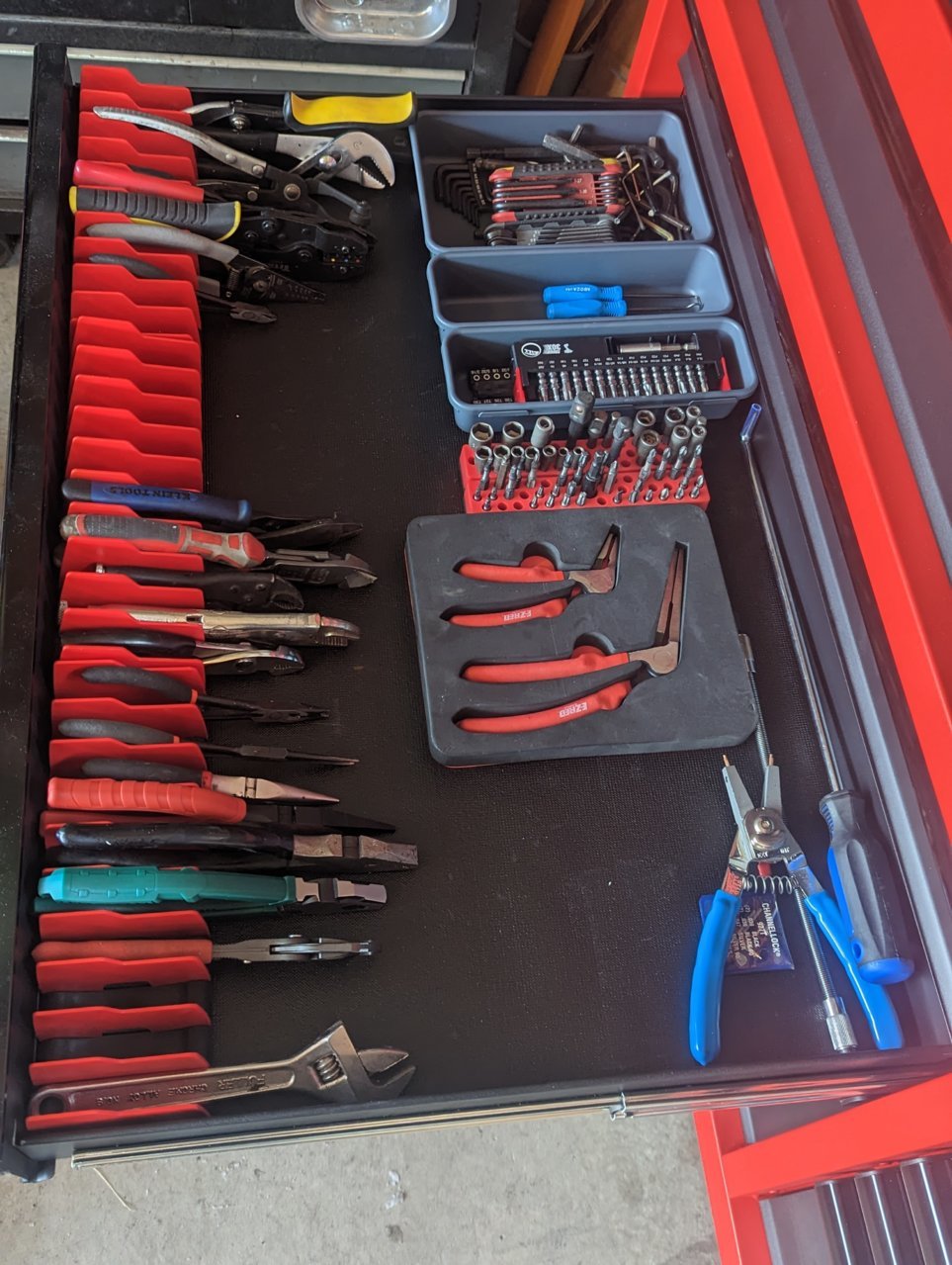

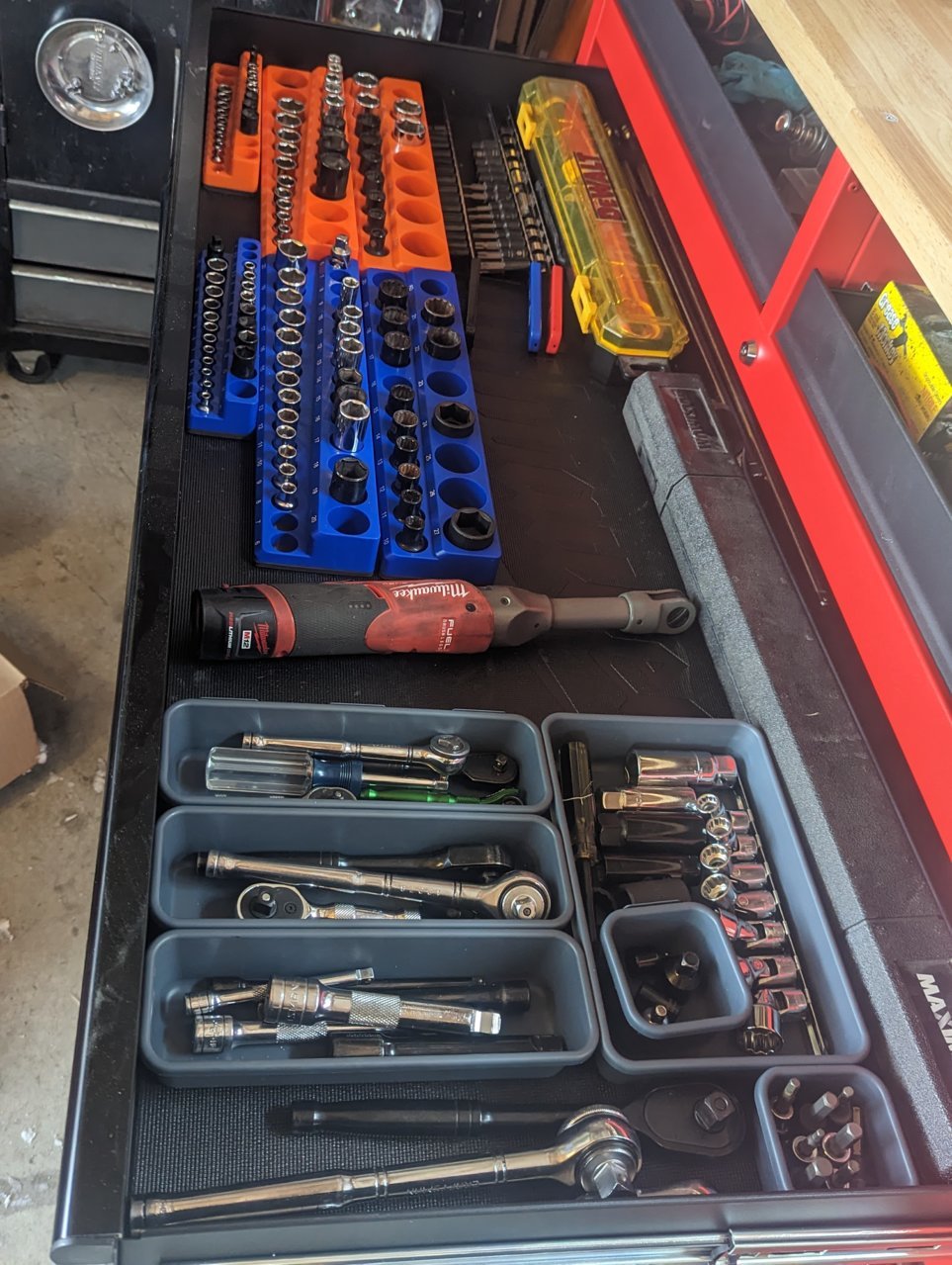

    Also, pics of the new toolbox. Went with Milwaukee even though it cost more because it's the only workbench toolbox with a raised top that you can clamp things to. Managed to get new years pricing of $100 off because they forgot to update the in store price tag and signed up for a home depot credit card to get another $100 off. Probably just cancel the credit card later as I've had one before that got cancelled due to not using it.
    Also, it's on wheels so I can move the box around the garage as needed for whatever reasons. I had a larger wooden workbench before that took up too much space and wasn't really that organized. So stoked to have organized tools for the first time in my life, especially sockets as I had two portable cases that were a pain in the ass whenever I was grabbing stuff.

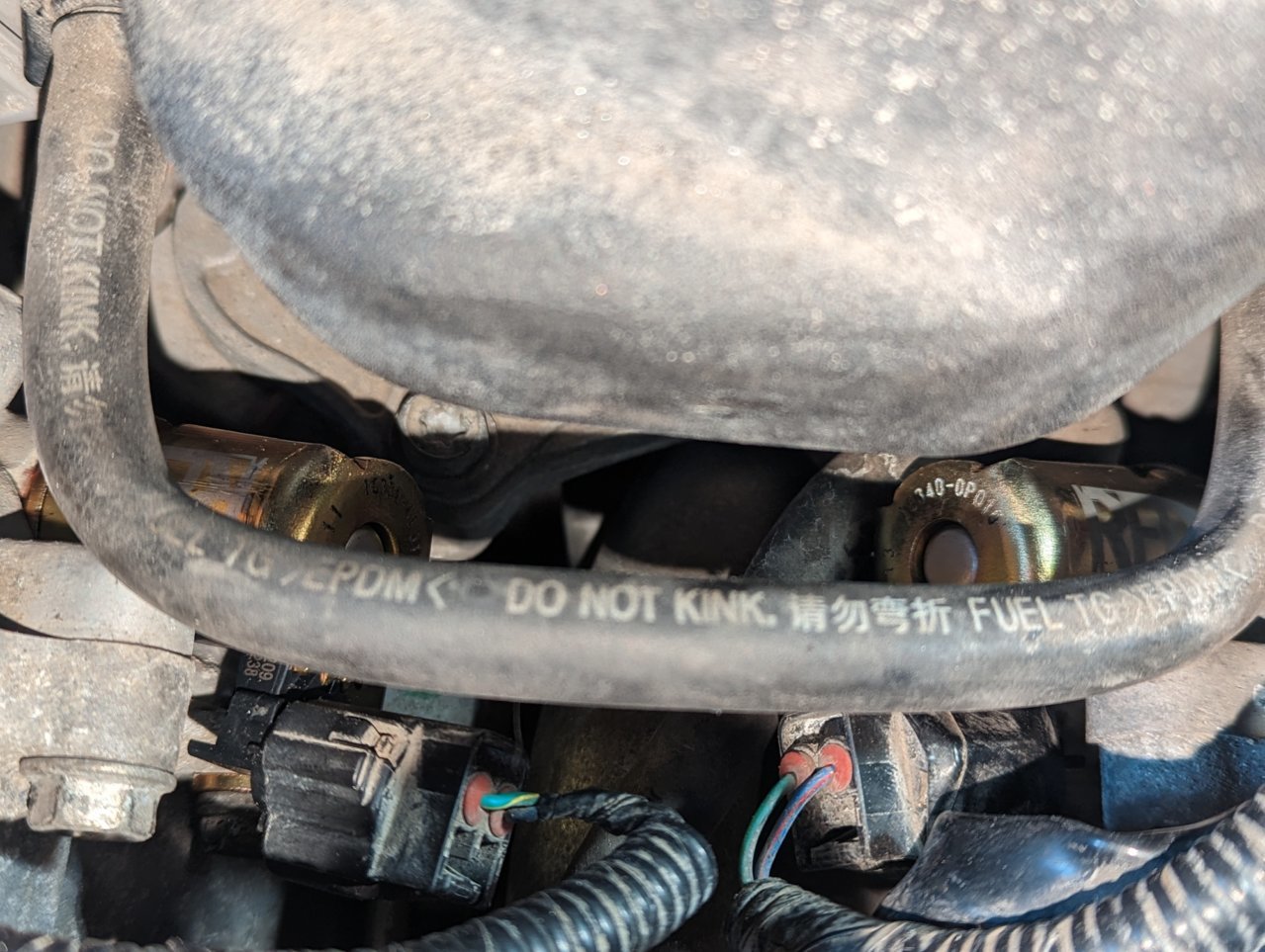

    Also, I'm not sure if I'm holding off on the radiator until after cams as it might be nice to rip all that out for accessibility for the cam install then install once that's done. Thoughts @Athlaos? Would it help or not really?
    The solonoids sound like a quick job so sometime soon. I do want to remove the filters as well if possible to have a look at and/or clean them. Are the filters as accessible as the solonoids @SUMOTNK? I haven't looked into that info yet.

    Dont quote me on this, but I believe the OCV filters are right near these solenoids so yes, it would be 2 birds 1 stone with this install. I didnt do my filters so I can't confirm location.
    Its not a necessity, and I've never needed to remove it for my install, but there is a lot more room if you remove the throttle body for the R/R of the vvti solenoids.

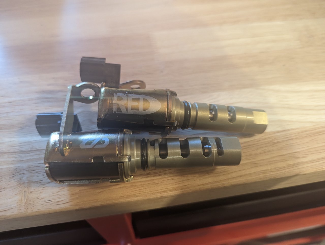

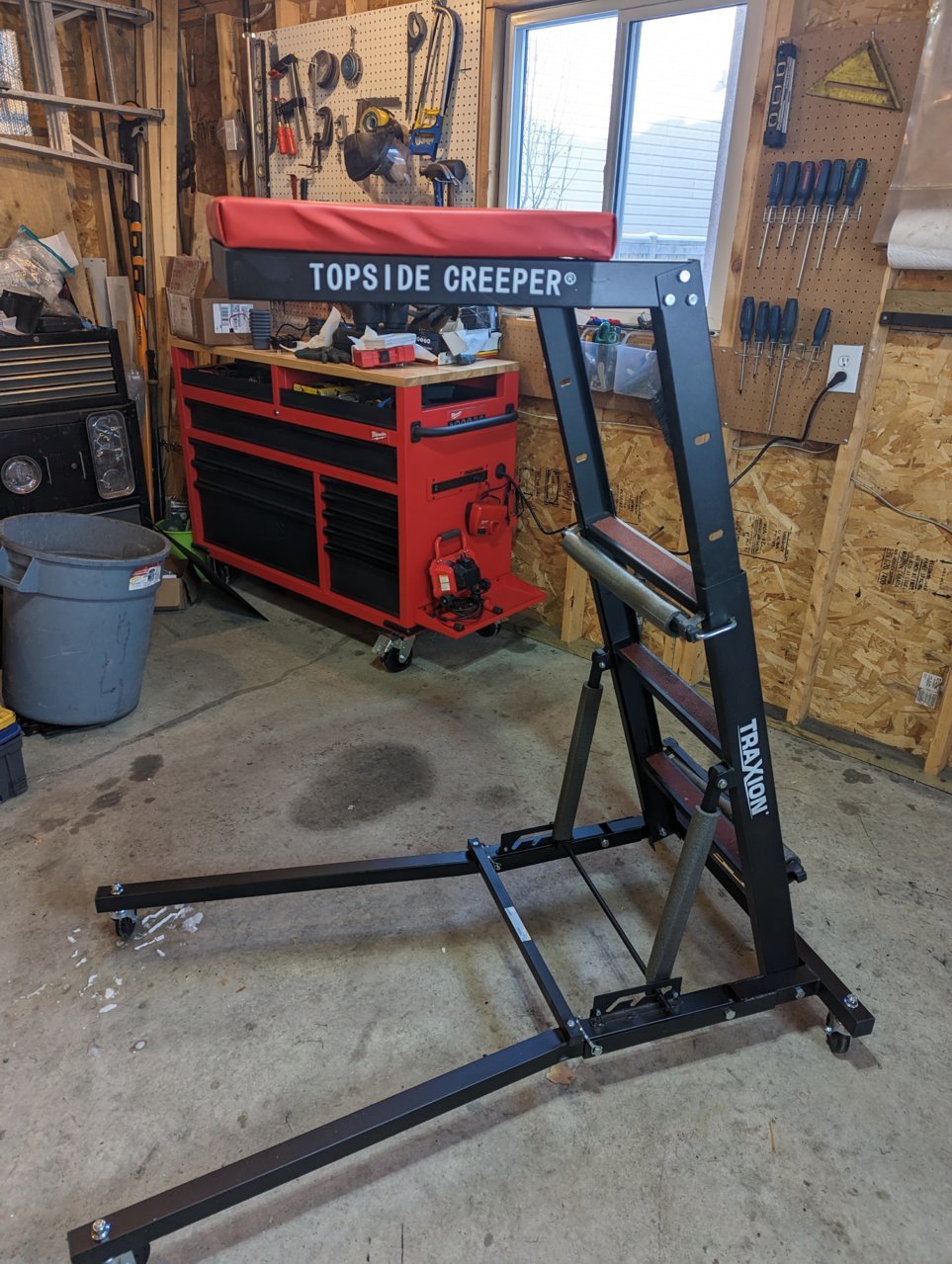

    Used this bad boy,
    To install these little golden red bullet solenoids,
    Haven't been able to test under spirited driving because I haven't had time to troubleshoot my possible fueling issue yet. It does drive like normal when driving normally lol.
    Definitely digging the topside creeper, it was handy for sure. Also bought one of those steps that hangs of the tire, which could also be very handy.

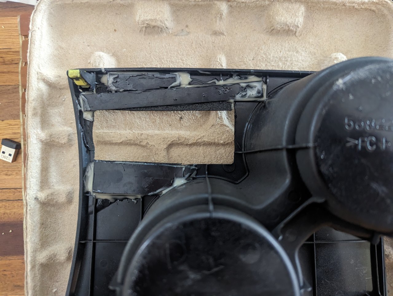

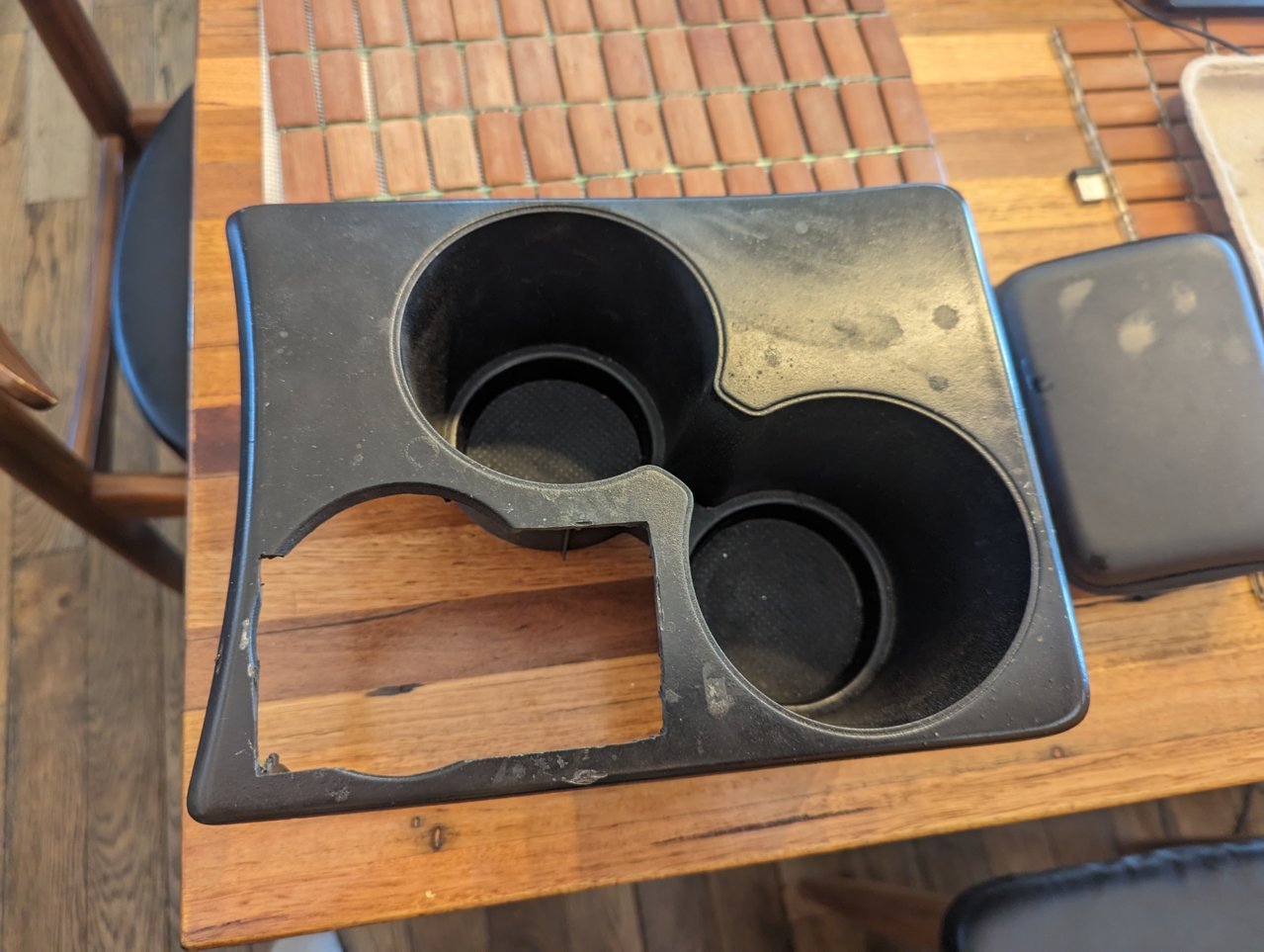

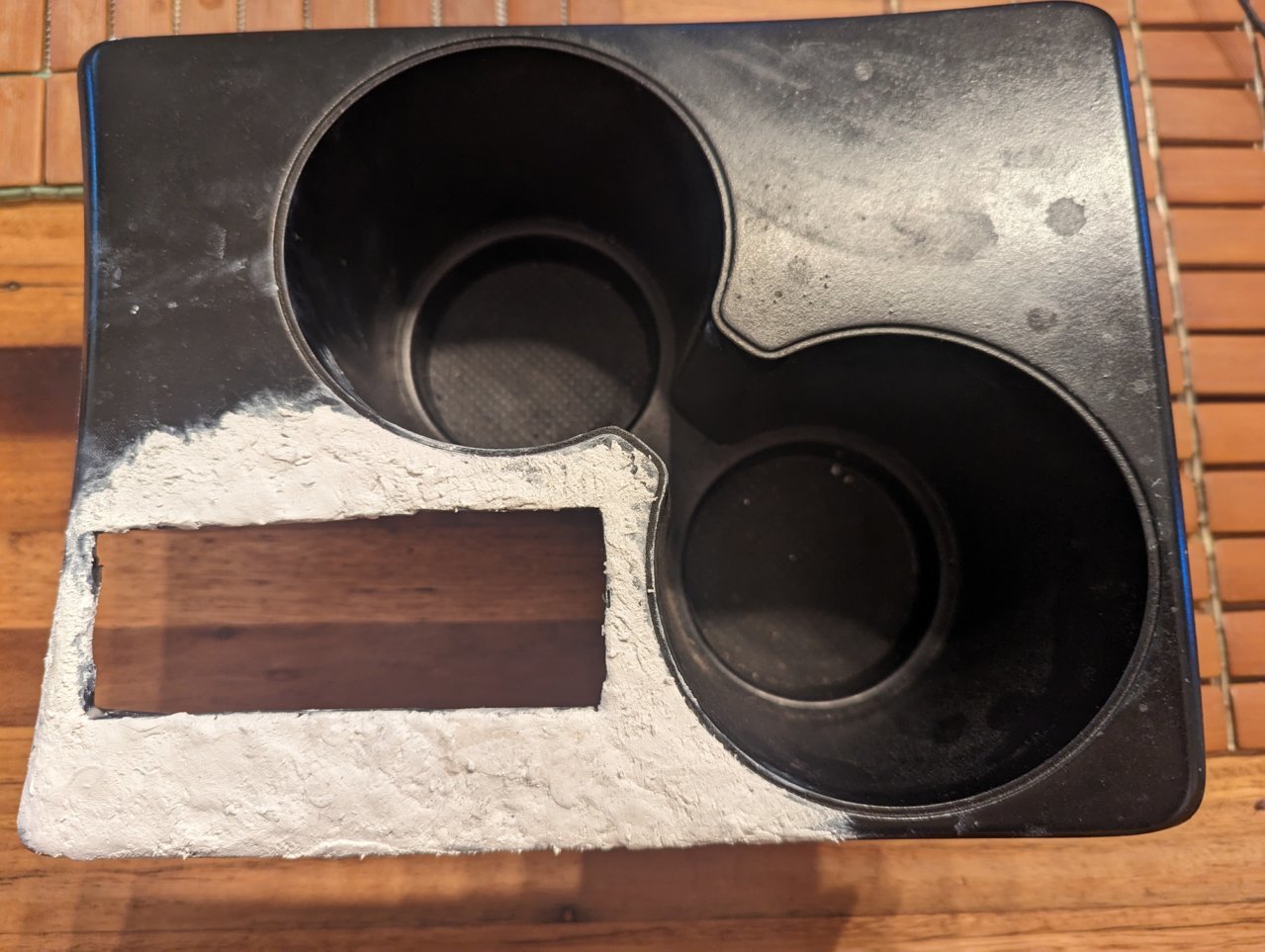

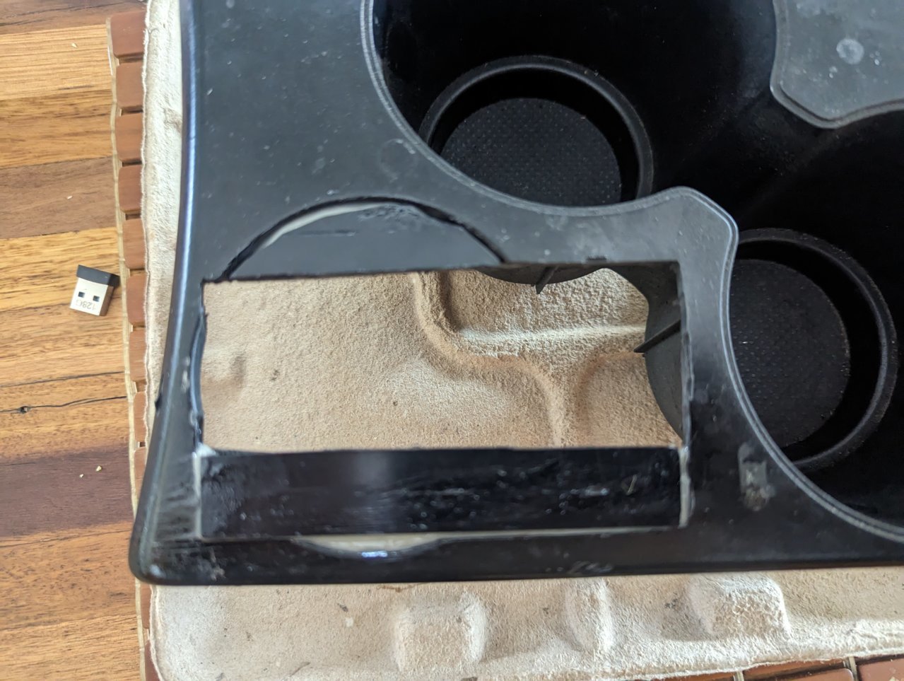

    My cup holder has been MIA for some time after I cut a hole in it for switches so I finally did some plastic epoxy patching.
    Had to epoxy some support pieces underneath to put plastic on an open spot I had cut and then decided to move the switches. Also, part of a round cup holder hole that needed patching.
    Then covering with an epoxy putty and trying to contour and sand it so it blends well and doesn't look like a shit drywall job once painted. Still more patching and sanding to do. No sanding done on this pic.

    What's the plan for what your switches will be doing?

    Seriously though, probably just one switch for an electric fan and the rest blank for now. Not sure if I want my two fans wired to the same switch or one tied into the heater controls.
