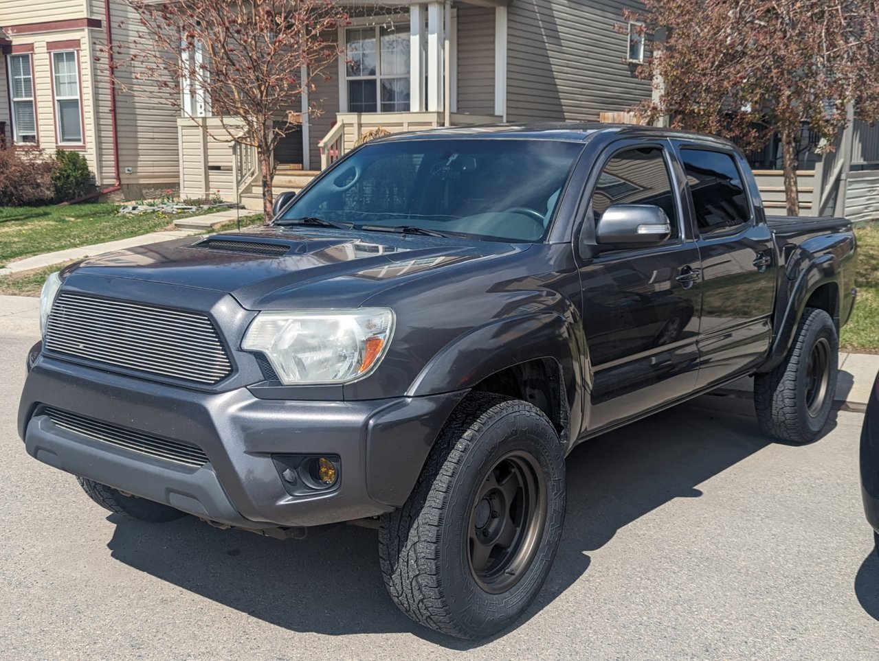

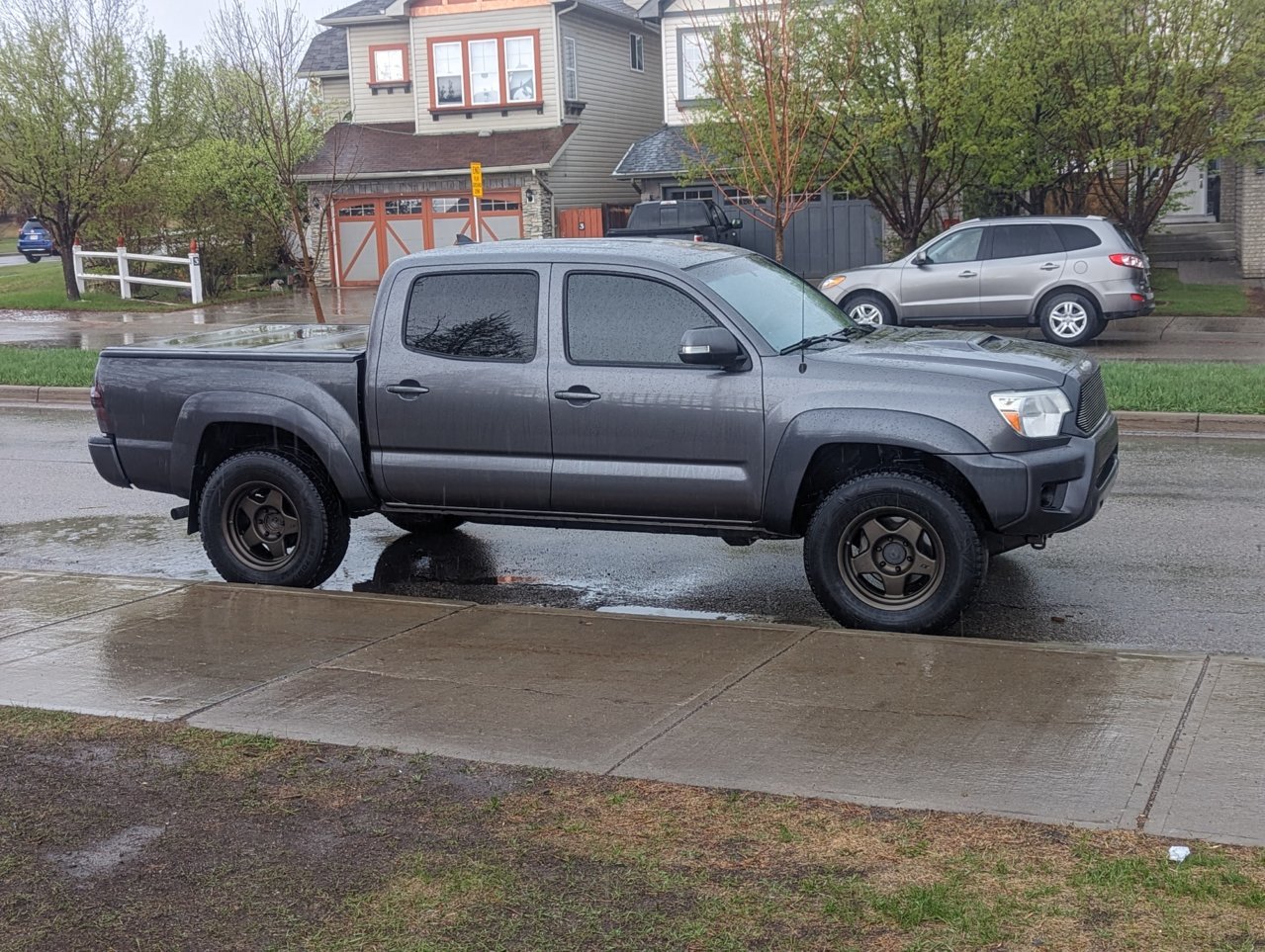

    All side and rear windows are now 20% tinted with XPEL-ST ceramic tint. Also had medium smoke film applied to the rear tail lights and rear cab brake light. The lights look waaaaay better to me and I'm liking them a lot more than I expected to. Quick, not very good pics taken a half hour before a rainstorm and one after.
    XPEL-ST 20% ceramic tint and medium smoke tail light/brake light tint
    BassAckwards, Athlaos and SUMOTNK like this.

    Nice, looks great.

    Thanks, I'm pretty happy with it. Just need to get my lift in and I'll be really happy with the overall asthetics.

    Yeah Russ.. your truck is looking terrific!
