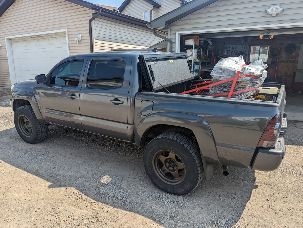

    Also, Annie (wife) is on to me. She saw my engine hoist I recently picked up sitting in the yard and was like "What's that?"
    Me "what what?"
    "That tall thing outside"
    "it's an engine hoist"
    "What's it do?
    "it hoists engines"
    "I think you better slow down on the tools..."

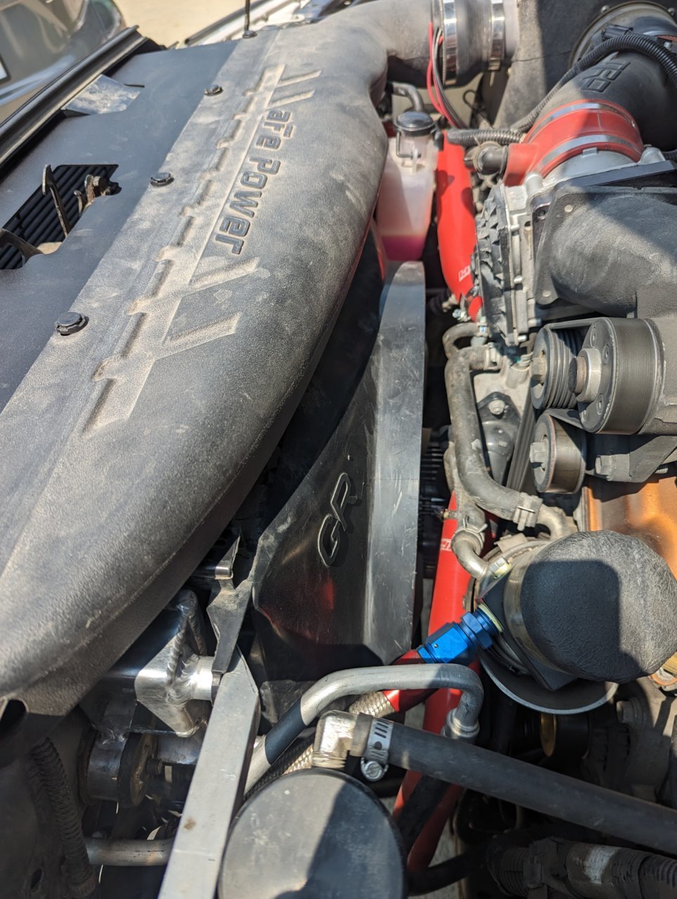

    Well the hard part is done getting the fans mounted. I’ve heard good things about the auto cool guy controllers as well, that’s probably the route I’d go and then try to come up with some custom bracket to jam it in there lol
    You planning an engine swap?:popcorn:

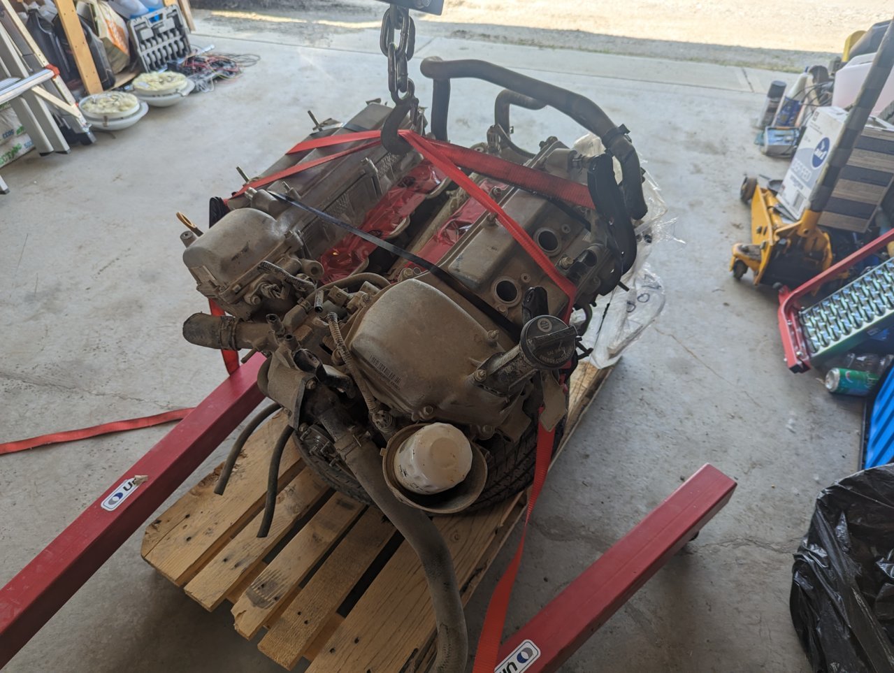

    I've purchased a mostly complete core engine for a pretty good price that I haven't seen yet as it's in another town a couple of hours away. Supposed to be in good shape and it'll be coming soon enough and I'm in no hurry.
    Plan to slowly round up cool, expensive forged parts and goodies, tear down engine, sprinkle some witchcraft and wizardry and swap it someday. None of this is happening in the immediate future though.

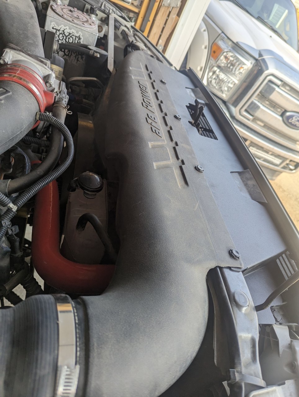

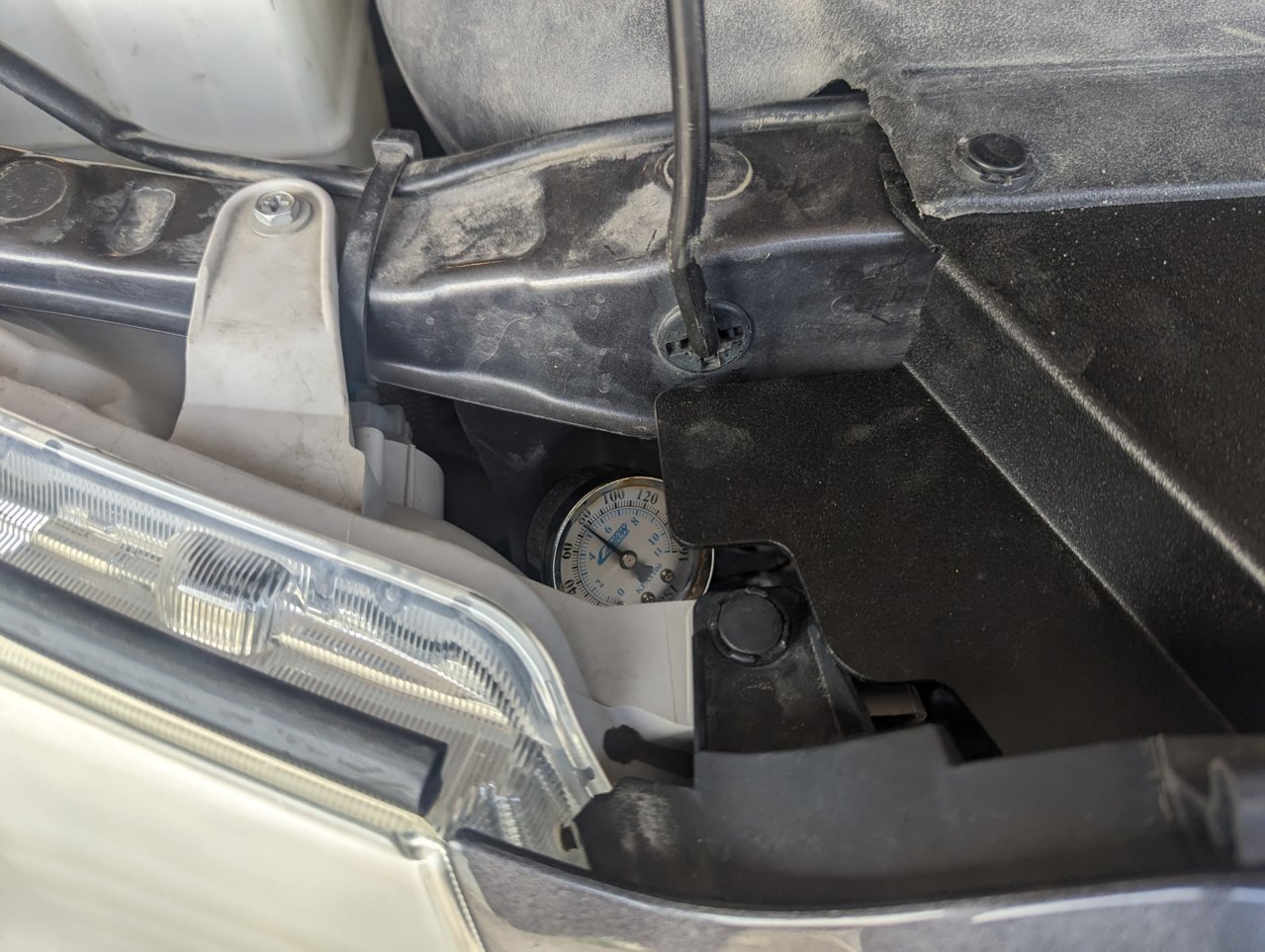

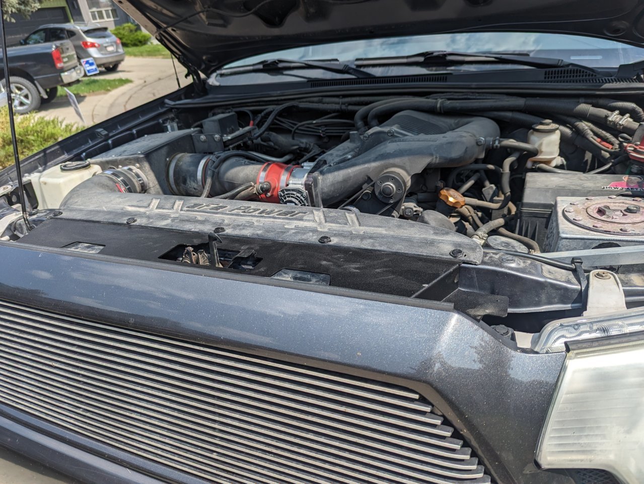

    Wired up the Bussman to the Aux fans and made sure they were spinning in the proper configuration as pusher fans but still have to wire up the in cab switch. Still thinking about an auto cool guy controller for one of the fans.
    Engine bay extra dirty because half my engine splash guards self destructed from age and prior removals.
    BPF panel in place and my hood prop now resides in the cab of the truck and I just pop it into place for when I need a hood prop as the panel doesn't allow it to fold down.
    Accusump gauge peeking out from its hiding spot, gives me a visual indication to make sure it's working properly.

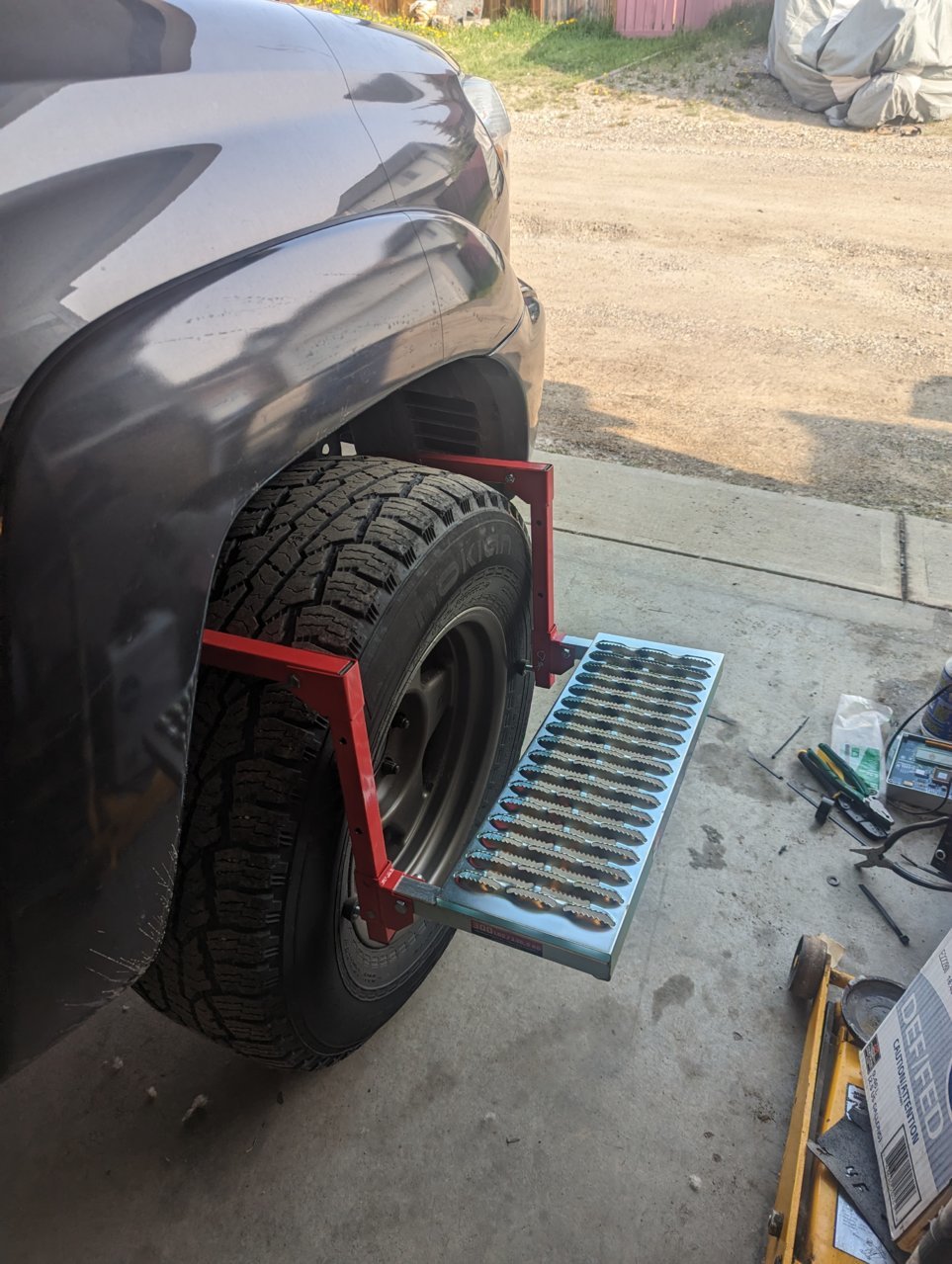

    This thing is pretty handy and I might start keeping it on the truck at all times. Folds up flat when not in use.

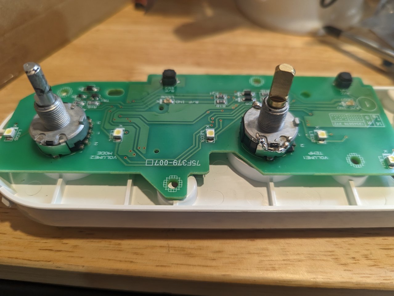

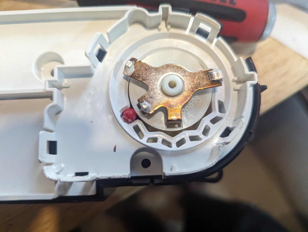

    This morning the potentiometer and knob for my heater temperature control decided to fall out. Tried putting it back in but the tabs that held the pot together snapped when I tried to fold them back into place. Solution was to glob a bunch of solder on the case and top part to hold everything together. Put it all together and it works!
    Funny thing happened with this part, which is the fan speed selector. When I popped the top contact section off I took a pic of what I found. Put it all back together and the rotary switch had no clicks. Took a moment to figure out but it turns out that where the ball is sitting is a little ramp that you shove the ball down to where it actually is supposed to reside to give the rotary switch its detents. It must have popped into the ramp like in the pic when I took everything apart.

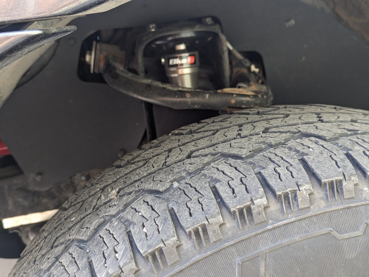

    Also, I'm loving the way the truck is looking with the lift and tint. Only sucky thing with the tint is backing up at night and I had to roll down windows to see out the side mirrors hahaha

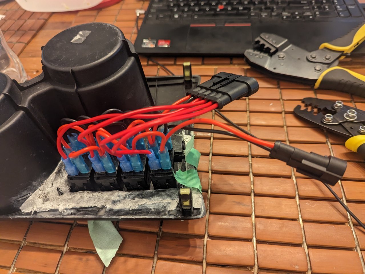

    Just installed some cheap Amazon female weatherproof connectors so I can remove my interior housing around the shifter easily by pulling the cup holders up and then undoing two connectors.
    The six wire connector will have:
    -fused power from the Bussman
    -ground
    -switches 1-4 for whatever accessories I want to use a switch. These switch wires from the female connector are all the same length so I can connect any of the wires (relays) to any particular silly switch I desire.
    The two wire connector will have:
    -dimmer circuit positive and ground wires. I bought an extension harness for those and previously ran the wires to just under the HVAC controls and left them for future use.
    The connector kit had zero instructions and I had to find a YouTube video to figure it out. Female and male pins, female and male connectors, wire seals and weird little orange (pin plates?) made nothing about these connectors intuitive. But they were pretty easy with the video and cheap amazon specialty crimpers meant specifically for these types of connectors.
