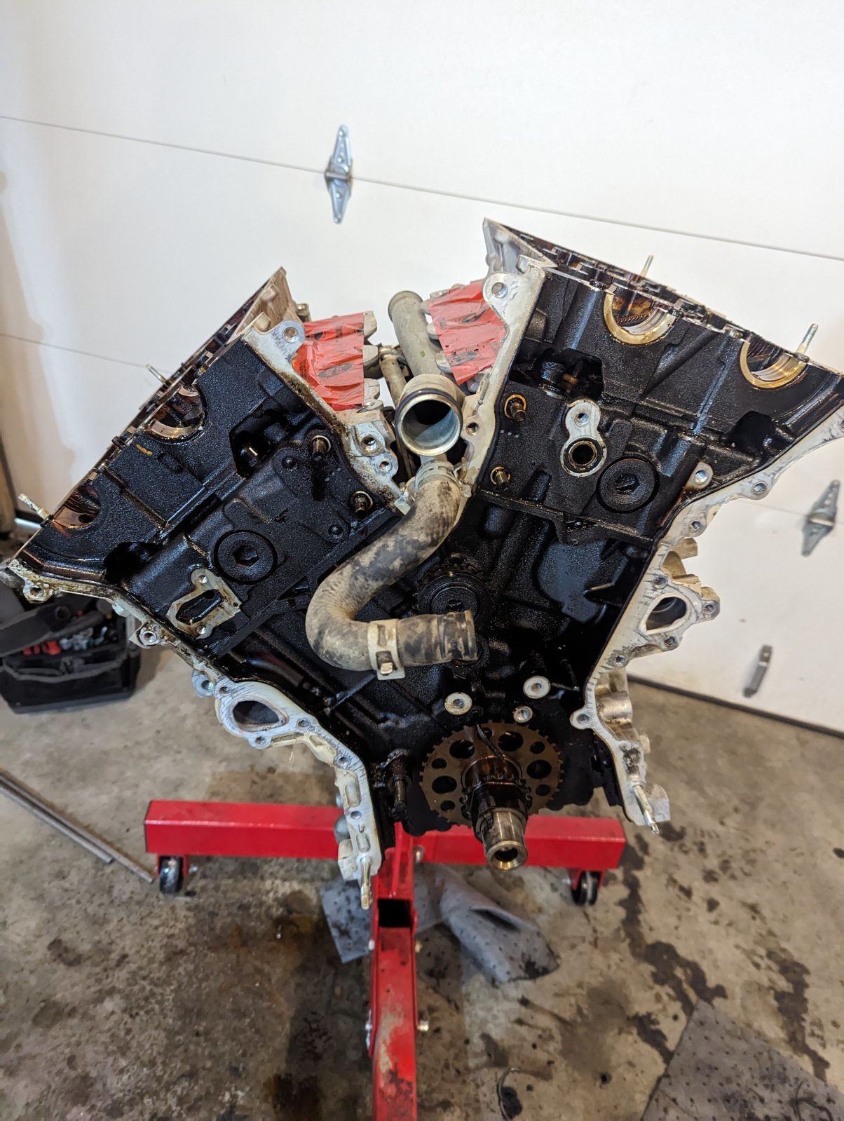

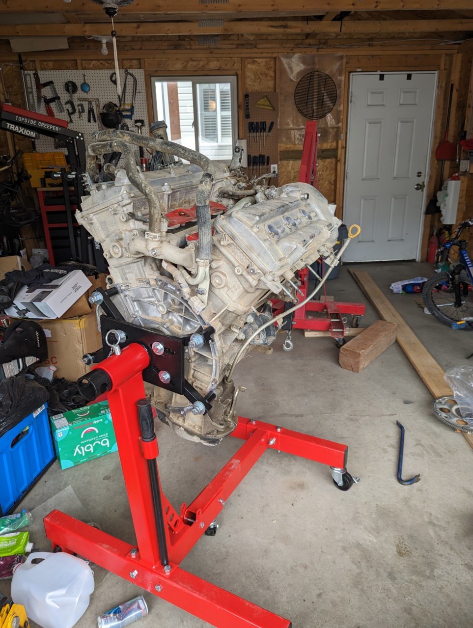

    Got the motor mounted to the stand late Saturday night and wanted to start tearing things down but realized I'm going to need to pressure wash it as there are some good chunks of dirt stuck to it. No visible fluid leaks though.

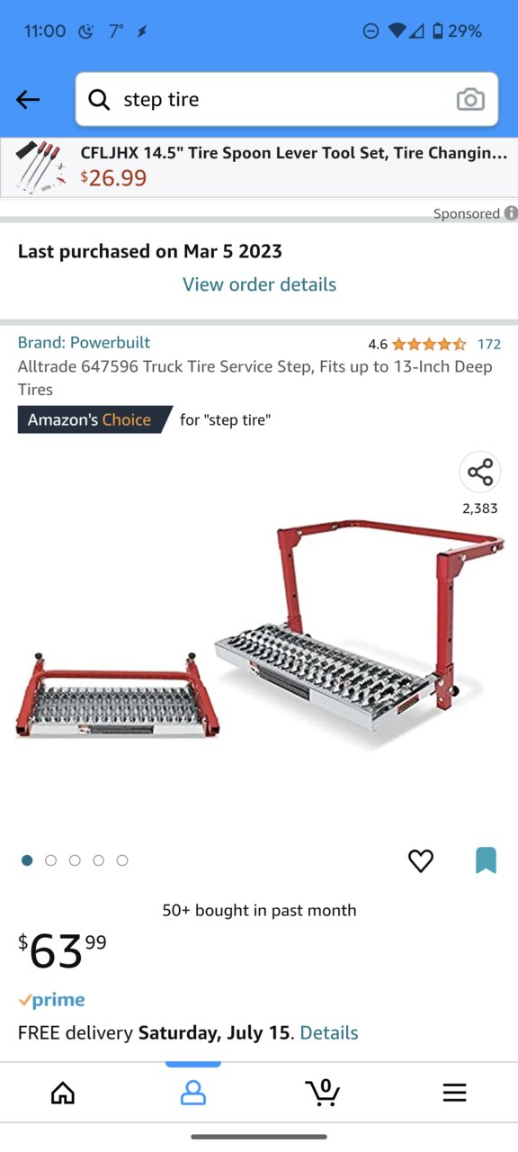

    Bravisimo
    Bravisimo So many mods, very little money.
    Nov 17, 2014
    #142575
    665
    Joe
    Santa Clarita, CA
    2014 Tacoma PreRunner SR5 DCLB
    Tint, headlights wrapped & rear lights smoked, power outlet mod., grill & rear bumper wrapped, Falken A/T 3W,
    Wh
    What is that called and where did you get it?
  3. Jul 11, 2023 at 10:02 PM
    #483
    TodayWasTHeDaY
    TodayWasTHeDaY [OP] Hoser
    Jul 10, 2017
    #223673
    2,060
    Russ
    Calgary
    2015 DCSB SC M/T TRD Sport
    Truck tire step from Canadian Amazon.
    Athlaos and Bravisimo[QUOTED] like this.

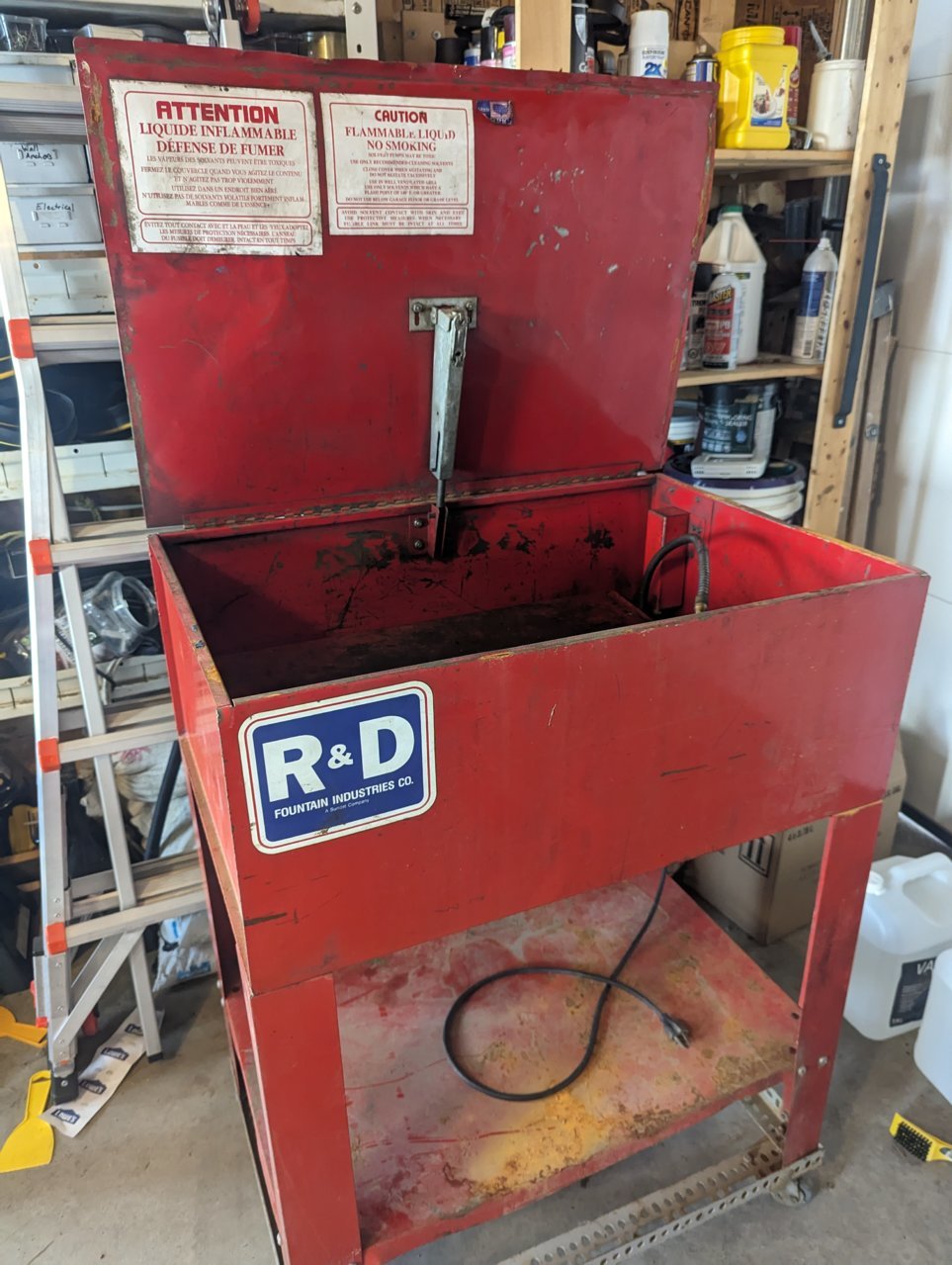

    Not much done on motor project, it's got some serious internal varnish and sludge so I bought a cheap used varsol bath cause I'm gonna need it. Hoping the cam bearing surfaces are not trashed.

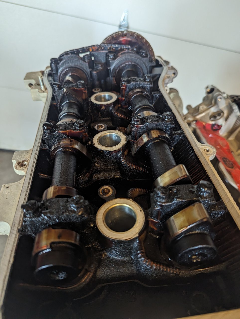

    Motor project was stalled until I got a cheap Amazon tool to help loosen the crank pulley bolt. Pulled off the oil pan, timing cover, chain and tensioner, cams, etc. Broke the old vvti solonoids trying to get the out. Everything is super sludged but think it will clean up well
    Now I'm stuck at removing the heads as the Allen Bolts are very tight and it seems like the heads will strip if I'm not careful. May need a different Allen socket as I have metric and strangely enough I think these are imperial (edit. Upon further research they are 10mm, which I have).
    Will change the oil in wifey's car tomorrow then maybe start soaking parts in the parts washer.
