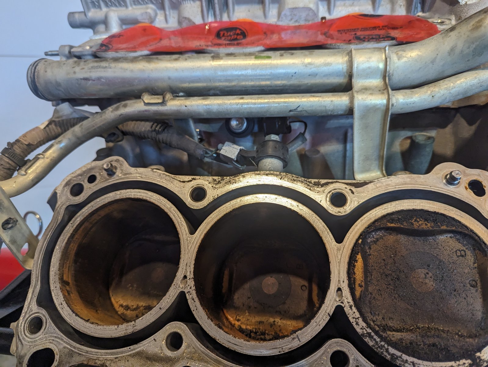

    Drilled two head bolts out to get the passenger side head removed.
    Going to have to do the same on the drivers side as well. Bolts drilled easier than I expected so wasn't too bad. Then a fair amount of using the parts wash will ensue. Blah

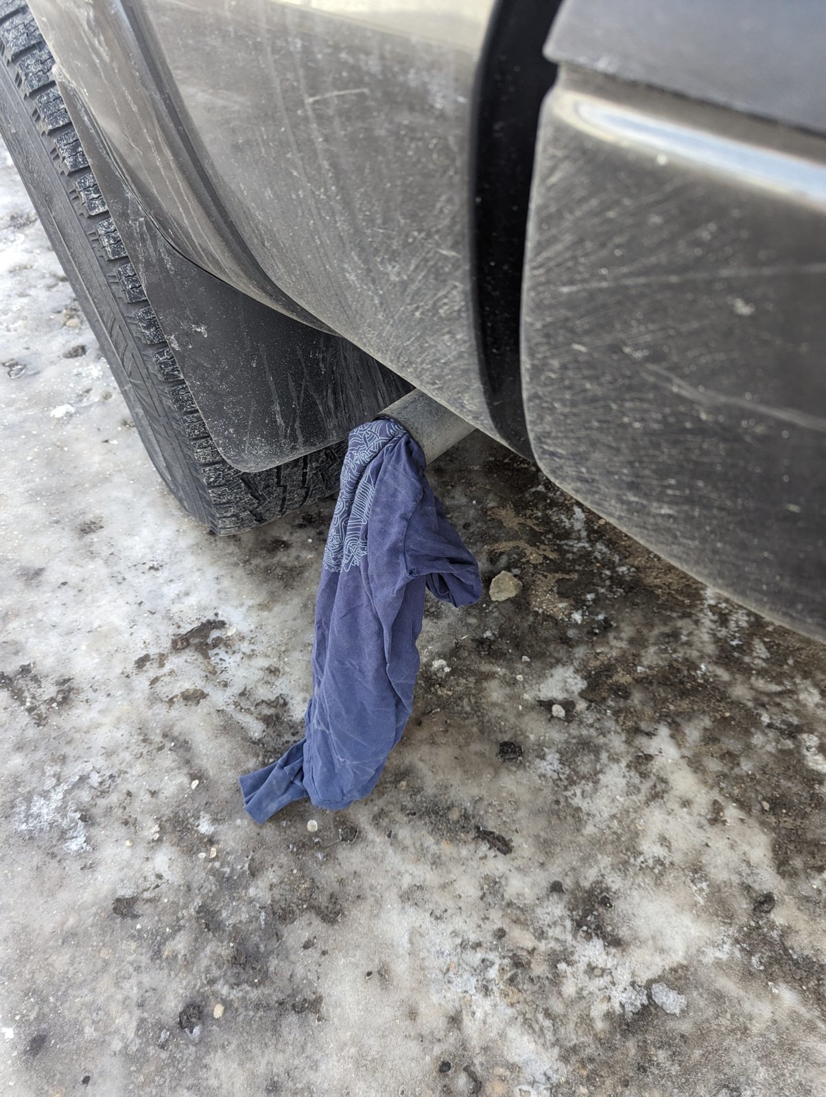

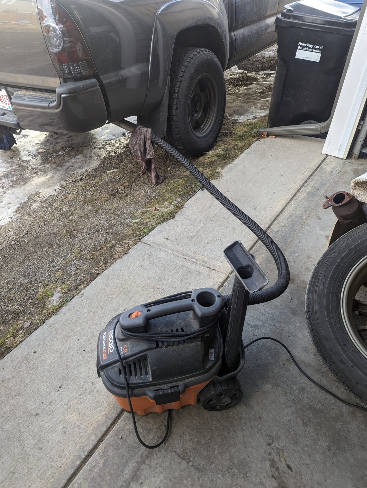

    If you don't vacuum your exhaust is your truck really clean?

    No, my wideband AFR's have been very bouncy for a while now. Truck runs strong and there was no indication of issues with fueling or intake leaks so exhaust leak was the main suspect. Just took me a while to find the spare 15 min and ambition to actually find it.
    Recently replaced the wideband sensor because the original had a slow response time. New sensor ran well until immediately after I replaced my driveshaft u-joint and that's when the issue first popped up.
    Noise level never really changed as far as I could tell.
