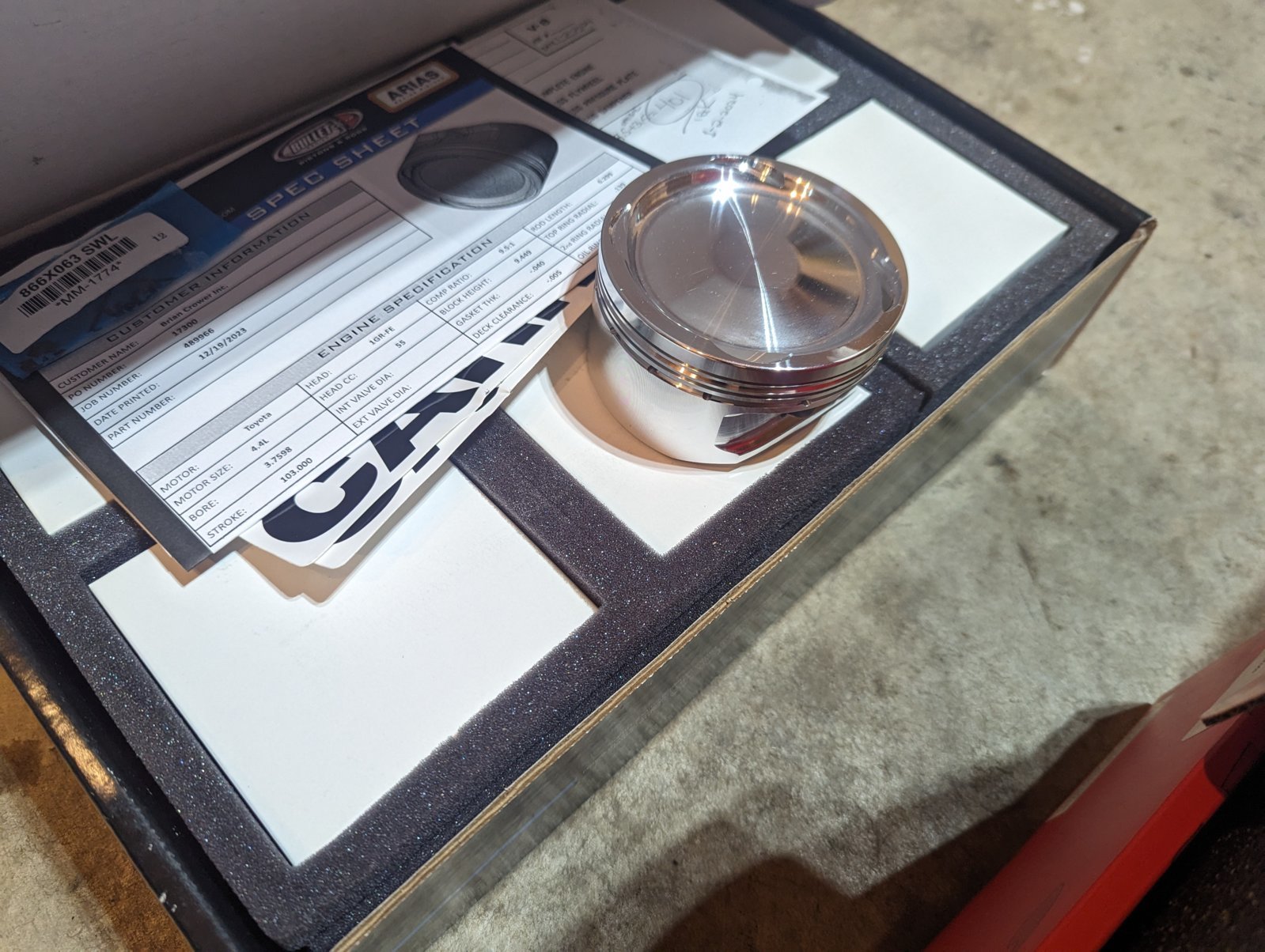

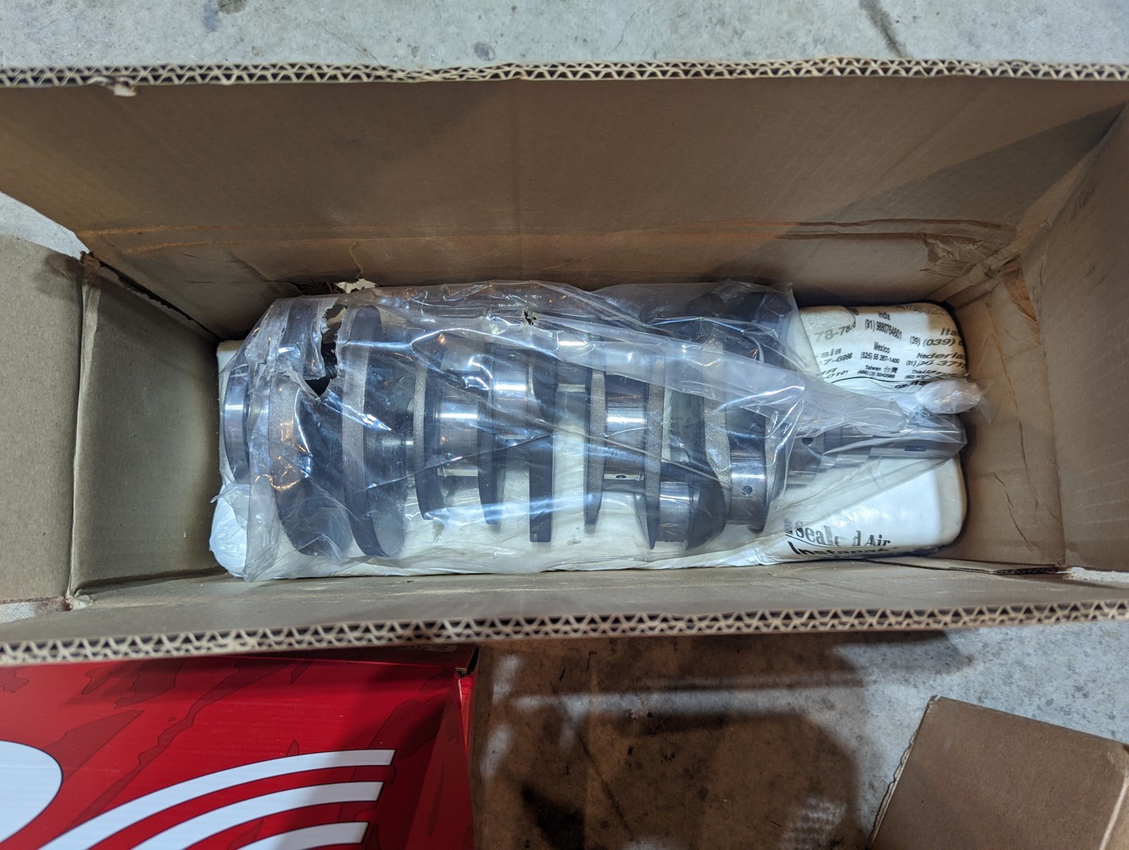

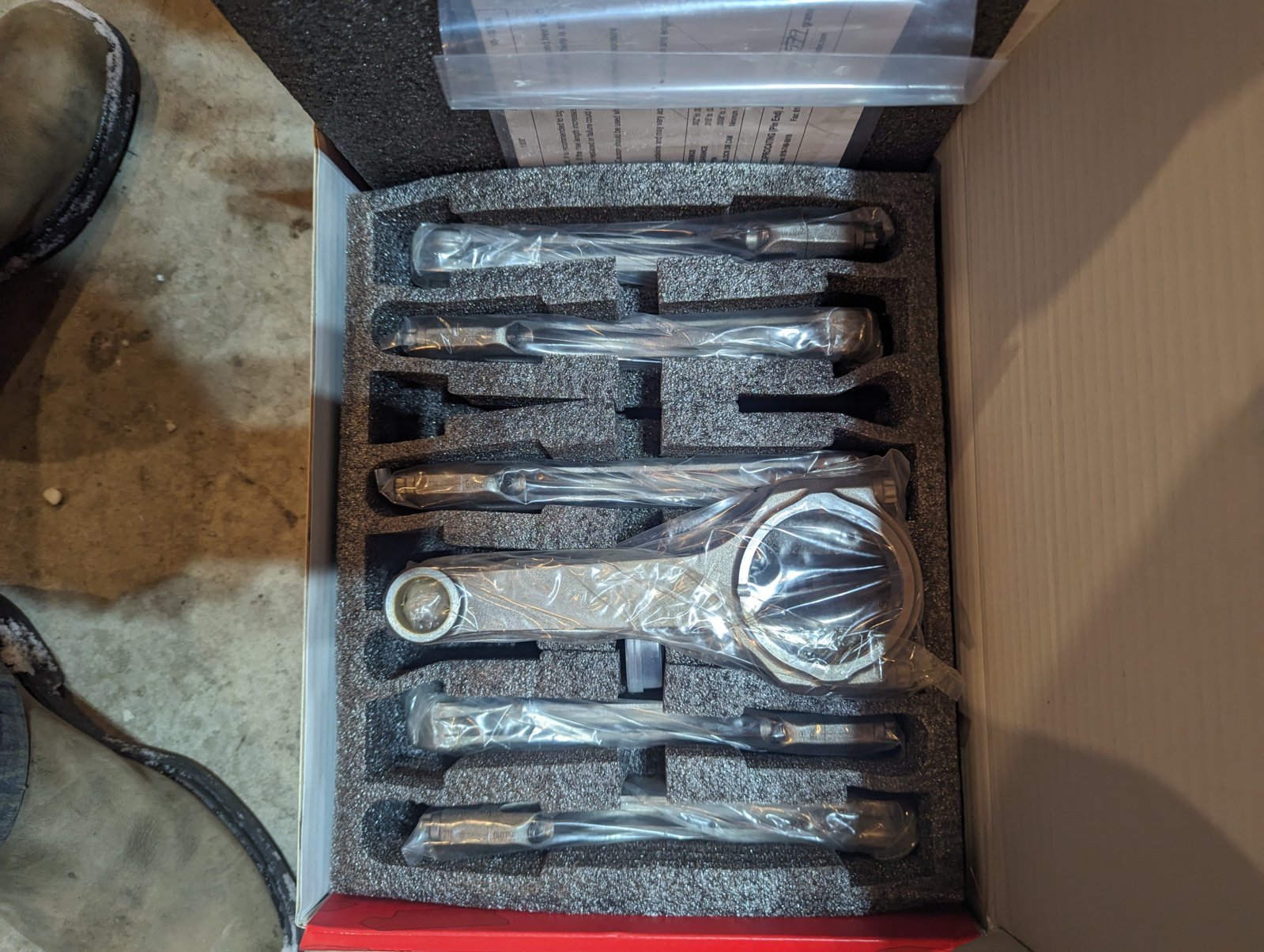

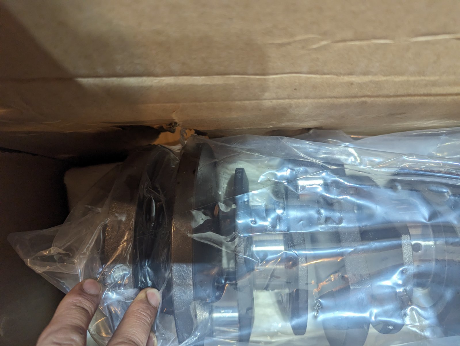

    Removed all valves from head and cleaned as best I could until cold weather started freezing my water based solvent. Pretty much ready to go talk to a machinist soon.
    Also, the Brian Crower stuff arrived so I'll have to contact the shop I was communicating with to get the block shipped for sleeving in the near future.
    SUMOTNK, Athlaos and BassAckwards like this.

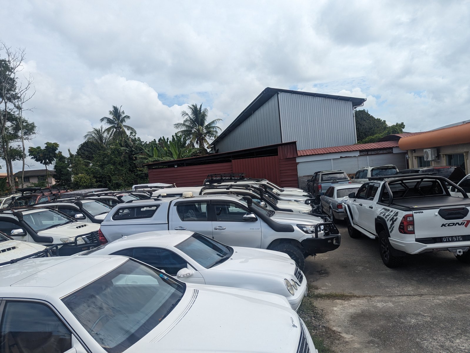

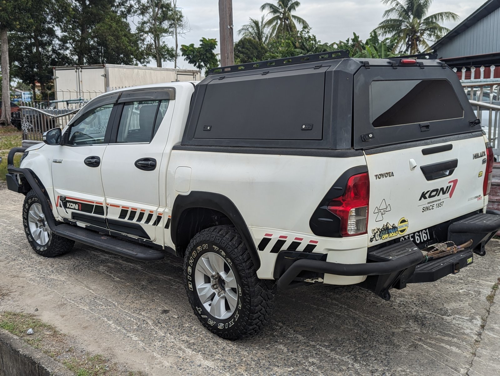

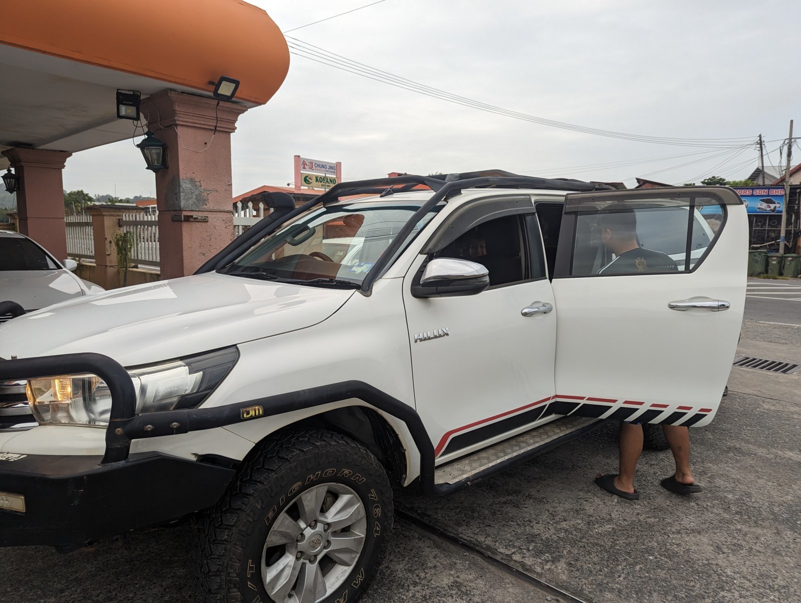

    Just got back from a three week family vacation in Malaysia (where Annie my wifey was born).
    In Miri, where we stayed with family, there was a very high amount of trucks with upgraded bumpers, headache racks and lifts and probably 90% of them were Hiluxes, with the rest being Mitsubishis and Nissans, and Ford Ranger Raptors. Beats out Maui even for the sheer amount of cool rides.
    Uncle owns a business upgrading trucks for offroad and does tours and leases to government and others. There was a dozen decked out hiluxes and Toyota's in his driveway and many many more stashed on spots around town. He probably has 40+ (only what I saw) and a number of other Toyotas.
    So naturally he took us on an offroad tour (about one hour on road and three hours offroad) to get to Mulu national park (huge cave system, largest being roughly 250km mapped) with the last hour being reasonably rugged. Very much like Canadian logging/service roads. Then a half hour long boat ride to the resort. Almost all people fly in but we had our badass uncle giving us a sweet travel experience.
    Was a great time. Saw about three millipedes that could kill man dead. A snake popped up three feet in front of me out of the floor of the catwalk I was walking with my son behind me. Turns out it wasn't venomous but I didn't know that until the guide saw it. Also saw a burn your anus tree (the scientific name ended with burnyanus) that if you touched it would make you so itchey you'd scratch through your skin then later get excruciating butt pain apparently. Then saw bats migrating out of the cave for their nightly dinner time.
