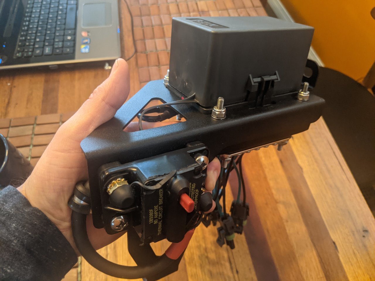

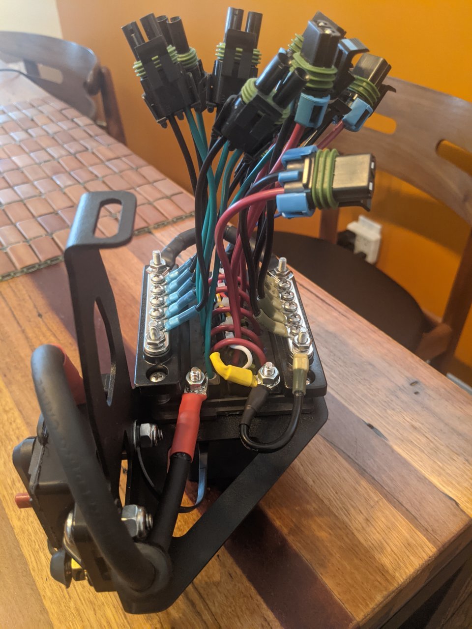

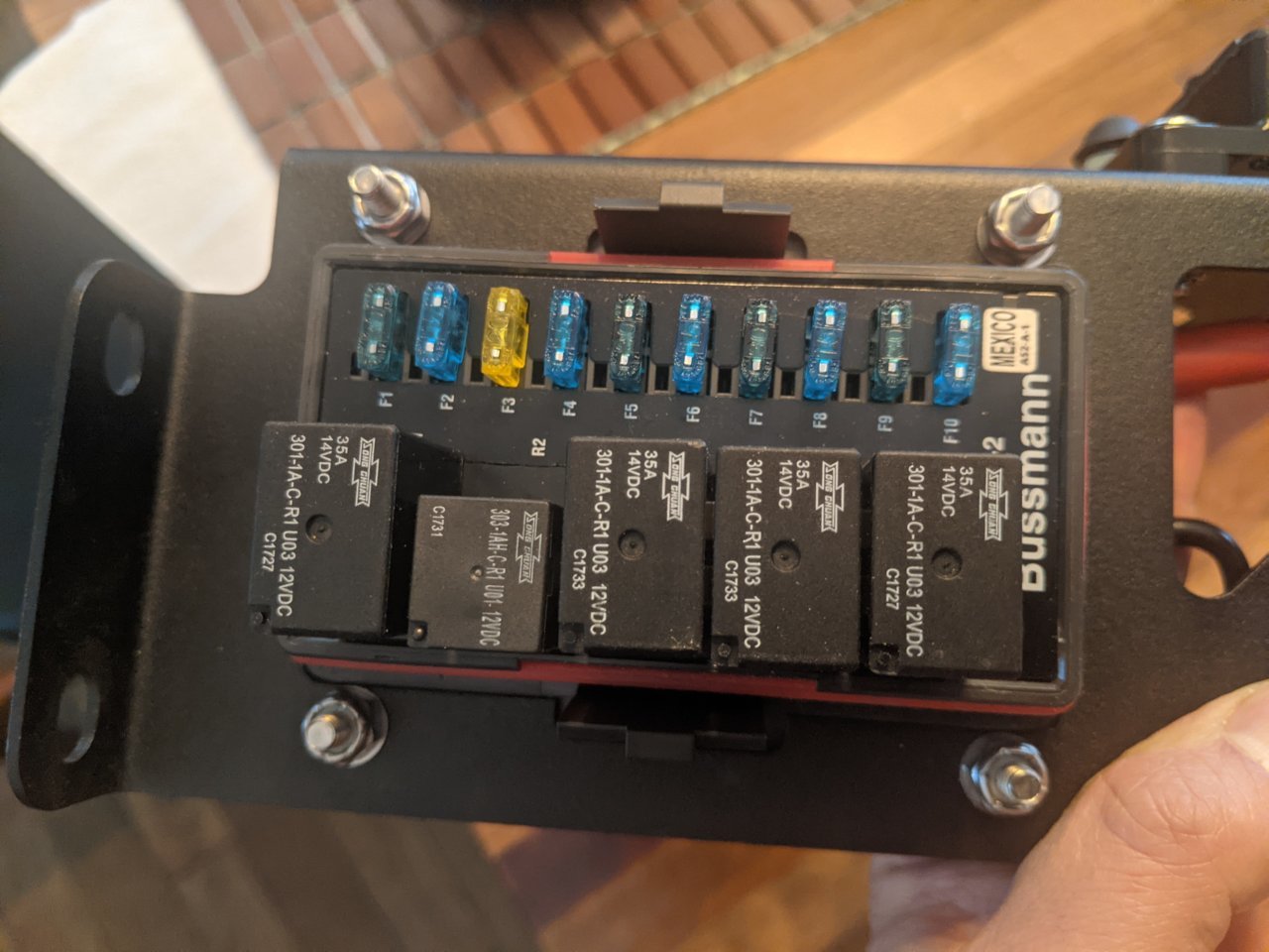

    In other news I've had a Bussman RTMR that I bought off someone who built it but never used it so I scored it cheap. Bought a bracket for a 4runner, some ground buss bars and a breaker and put some of it together and completed the grounding. Will have to make a bracket to mount my bracket lol.
    Plan is to wire my coolant pump through this and maybe power some of my gauges to clean up the five or six fuse taps I have in the cab. It has both fuses and relays to work with.
    I'll eventually need some switches to wire in for the relays. Also want to wire a switch to disconnect the abs for full nanny disable.

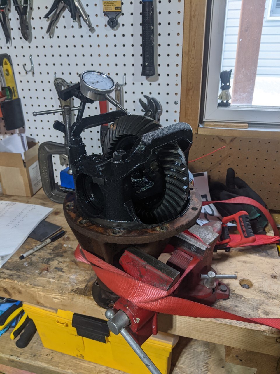

    And in other, other news I'm still researching about installing a true trac and am fairly confident I can do the gear backlash. Only real issue will be pressing new bearings in and possibly the bearing removal but I could take the parts to a shop for that.

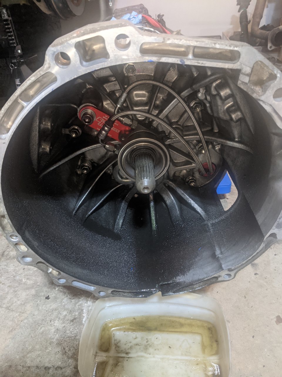

    And my clutch master hydro bearing has shit the bed. Most of the clutch fluid under truck with under 1900 miles. Have to try to get it around the block and into my garage.
    Haven't tried to contact them and probably not gonna bother with the way they seem to handle things.
    Getting rid of that system. Shit reliability

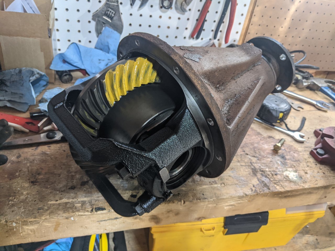

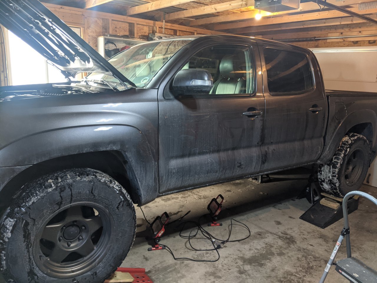

    Got the Eaton Truetrac installed.
    Crash course for what was involved for those interested.
    Took the old diff out and measured backlash on the old carrier and checked pinion backlash (didn't replace that bearing as it's more involved). Disassembled everything. Swapped the ring gear and installed new carrier bearings (freeze truetrac and heat up the bearings and they slip right on). Checked backlash and everything stayed very close to prior tolerances. Gear marking compound showed good contact meshing. Pinion stayed the same. Fill with non synthetic gear oil as Truetrac's work better with it.
    This guy installed a Detroit locker but was a good video for how to do most of the work.
    https://www.youtube.com/watch?v=gIKJxAnRho4
    Big puddle of brake fluid in tha' house. Thanks Clutchmasters

    Had to use a crowbar to remove the spacer for the Clutchmaster bearing. Scratched the quill a little in the process but there was literally no way to get it off otherwise.
    PDM sleeve installed on the quill and am debating the possibilities of putting a remote grease port into the bearing.
