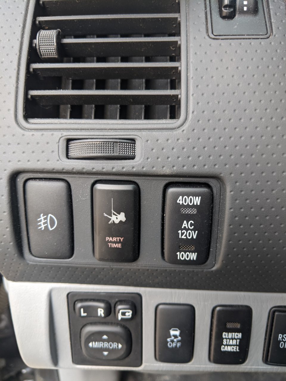

    Also installed a switch that provides power to nothing at the moment. The plan is to install a relay to interrupt the yaw sensor under the seat as a traction control killer I can leave always on or always off as needed.

    Disengages yaw sensor so you can rock like a party star lol

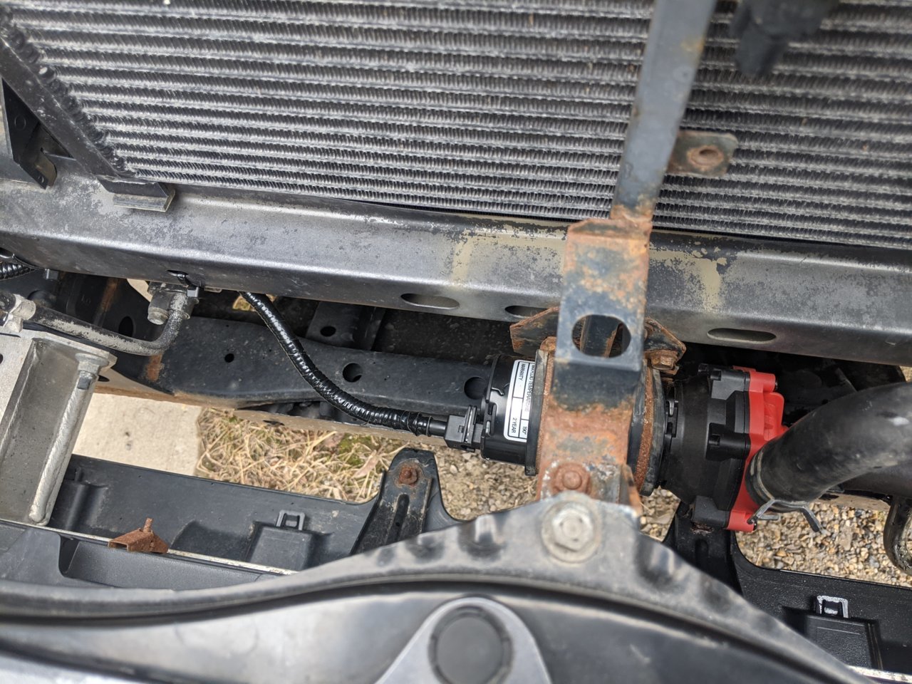

    ZZP high output intercooler pump.

    Did the electrical plug on your ZZP pump feel loose? Mine was not snug and it felt like the "nubbies" weren't tall enough for the clips to clip onto. I can tug the harness off as it never clips into place. I've notified ZZP and need to send them a video of said problem.

    I actually had a slightly upgraded Bosch pump and upgraded the upgraded pump with the ZZP.
    The second Bosch I installed came with a nicer connector that I had never used that fit perfectly in the ZZP so I wired that up to the plug going to the Bussman. I never even tried the stock plug and wiring with the ZZP.
    That's a bummer about the plug as it's definitely not something you want ever coming loose.
    Pretty sure this is the connector I received with the prior Bosch pump. Might be worth a try.
    https://www.frozenboost.com/liquid-air-adapter/wpt717-bosch-pump-harness-p-1023.html

    Thanks for the link to the plug! That may be useful since I'm not expecting ZZP to have a solution. In the meantime, I zipped a tie-wrap around the plug so it "squeezes" the clamps tight.

    Nice install. I saved the link to that connector, I'm considering getting two of these to replace my two stock pumps. Although since I must already be 80% more flow than stock it's not a priority.

    I wonder where the line for maximum flow rate is where it gets so fast that the coolant itself can't lose heat quick enough and saturates? It's most likely a much faster flow rate.

    Let me know if you have plans on creating and selling that Headlight Fluid fill cap. Laughed really hard and now I want one!

    It came free with my Clutchmasters Hydro bearing WHICH I DO NOT RECOMMEND.
    However, I believe they sell the caps on their own and they were customizable. Ask them and it's likely they can belt one out for you since they did mine. Send the pic of mine to them if you want the same design or they may have it on file.
    The cap is a nicely built billet piece.
