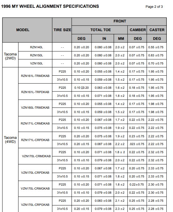

    96 tacoma 4x4 MT with 31x10.5R15 stock size tires and rims, no lift.
    Adjusted toe to get steering wheel perfect. Scribed a centerline on both front wheels treads while jacked up and free spinning tires. Lowered, moved a little back and forth. Exact same measurement to scribed lines front and back side of tires on level pad. So should be darn near 0 on toe. Can't find specs. Should this be good to go? Drives great, tracks great. Thanks for any advice.

    I think I am in need of the specs for this year model and stock set up. Reading up more now, already did a ton this past week and it's still escaping me. Thanks for the advice and link.

    Toe plates are da wey

    For your 96' and future reference - just find your frame code on the list.
