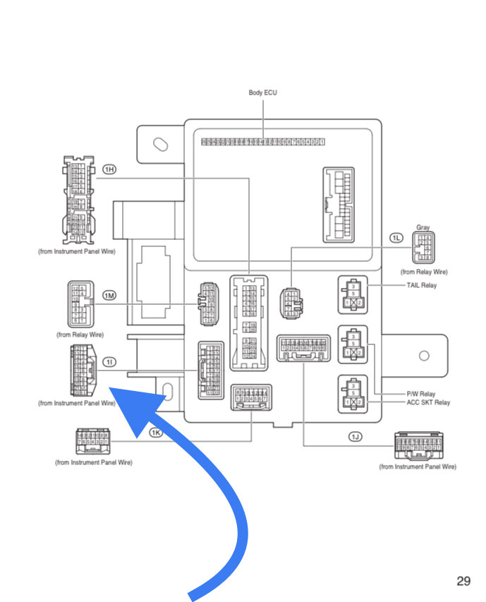

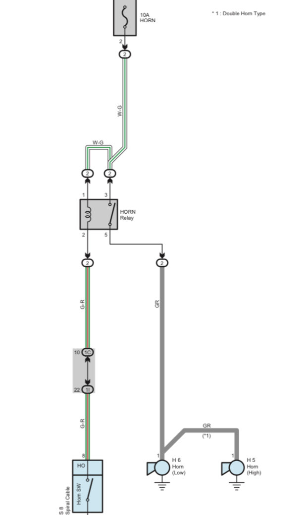

    IMG_3898.jpg IMG_3897.jpg In the cab on the left side of the steering wheel, there is a fuse box.
    The wire for the horn comes out of it and to the horn. The connection is on the BACKSIDE of the fuse box. Red and green wire. But you should be able to trace. It’s simply a ground wire. Pushing the horn grounds that wire.
    Trace the Red/Green wire from there up the horn. Cut and splice in a toggle.

    Easy to test, get you a test light connected to ground, go to Connector S8 (12 pin connector) at the back of the clockspring, backprobe Pin 8 (Green/Red) with a needle or paperclip, touch that with your test light, and see if the horn honks. If it does then your problem is in the clockspring, if it doesn't then your problem is between the clockspring and horn relay.

    It's such a simple circuit, I'd put some time into troubleshooting before I started adding wires and switches. You can go to the relay and do pretty much all the testing you'll need to do.
    Use the schematic Tn posted, you'll need 12 volts from the fuse, continuity through the horn switch when pressed and you can jump power to the out-put wire that goes down to the horns. See what the missing ingredient is. All you need is a DMM
    Have you tried swapping relays?

    Clocksprings are common to fail. But since you mentioned you've replaced the fuse a few times that makes me think a power wire is shorting to something.. like a bad relay or horn. When a clockspring fails it usually just goes open circuit. That's different from a hot wire touching something it shouldn't and blowing a fuse..
